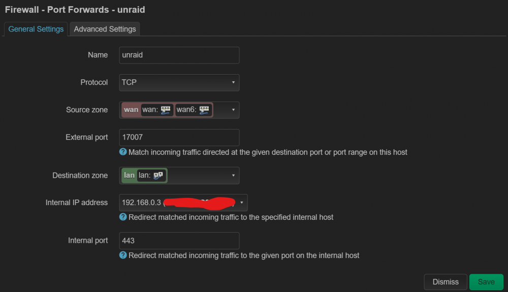

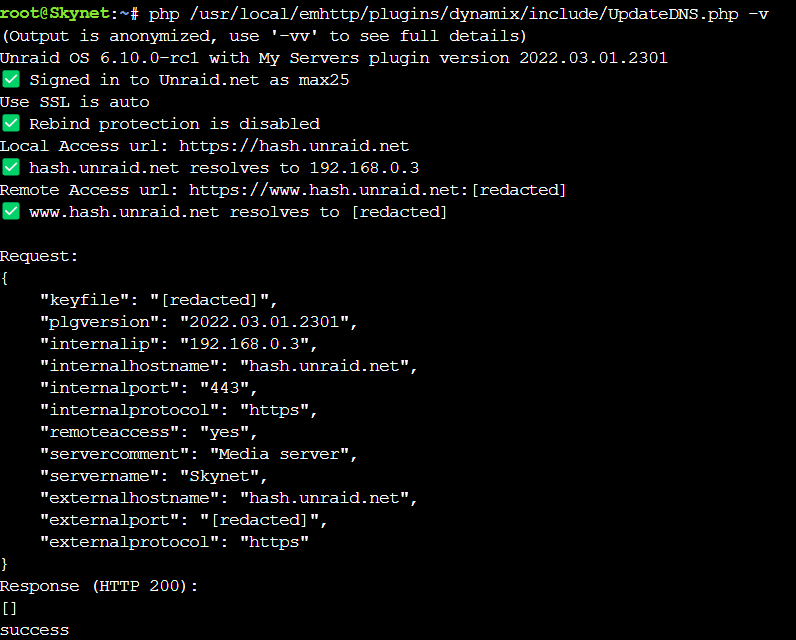

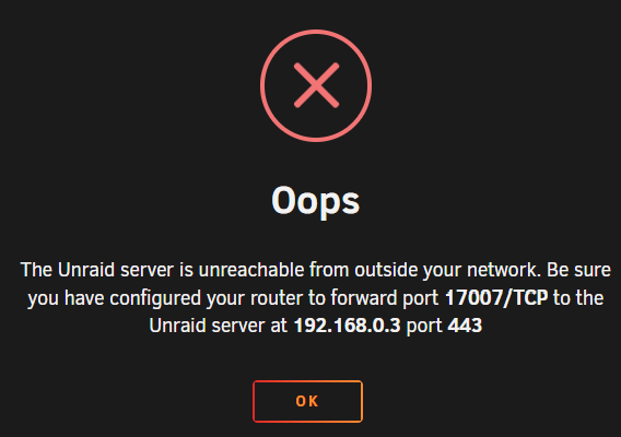

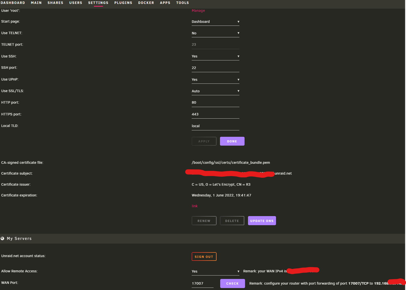

Remote access not working, help please: ERR_CONNECTION_REFUSED
hello, maybe I do something wrong, I have no Idea why it's not working
and "Allow Remote Access:" turning off by itself after a couple off minutes, even if it's ON, the remote conection isn't working.
Thanks!

My only suggestion for the Port Forward would be to get rid of IPV6 items since our DDNS currently only supports IPV4. Doesn't seem like that would cause an issue, but wouldn't hurt to try it.

I found that my router on Open-WRT or my ISP (they said it's allowed) won't let me open any port forwarding, so I'm stuck

Remote Access will be disabled if you sign out, and there is a warning shown when you do this. It can also be disabled during a plugin update if the update detects issues, but that should be rare. There shouldn't be anything that causes it to "turn off by itself after a couple of minutes", so if you are able to reproduce that please let me know how :)
I would agree that either your ISP or your router is the issue. The screenshots and the output from UpdateDNS.php show that the system is configured and we can see that DDNS is working properly too. If there are issues at this point it is usually a problem with the port forward, or people realize they have a second router in the mix that they forgot about.
