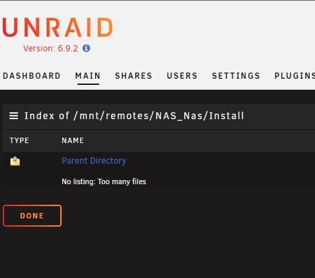

after that content of folder is not listed in web gui
        "Index of /mnt/remotes/NAS_Nas/Firma
         Parent Directory
         No listing: Too many files"
and this is not a xfs coruption becouse on synology i don't use xfs file system.
i can unmount and remount share and i can list folder again but running rsync repeats problem.

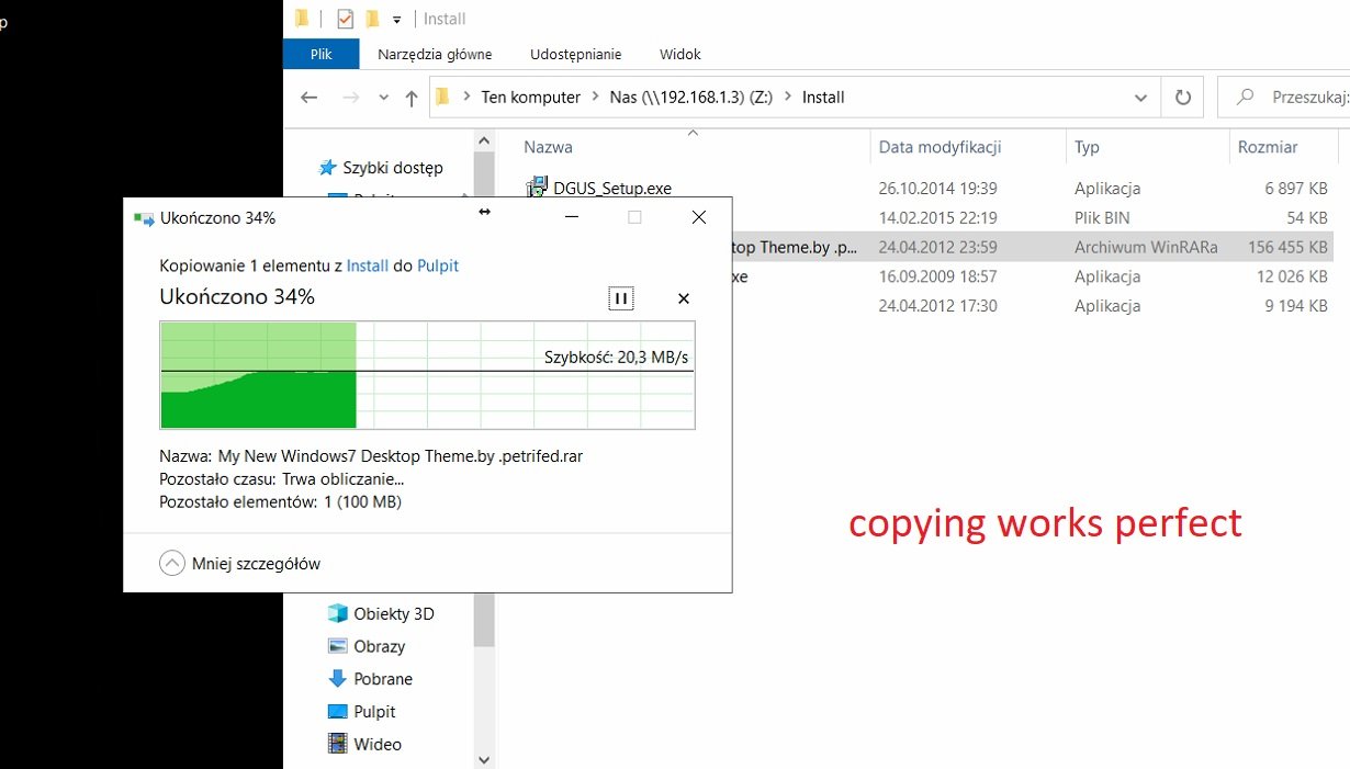

To be absolutly sure if it is filesystem problem i used windows file explorer to copy files form Nas to unraid and all went well. NO SINGE ERROR.

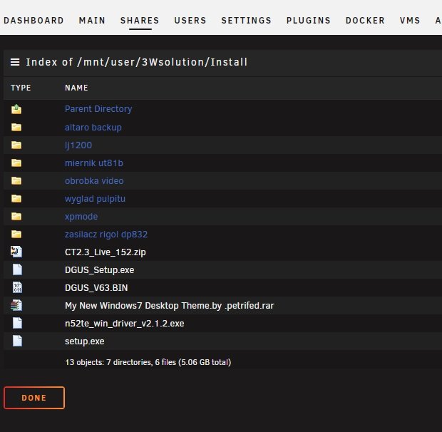

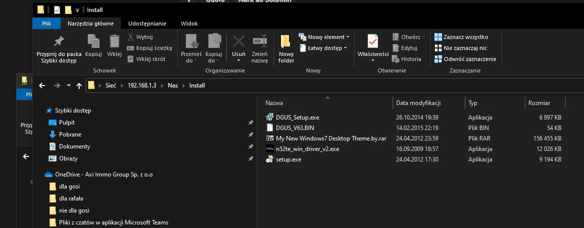

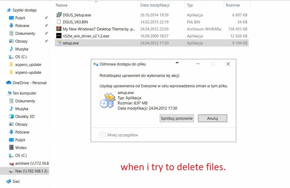

as you can see only fiew files in install folder. ho hidden files, no fancy caracters exept "_" or "." no national (polish) caracters also.
also i would like to remind you that this foder is not showing in unraid GUI After running rsync. but ofcouse i can read this folder in windows explorer as you can see above. also i can read this folder when i copy it by windows to unraid (there is some more files/dirs becouse i copied to unraid some files from other sources).

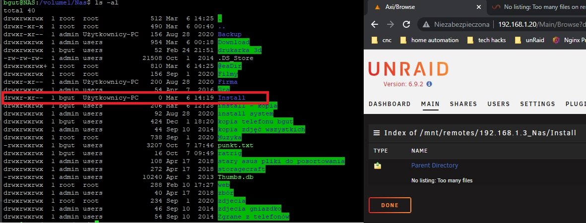

I found the problem.
i use account name:group  unraid:users for mounting NAS.

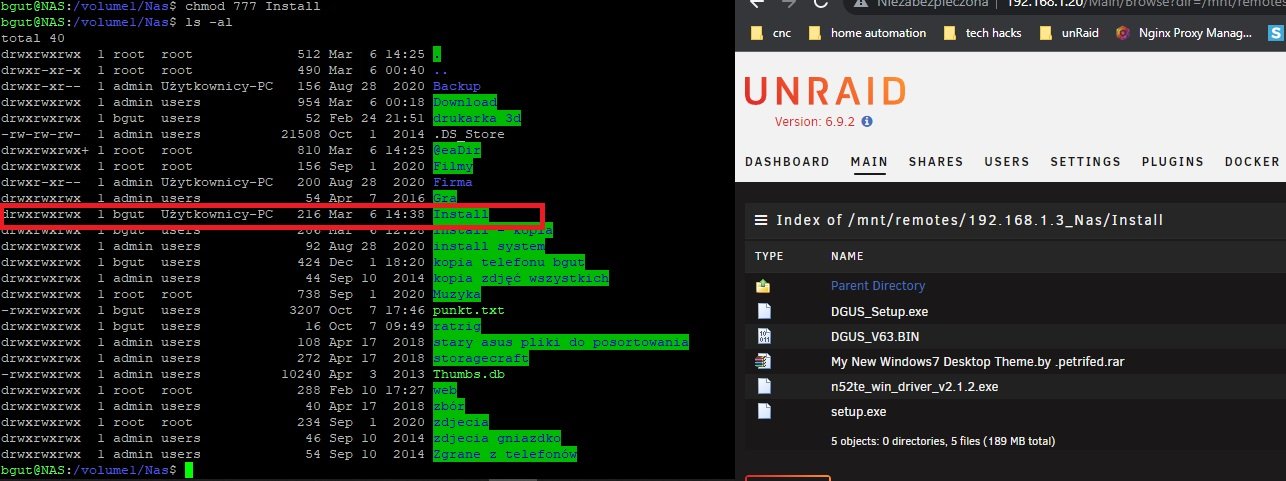

Folder install has chmod 754 so user unraid have only read privilige as i wanted.
and this blocks mounting. when i change to chmod 777 install everything works perfect.
can you tell me whe unraid needs write, execute privilige to properly show folder?

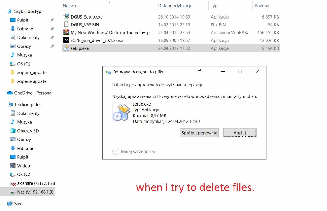

from picture above i checked and have problems with folder Firma and Backup in unraid gui becouse of privilige too.
but  when i mounted it in windows from account unrad. i can read it but not chage/delete. but i can read and copy to other locations.

problem solved i changed privilige to 777 for all of folders. we can close this topic.
