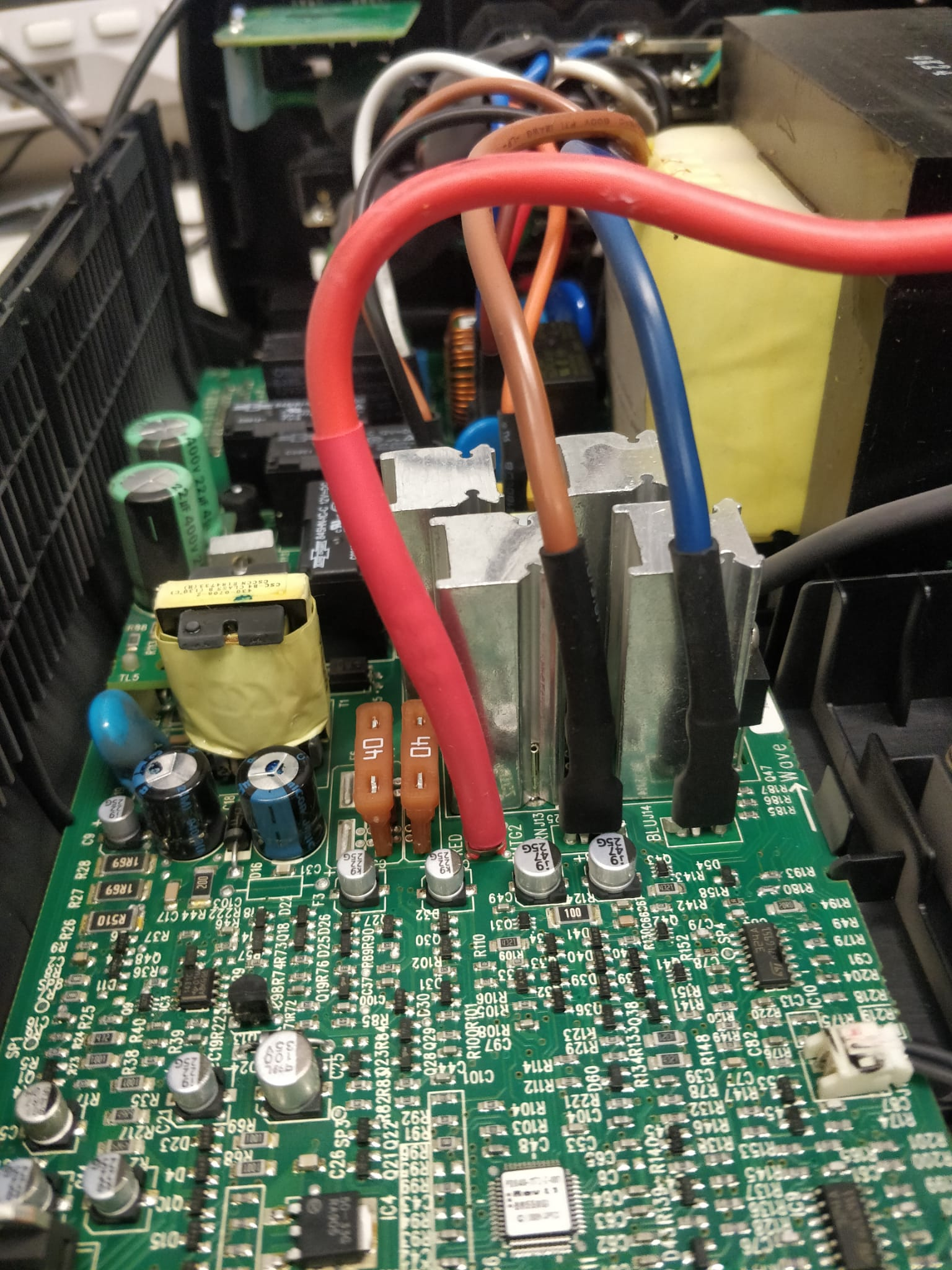

  •  opened the unit and saw no swelling in capacitors

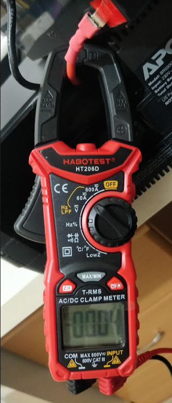

Problem likely hardware fault that UPS always in battery mode ( or in battery capacity calibrate ? ), you should use amp clamp meter to check battery in charging or discharging.
Suggest power-off UPS from AC mains and disconnect battery and try again.
Amp clamp meter on battery leads?
I disconnected mains and battery more than once, also did logic reset procedure (press power on a few seconds when all is disconnected) and it did not help.
UPS does not seem to be stuck in battery mode because when I do self test I can here the clicking of the relays from mains to battery and back.
Yes, Battery RED (+) or Black (-) wire, you may got 9+ amp reading even no AC load during discharging.

OK, so I did some measurements and here they are (battery at >95% when started test):

If no load during discharge, my measurements ( from my memory ) won't such that low. I notice you use 60A bar to take measurement it could make larage difference result.

After following the help provided here I was able to get the UPS working again. YEY !!!
Now I get good numbers:
  1. Mains disconnected and UPS off - PowerChute "Disconnected" 0.009A 12.72v
  2. Mains connected and UPS off - PowerChute "Charging" Negative 0.7A 12v+ and rising
  3. Mains connected and UPS on - PowerChute "Charging" Negative 0.55A 12v+ and rising - no decrease in % over time as before 🙂
  4. Mains disconnected and UPS on - PowerChute "Discharging" -6.6A 11.98v (60W lamp) - battery slowly discharges as expected
  5. Connected mains back resutls are same as in (3) above.
Well done!  So, you had some tired capacitors?  It does happen, and probably more frequently with budget models.  Capacitors age from time, current and especially from operating at elevated temperature.
I wouldn't have thought that a change of 10% in capacitance (330uF --> 300uF) would have such an impact on the UPS operation.
But it seems it does...😕
