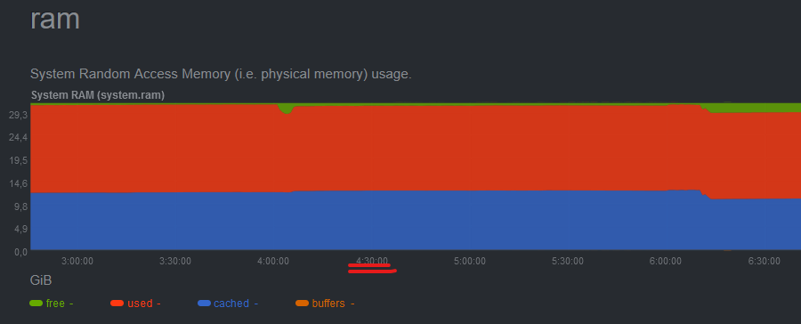

Out fo memory errors with 32 GB RAM
I  am getting this errors every 10-15 days or so

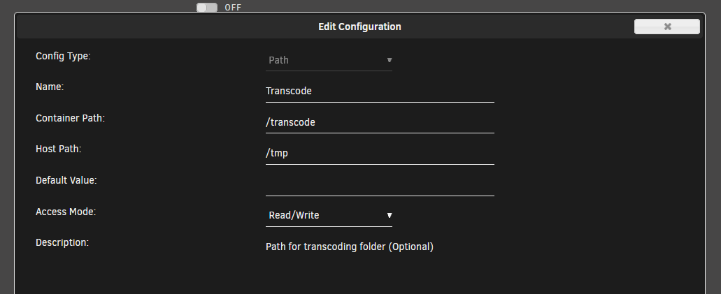

It might be that I have plex transcode on RAM bust last time plex was used, was like 10 hours before that out of memory error happened.

Additionally, you do NOT want to use a host path of /tmp for Plex's transcoding  Use /tmp/Plex instead  Without the subfolder, Plex *may* wind up deleting files at any given point in /tmp which will adversely affect the OS

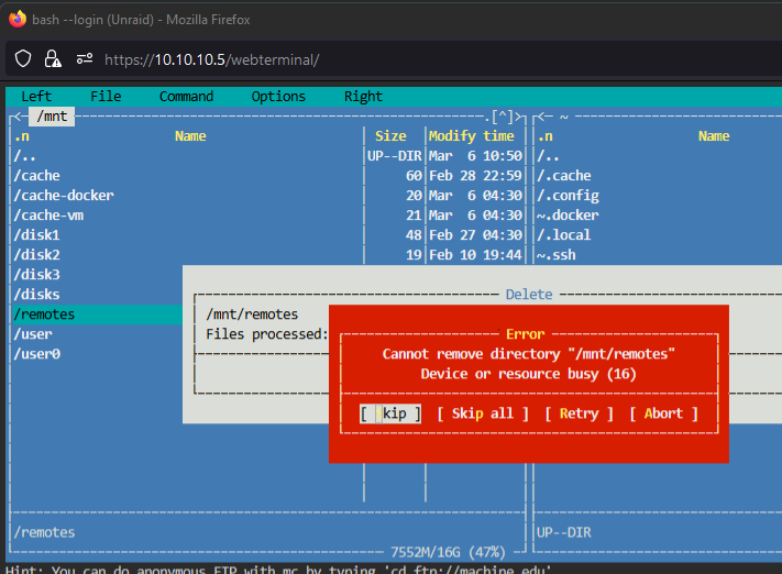

I have re run fix common problems and still appears, I think is because this "Remote" folder that I think I created when I had rclone. But now I can't delete it.
No.  The message from FCP says invalid folder "cache" within /mnt
In your screenshot it shows "cache".  You do not have a pool named "cache", so something is creating it.  Look first at any docker apps (hit show more settings) for something that has a path mapping directly referencing /mnt/cache  Fix that and reboot and then see what FCP says again
