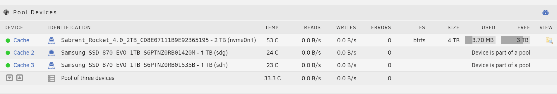

March 8, 20224 yr Author 13 minutes ago, JonathanM said: From the manual linked at the bottom right of the webGUI https://wiki.unraid.net/Manual/Storage_Management#Change_Pool_RAID_Levels So I erased all three drives using the Terminal, deleted from the pool, put them back in the pool. It still said that only 1TB was available. I did the Raid0 switch and it says that only 3 TB are free. Here are the diagnostics again. tower-diagnostics-20220307-1815.zip
March 8, 20224 yr Author 3 minutes ago, JonathanM said: Did the rebalance finish that quickly? I guess so? It says that it is now 4TB.
March 8, 20224 yr Odd numbers of cache devices don't always report free space correctly. I believe it looks to be correct in the diagnostics, @JorgeB will know for sure. Try copying a couple TB to it and see what the btrfs stats say on the cache page.

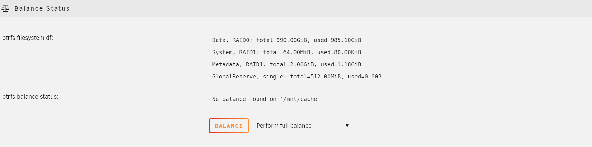

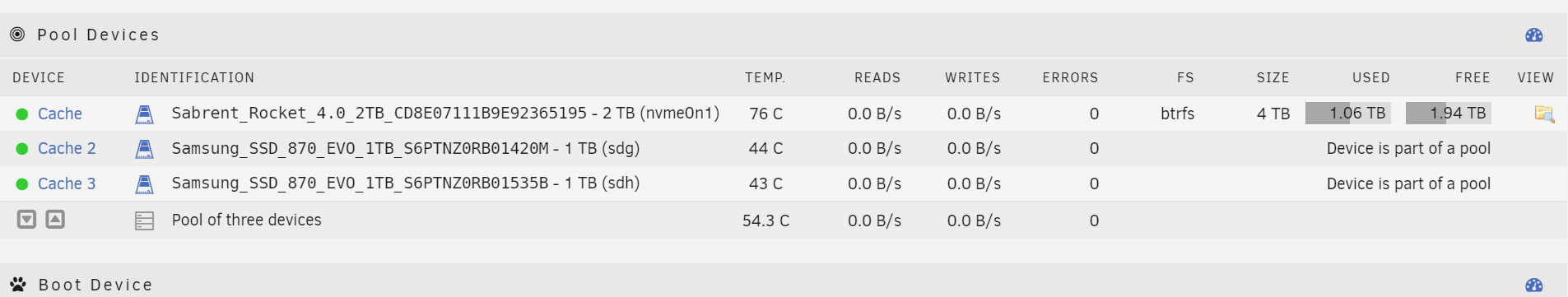

March 8, 20224 yr Author 44 minutes ago, JonathanM said: Try copying a couple TB to it and see what the btrfs stats say on the cache page. So I transferred over a terabyte. on the main page it says that 1.06TB is used with 1.94TB free and on the btrs section it says the total is 990 gig. So maybe its being reported wrong?
March 8, 20224 yr Community Expert It's normal for the stats not to be correct with that config, raid0 with different size and odd number of devices, you can change to single profile, they will be correct for that.
