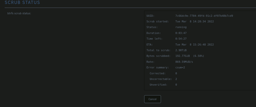

So i startet a scrub and checked the box to correct errors when possible. The output in the logs is this:
Mar 8 14:29:12 Tower kernel: BTRFS error (device sdi1): bdev /dev/sdi1 errs: wr 0, rd 0, flush 0, corrupt 1, gen 0
Mar 8 14:29:13 Tower kernel: BTRFS error (device sdi1): unable to fixup (regular) error at logical 35017768960 on dev /dev/sdh1
Mar 8 14:29:13 Tower kernel: BTRFS error (device sdi1): unable to fixup (regular) error at logical 35017768960 on dev /dev/sdi1
So, since I have a cache pool of two identical devices, why do I have a uncorrectable error? Is there any way to solve this?
