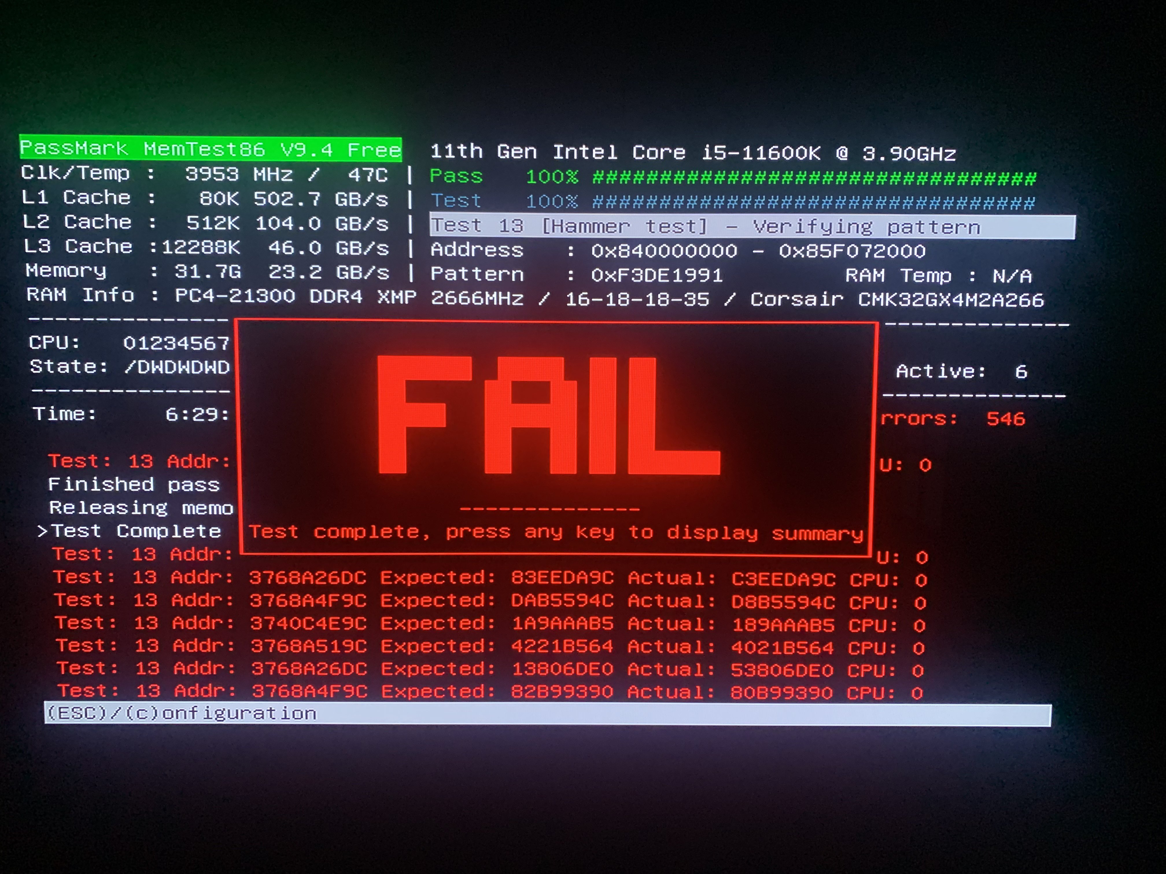

Lots of data corruption being detected on both pools, start by running memtest.
Thanks for this!
I ran memtest and it looks as though I have issue's 😂
Would it be a simple case of replacing the RAM and restarting my array?
That would be the first step.
You will still have to address the corruption that already occurred.
After you fix the RAM issue run a scrub on the pools, any corrupt files will be listed in the syslog, delete those or replace them from backups.
Hi guys,
New RAM fitted and everything is fully functioning again. Thanks for the help!
