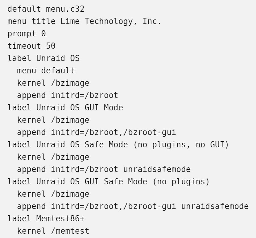

vfio_iommu_type1_attach_group: No interrupt remapping support.  Use the module param "allow_unsafe_interrupts" to enable VFIO IOMMU support on this platform
So I would try to add to syslinux config:
vfio_iommu_type1.allow_unsafe_interrupts=1
For unraid without gui it becomes:
append vfio_iommu_type1.allow_unsafe_interrupts=1 initrd=/bzroot
It is also recommended to attach to vfio at boot iommu groups 14 and 15, gpu video and audio.

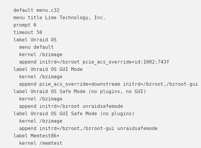

Can I ask you for help? I cannot put my graphic card in to one IOMMU group to be able pass through it to VM. VGA and sound controller are still in other groups. I tried setup in "PCIe ACS override" all options (downstream, both, multi-function) and graphic card is still in 2 groups, and I am not able to put it on VM.
899948618_Snmekobrazovky2022-05-29191935.thumb.png.d6dbdb2046fd422a3f520187d47d8411.png
I tried also code it in Syslinux Configuration as pcie_acs_override=id:1002:743f and no influence.
Do you have any idea?

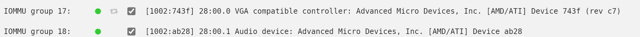

In your case (case: 2) simply bound to vfio iommu groups 17 and 18.
Do not use syslinux config. use only unraid panel.
I tried but still VM does not see graphic card. Could you take a look at my config?

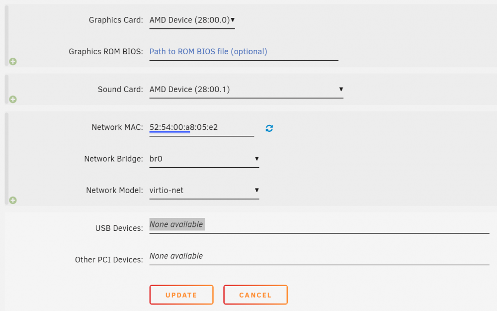

  • Adding Graphic and sound card
1645436421_Snmekobrazovky2022-05-30180223.thumb.png.8e0b62667f881367ee380c2f7e8cb062.png
  • Binding 2 groups
1431967225_Snmekobrazovky2022-05-30175934.thumb.png.f92af3482ff7ce87da79c42c6f28841e.png

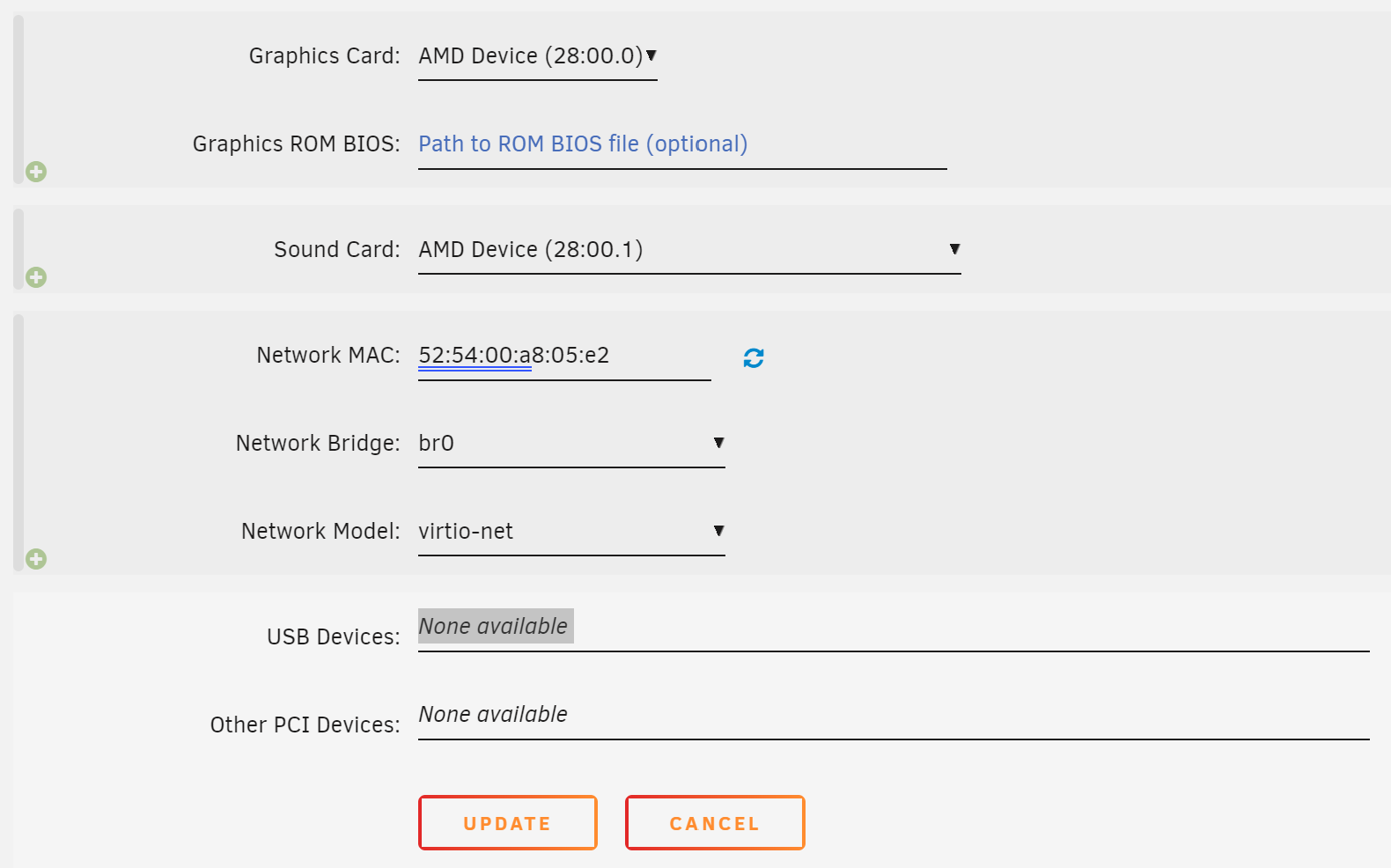

  • Setup
763892944_Snmekobrazovky2022-05-30175906.thumb.png.587de54f26ce4990b807e74c96f87323.png

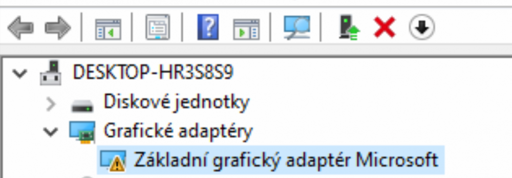

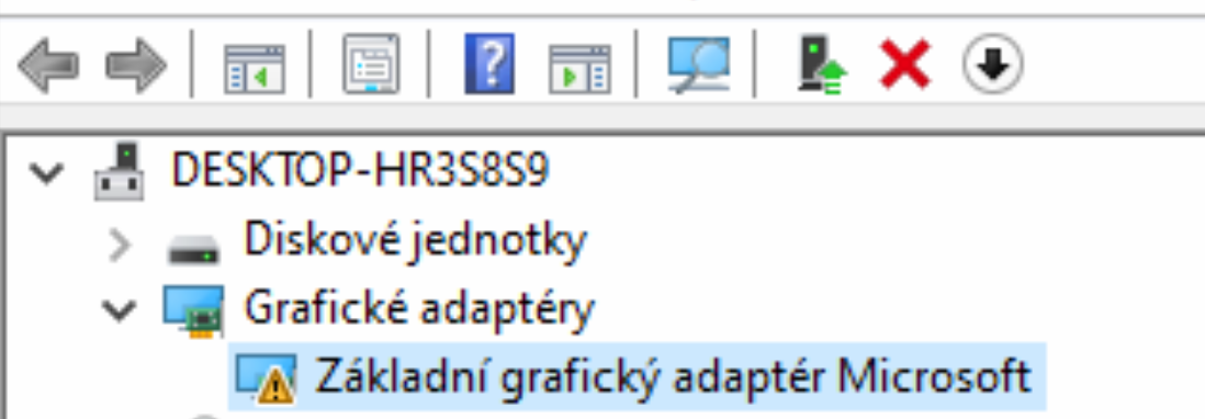

  • WIN 10 sees Basic Graphic adapter only
2105520663_Snmekobrazovky2022-05-30175742.thumb.png.e9514a301dbad3669e49694c29bd1745.png
Sure but you need to attach diagnostics, did you install the graphics driver inside the vm?
I am sending diagnostics.
Drivers are not installed because at VNC mode "no hardware found" so I cannot. When I switch to AMD at VM setup I cannot try to install AMD drivers because probably due to limited capacity of basic adapter I cannot run installer. The whole screen gets black every time.
Sorry to ask, but are you sure that this graphic adapter is the qxl/vnc one?
I'm asking for 2 reasons:
1. in your Windows 10 vm there is only the amd gpu defined, no qxl/vnc
2. when you define qxl/vnc virtual gpu it shouldn't appear with the yellow mark on it
Every passed through gpu without its drivers will appear as a basic graphic microsoft adapter because the microsoft driver is attached to it: this can work as a basic adapter or not (as in your case); if it doesn't work you should install the drivers of that gpu.
Double check the property of that graphic adapter and see what it is and why it's not running properly, what error outputs?
Gpu is isolated (OK) and in its iommu groups (OK), it seems not in use by the host (OK), if it's still doesn't work, change the settings in the xml to it becomes a multifunction device, from this:
      <driver name='vfio'/>
      <source>
        <address domain='0x0000' bus='0x28' slot='0x00' function='0x0'/>
      </source>
    </hostdev>
      <source>
        <address domain='0x0000' bus='0x28' slot='0x00' function='0x1'/>
      </source>
    </hostdev>
to this:
      <source>
      </source>
      <address type='pci' domain='0x0000' bus='0x00' slot='0x05' function='0x0' multifunction='on'/>
    </hostdev>
      <source>
      </source>
      <address type='pci' domain='0x0000' bus='0x00' slot='0x05' function='0x1'/>
    </hostdev>
You may need to pass also the vbios, dump it and pass the rom file too.
You may need to change (re-create) the machine type, from i440fx to pc-q35 for better passthrough compatibility.
Hi, I installed todays unraid update, implemented your code and now I could install GPU drivers 🙂 Thank you very much for your help.
