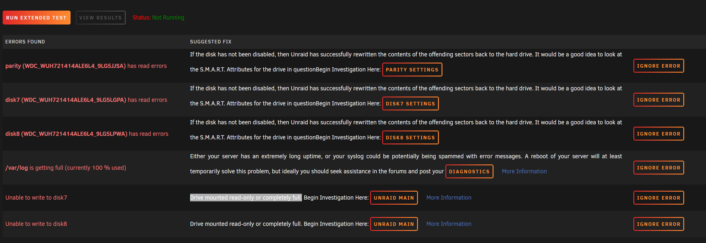

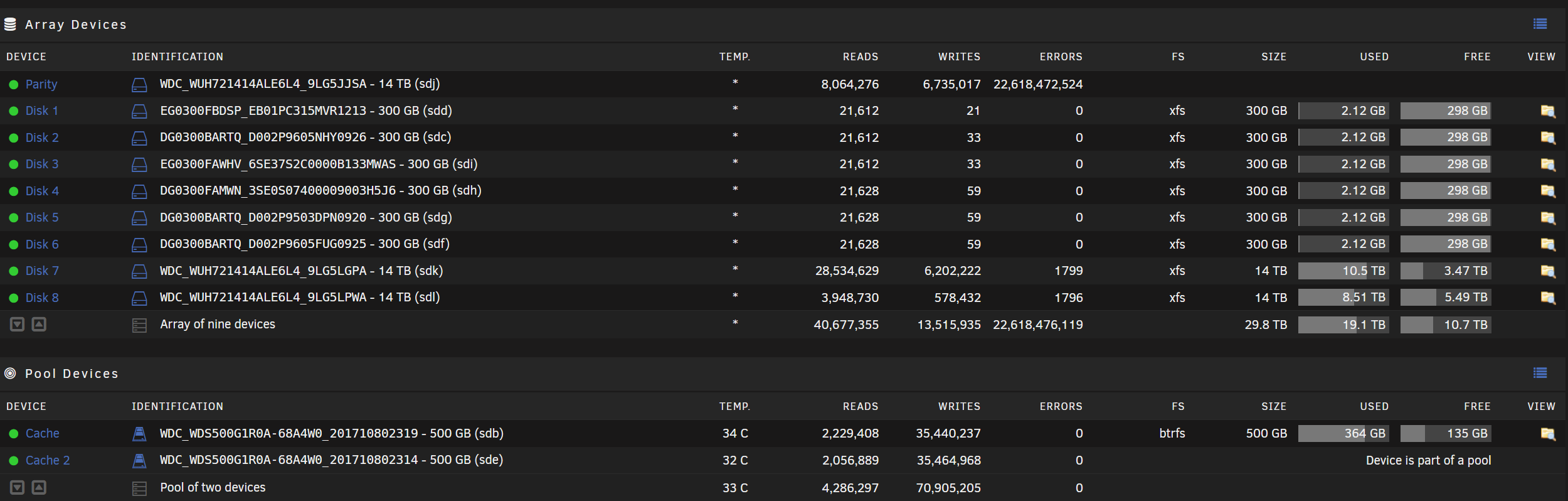

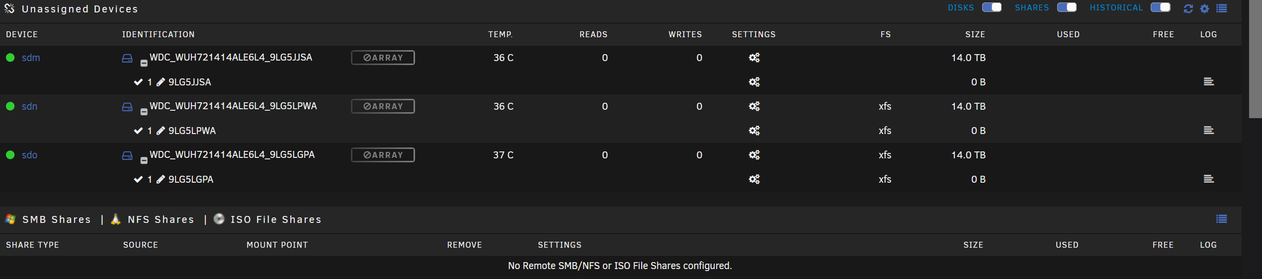

woke up this morning to 3 of my hdds on my array giving no access.  1 is a parity drive and the other 2 are where all my media is stored.  i can't see them in shared, but i can see them on the dashboard and the main tabs and healthy and 75% usage.  the 3 hdds show up under unassigned devices, but have a greyed out section saying array.
fix common problems gives me, "Drive mounted read-only or completely full." and none of my shares are showing to be able to access the data.
please help as i am new to unraid and i dont know what to do to ensure i dont lose data and can get my server back to normal.

Multiple disks dropped offline at the same time (then reconnected), this suggests a power/connection problem, see if they share anything in common, then reboot and post new diags after array start.
