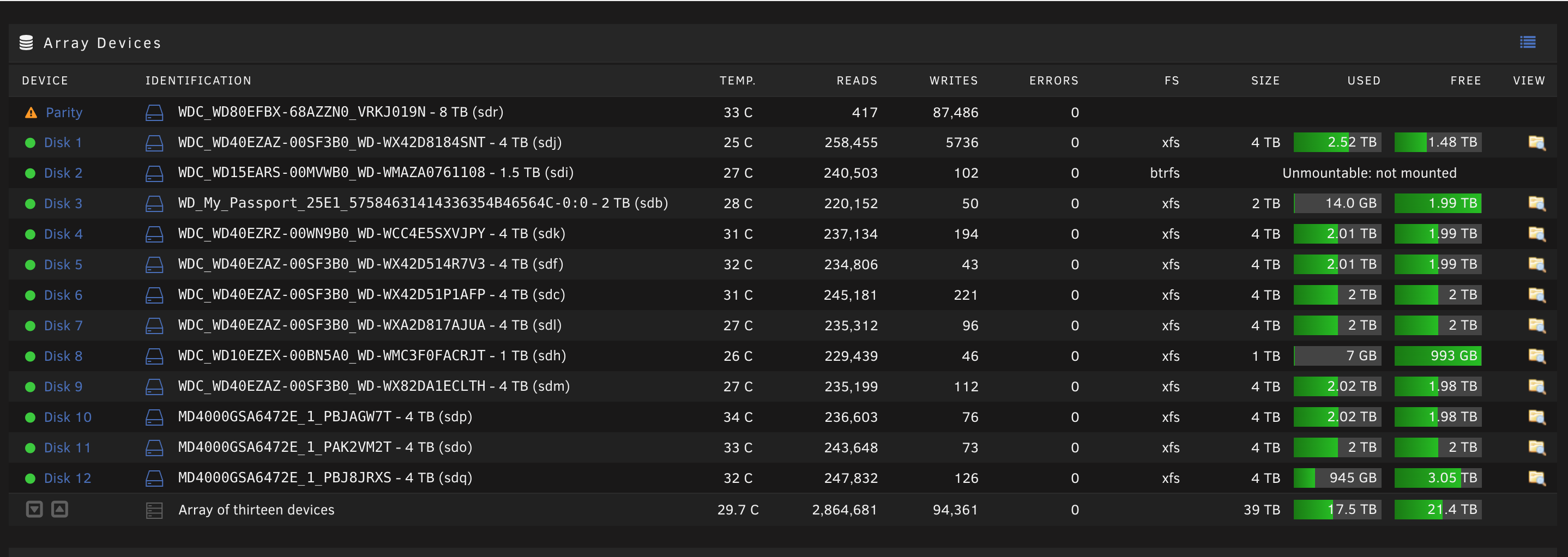

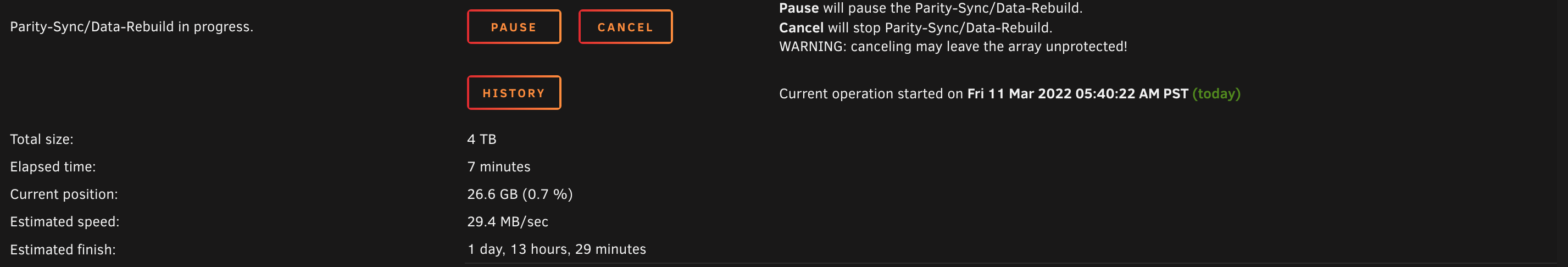

Swapping from a 4TB parity to 8TB when the parity sync begins it still only shows 4TB and the speed of the sync ranges from 10-35mb/s... very new to Unraid and Nas setup in general please be easy on me if this is a stupid issue LOL Please see screen shots and diagnostics report 464347800_ScreenShot2022-03-11at8_47_36AM.thumb.png.cdeae3d3f5886a3619284ca748f7c310.png

Why didn't you fix your unmountable disk 2 before making any other changes?
Also, is disk 3 external? USB NOT recommended for array or pools
Not sure what happened with Disk 2, it was fine then I rebooted and did not notice it until I uploaded this screenshot.  yes that is a USB drive It was when I was first playing with unraid just have never replaced it yet.
Edited by Thitt0927
Why does it say disk2 is btrfs when all of your other array disks are xfs? Is that even correct? Default for array disks is XFS so you would have had to intentionally change it if that disk really is supposed to be btrfs.

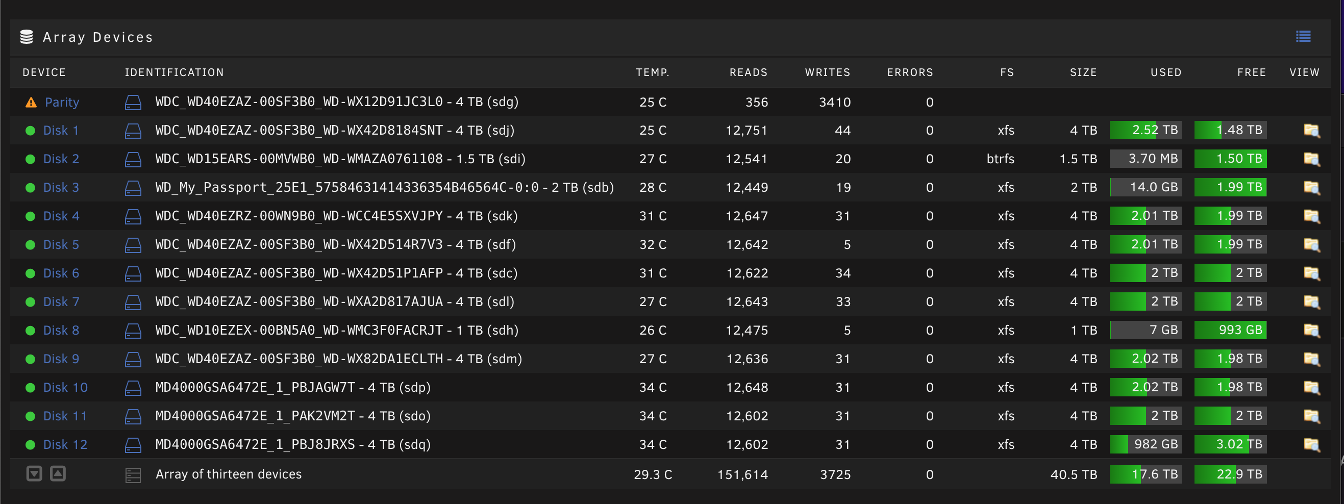

I have Disk 2 back online now.  as far as btrfs vs xfs not sure why.. I do not remember changing anything when setting up it.  once I get parity back I plan to remove disk 2 and disk 3..  I have a 4tb and 6tb on deck to replace them  Parity sync is still extremely slow and the size mismatch is still present... Thank you for your replies!  I appreciate any help!1015294551_ScreenShot2022-03-11at9_45_25AM.thumb.png.1beef6de934edd5b72515547a14f4862.png

You seem to have a lot of disks for someone just starting, and since some are small, I am guessing some are not new. Do any have SMART warnings on the Dashboard page?
I think I would just remove those small disks also. Each additional disk is an additional point of failure, and they aren't adding much.
Not sure about parity size, maybe it isn't upsized until rebuild is complete.
Your appdata and system shares are on the array. You want these all on one of your fast pools and set to stay there so your docker/VM performance won't be impacted by slower parity array and so your array disks can spin down since these shares always have open files.

nobody answered the initial question "why is Parity still using 4Tb only?" yet, so I try to add my explanation:
The Parity drive must be the largest in the array because it stores the addes sums of all sector data of the data disk. Initially it is fully wiped out with zeros, then the "parity regeneration" task will start and it will read every sector of the data disks, sum those up and store the result on the parity disk.
If a data disk is smaller than the current position, it is skipped for this reading.
At the end, all sectors of the parity drive that have a correspondinf sector of a data drive, will be used, the remaining sectors are untouched and still show zeros.
So if you largest data disk now is only 4 tb the parity drive also will only be used up to this point, 4Tb.
But the reason for this ("the parity drive needs to be the largest disk in the array") is that now you can add new disks or exchange old one with disks up to 8 Tb in size.
So, its like an investment into the future, it will then safe you a lot of time (no need to regenerate everything, just refill the new disk up to the size of the old one or just add a new empty drive instantly)

Thank you.. so if i am understanding this correctly since the original parity was 4tb that is what it is rebuilding onto the new 8tb drive and i should not worry that the sync shows 4tb

No, it's a duplicate of disk2, so after wiping it there might still be issues with parity because there's only one btrfs array disk, likely also the reason parity is only showing 4TB, post new diags after fixing sdl and rebooting.

Parity sync is as fast as the slowest disk. My guess is that your USB disk is making the parity sync extremely slow.
