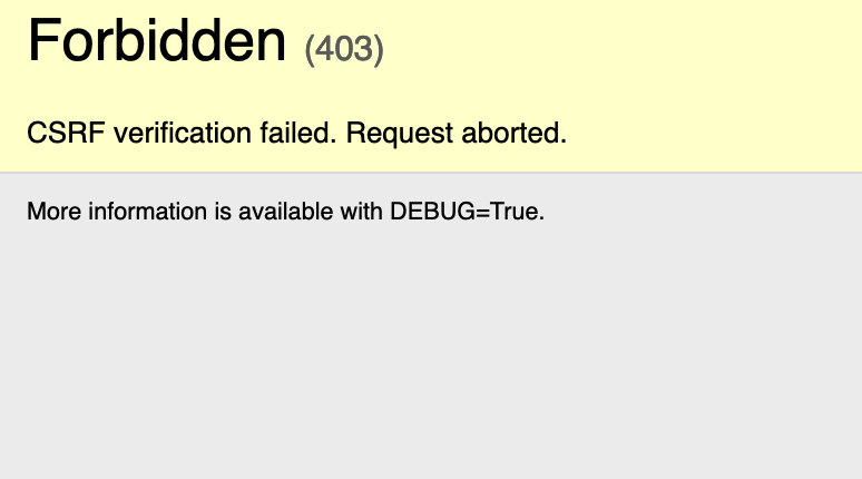

I am still having an issue with CSRF verification failed when I try to login from a swag reverse proxy instance.  Anyone able to point me in the direction...
You probably have to set the `PAPERLESS_CORS_ALLOWED_HOSTS` variable to the Hostname or IP of your swag container.

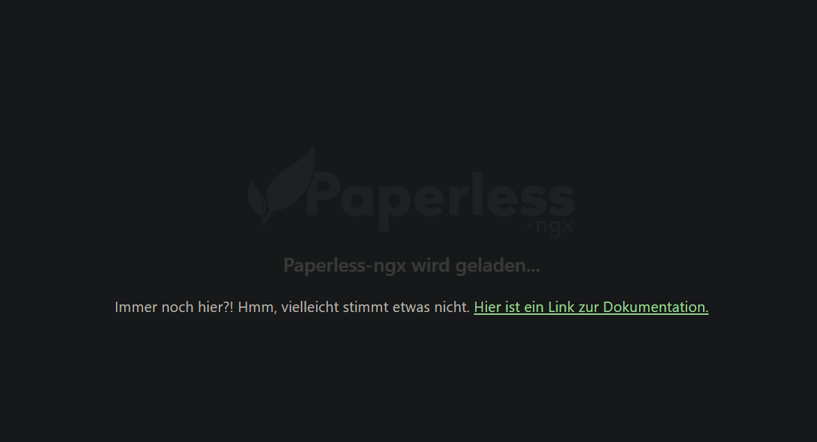

Hi!

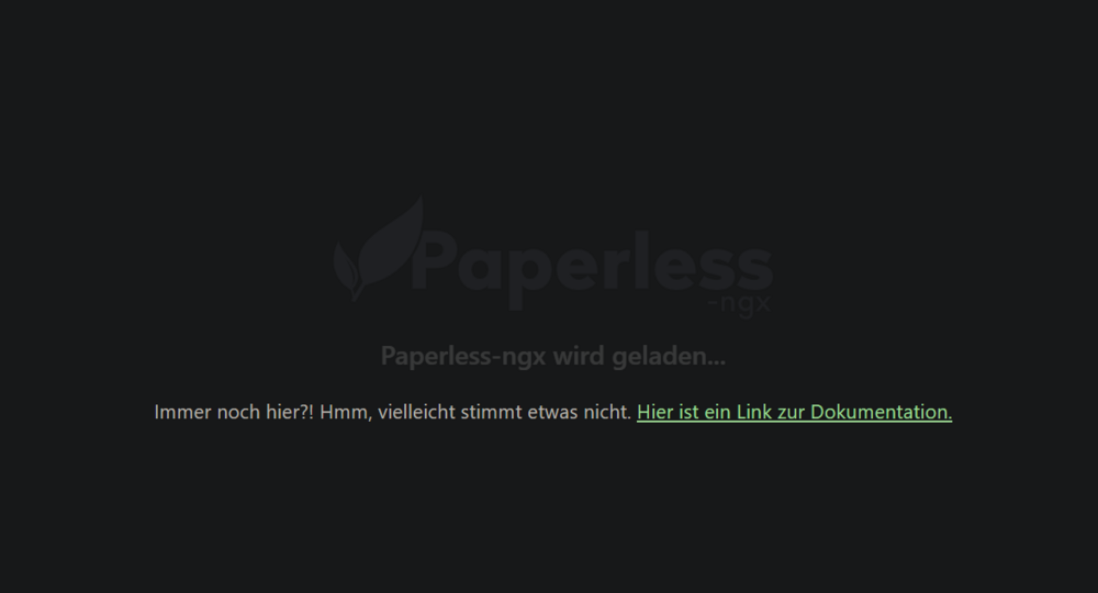

I'm having the problem that after a recent update paperless doesn't load anymore.
It worked perfectly fine just recently. I'm also able to login and use my Paperless Instance via an the iOS App "Swift Paperless" (Curently in Testflight).
But the webUI just doesn't open anymore. It just says:
I already tried restarting the container. No result.
Couldn't find anything in the (linked) documentation, too.
Can anyone help me?
thanks in advance!
EDIT: just tried and I can login with my admin account. It's just my personal account that is stuck on the loading page. I also tried clearing my browser cache and logging in in an incogito window.
EDIT2: It works again, after granting my personal user all rights via the admin user.
I didn't need to do this in the past. The rights I added were:
AppConfig
UISettings
History
MailAccount
MailRule
User
That doesn't seem to make any sense, to me. Ay ideas?
Edited by juleztb

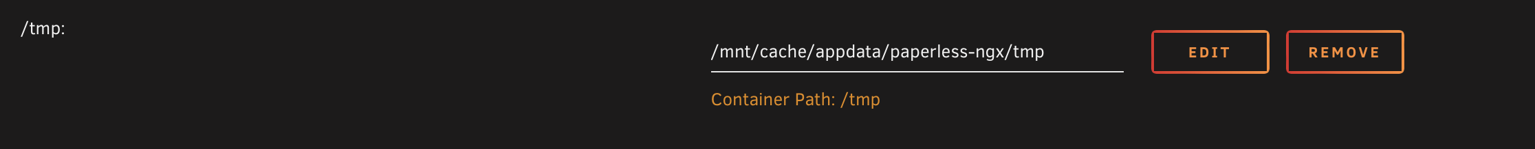

On 6/16/2024 at 6:28 PM, foo_fighter said:
@Joseph
Same problem. Probably /tmp in the docker is filling up.
Try mapping it to a directory outside of docker.img:
That will at least stop the docker.img from growing. You might need a cron job to clean it up regularly.
What kind of files fill up the space in the tmp directory? Are the troublesome files in /tmp/paperless or /tmp/paperless-scratch?
Can you check if setting PAPERLESS_CONVERT_TMPDIR also works for you? You have to add a bind mount with a physical disk pointing to the same directory too. Using this variable rather than the tmp directory has the benefit that we don't rely on internal knowledge of the application.
Based on this discussion:
Typically the OS is responsible cleaninging up /tmp on some sort of schedule or rules based.
I guess for Unraid we would need to schedule a dedicated clean up via the User Scripts plugin then. For example:
find <PAPERLESS_CONVERT_TMPDIR>/ -mtime +2 -type f -delete
I haven't experienced this problem before, because I restart my server on a regular basis. Once the container restarts its tmp directory including the troublesome files should be removed as well. I also do not have a frequent large import volume. However, I see the problem.
Waiting for your response. I will then add the variable to the template and further add a paragraph in the first post of this thread about the clean up job.
Looks like they are all OCR files(I have some large failed PDFs and it seem they don't get cleaned up automatically):
root@NAS:/mnt/cache/appdata/paperless-ngx# ls
consume/  data/  export/  media/  tmp/
root@NAS:/mnt/cache/appdata/paperless-ngx# du -sch tmp/
17G tmp/
17G total
root@NAS:/mnt/cache/appdata/paperless-ngx# ls tmp
ocrmypdf.io.0mn2z57f/  ocrmypdf.io.u9o_dd7p/  ocrmypdf.io.zr_nbhp6/  pymp-xzebn3yo/  tmpiajjt4r5/  tmpxvp1v0hq/
ocrmypdf.io.ncd31_t8/  ocrmypdf.io.uil7jtdj/  paperless/             tmp58r7tmpw/    tmpouumc1gz/
root@NAS:/mnt/cache/appdata/paperless-ngx# du -sch tmp/*
4.3G tmp/ocrmypdf.io.0mn2z57f
6.5G tmp/ocrmypdf.io.ncd31_t8
275K tmp/ocrmypdf.io.u9o_dd7p
275K tmp/ocrmypdf.io.uil7jtdj
5.7G tmp/ocrmypdf.io.zr_nbhp6
58M tmp/paperless
1.0K tmp/pymp-xzebn3yo
1.0K tmp/tmp58r7tmpw
1.0K tmp/tmpiajjt4r5
2.0K tmp/tmpouumc1gz
1.0K tmp/tmpxvp1v0hq
17G total
I don't have too much RAM so I'll probably not use /tmp.
For cleanup I plan on using a user.script:
#!/bin/bash
/usr/bin/find /mnt/cache/appdata/paperless-ngx/tmp -type f -atime +1 -exec rm -f {} \;
Edited by foo_fighter
@ALMattSrdid you find a solution for this? Same thing just started happening to me going through ngin-x. It seems to work fine in the Swift Paperless app, but logging in through the web browser gets the same Forbidden message. I tried adding the PAPERLESS_CORS_ALLOWED_HOSTS variable and setting it to the IP of the ngin-x container, but I get the same result.

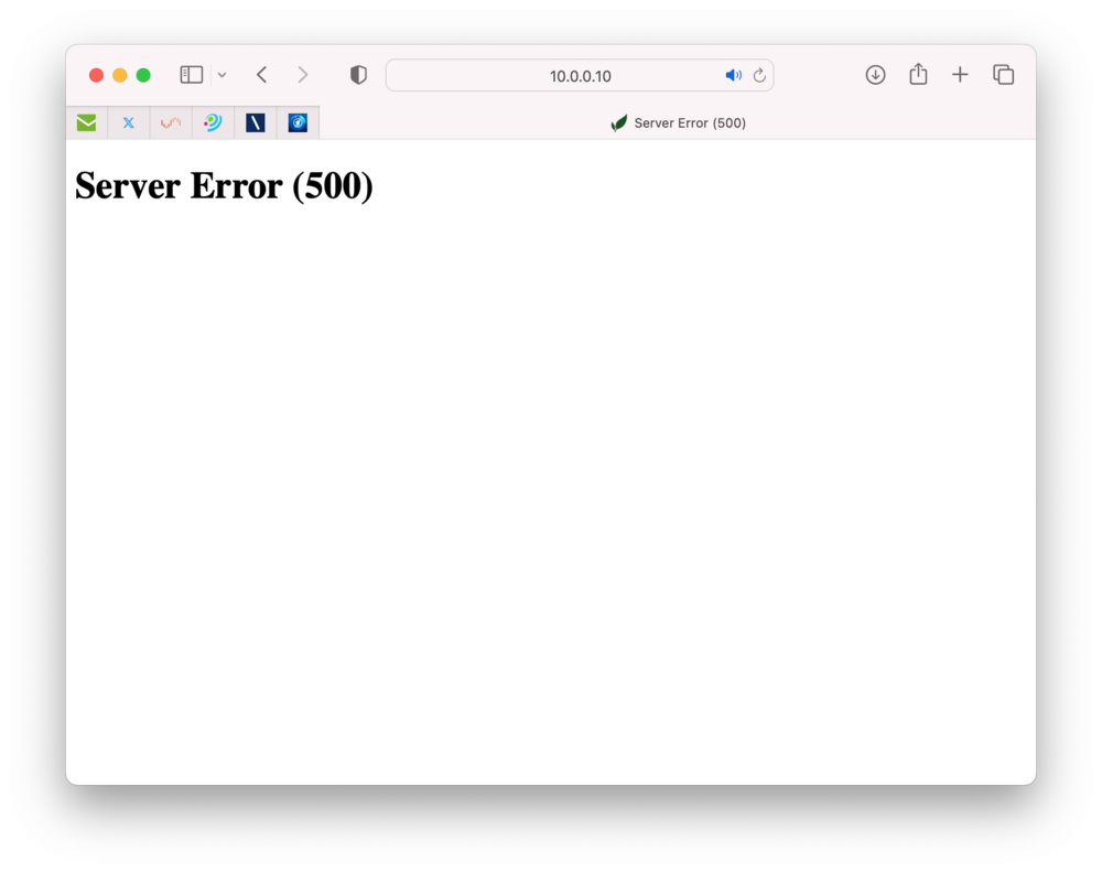

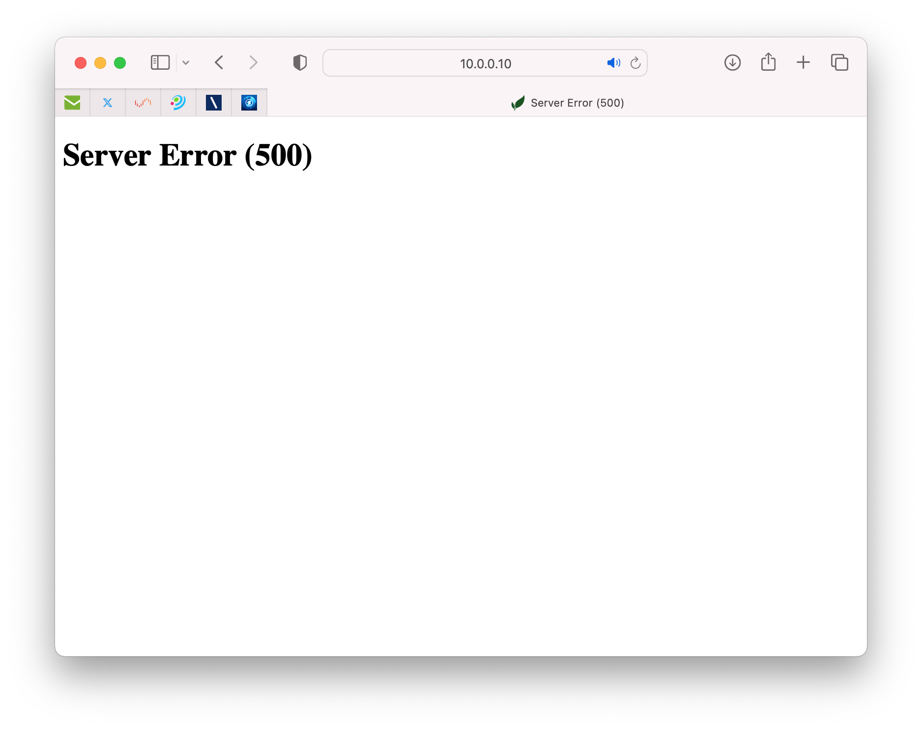

Server Error 500 after update
Hey folks, I'm still relatively new to the whole docker game and am struggling a bit since an update. I'm getting a "Server Error 500" when logging into paperless now which used to work perfectly fine before.

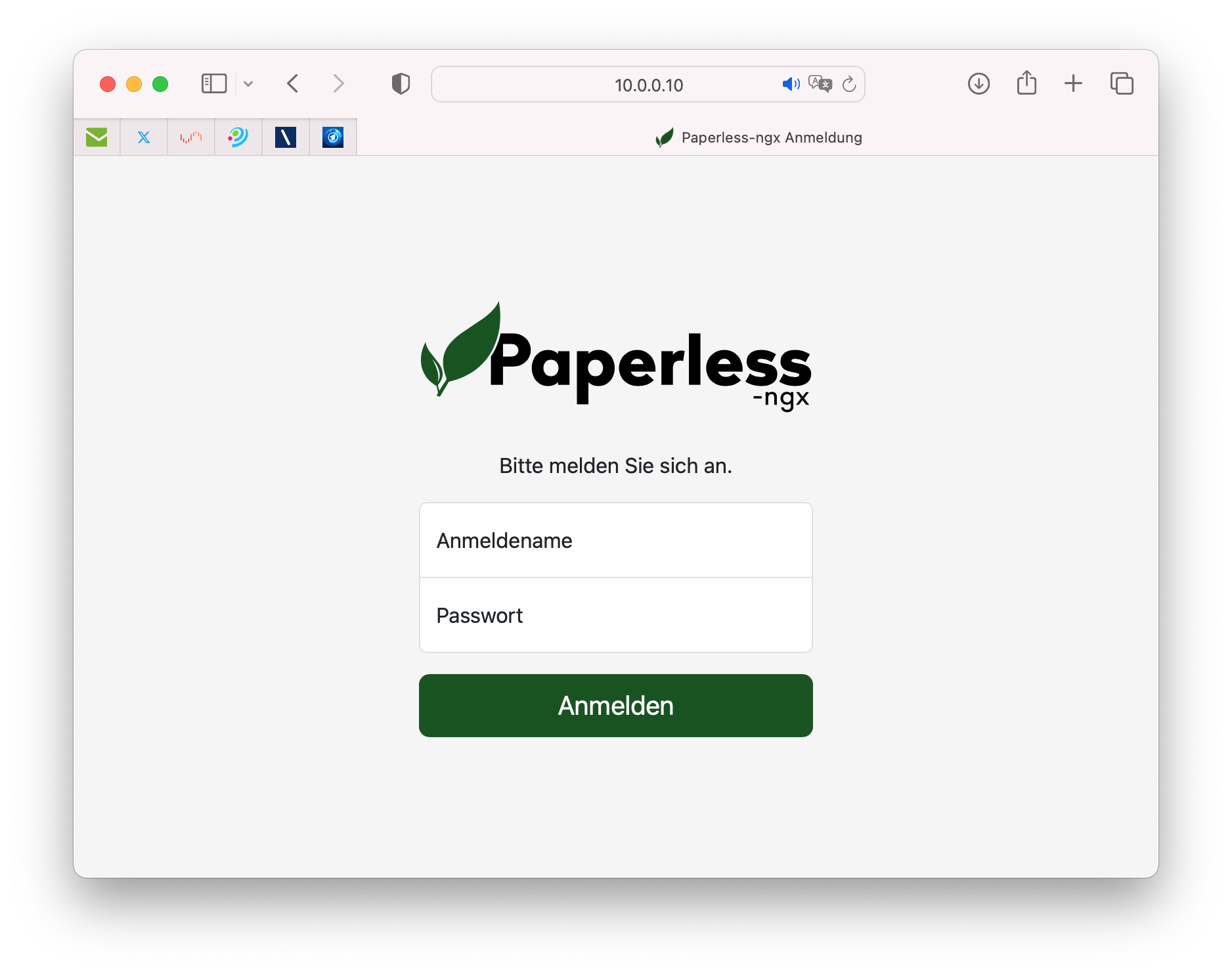

What happens:
  1. Open paperless login page (works perfectly) (Screenshot 1)
  2. login with username / password
  3. Get blank Server Error 500 Page (Screenshot 2)
Workaround:
  1. I noticed i can go to the /admin-URL, login to the django admin backend with my credentials just fine.
  2. From there I can click the "show website" link and open my paperless dashboard

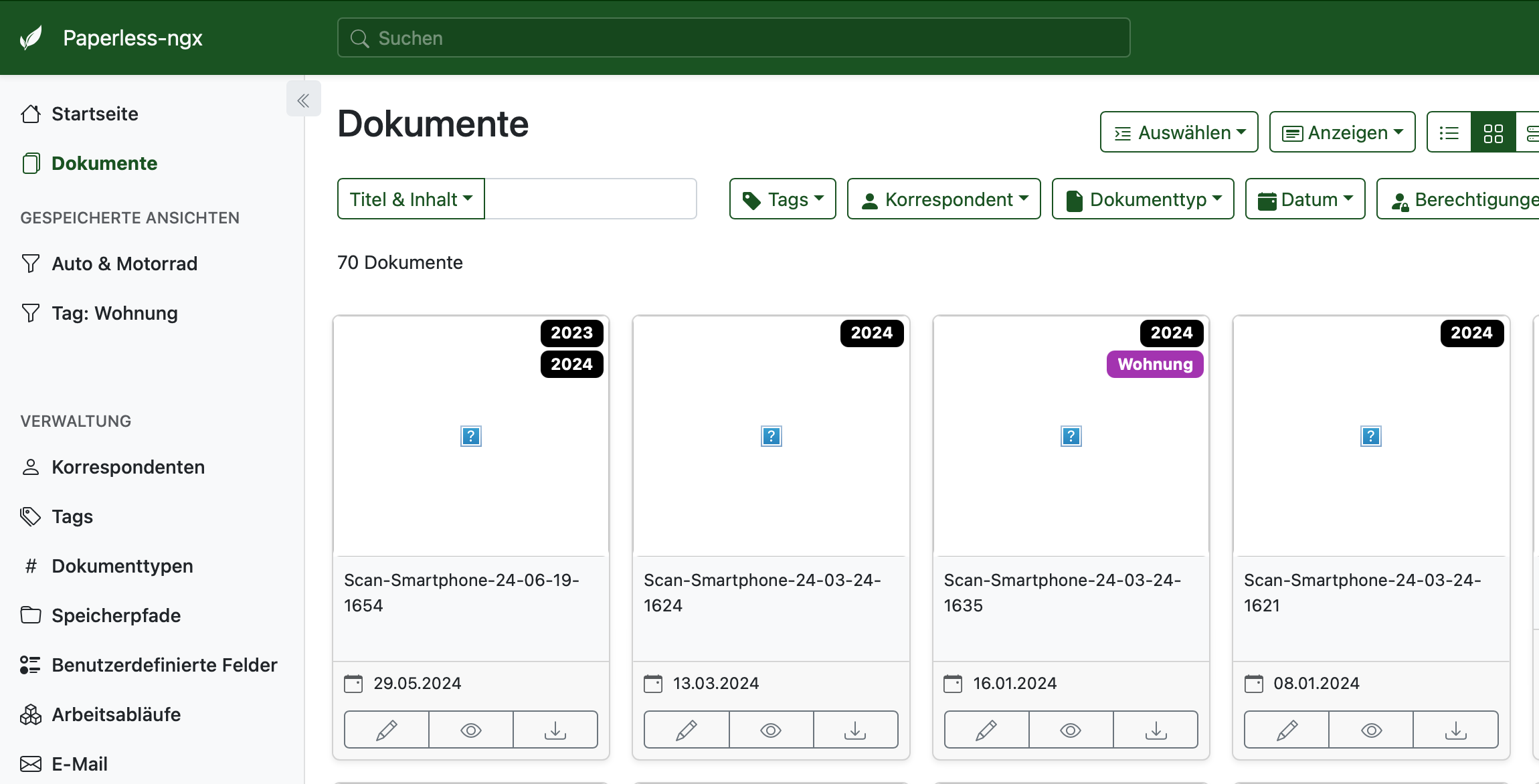

  3. However all thumbnails are missing

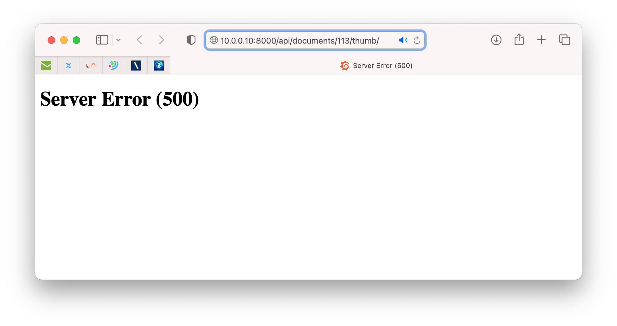

  4. If I open the web inspector and check the link to the thumbnail, all thumbnails also get an "Server Error 500"-Page.
What I tried:
  1. Restart containers (including Redis) , didn't work 😔
  2. Restart unraid server , didn't work 😔
  3. Delete and re-install container , didn't work 😔
Not sure what the logs suggest. To me it sounds like some python files have errors but I highly doubt that. But then again I might not know enough about logs n pythons n stuff 😂
Would anyone have an idea what might be the problem with my paperless installation? I'm really out of ideas with this one. 😢  – Any help is greatly appreciated 🤗

Dashboard with no thumbnails:
Thumbnail path opened in browser:
