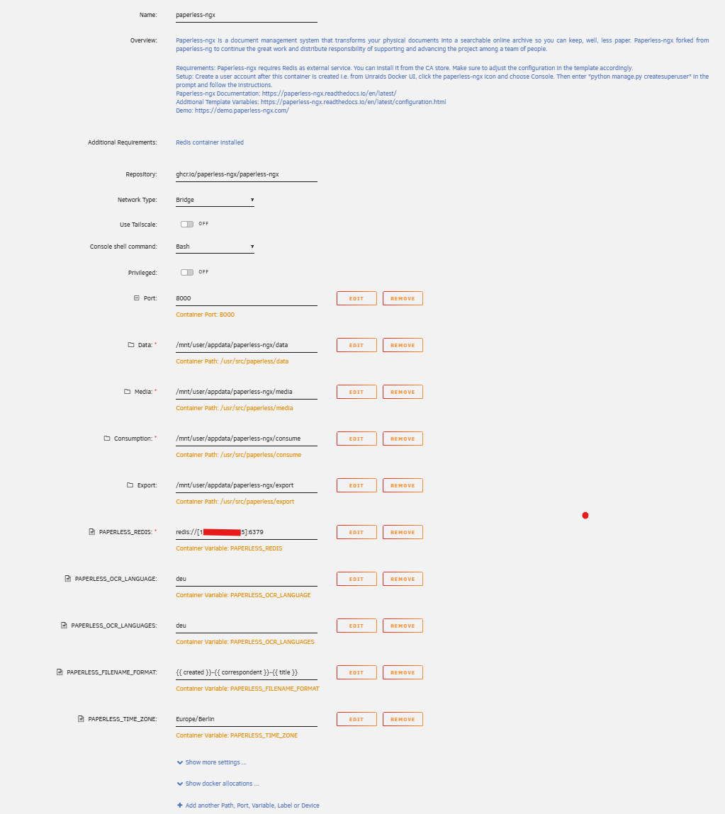

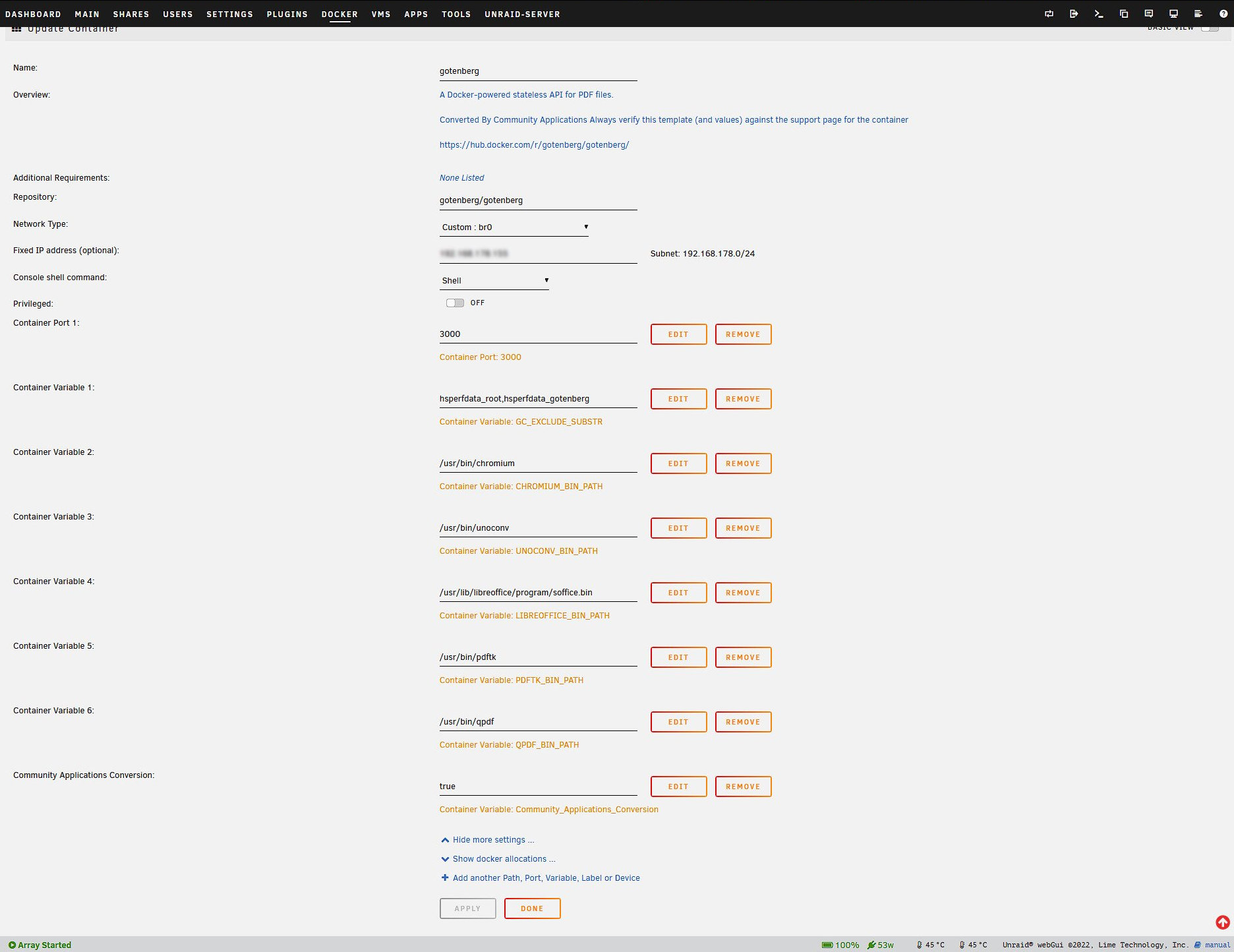

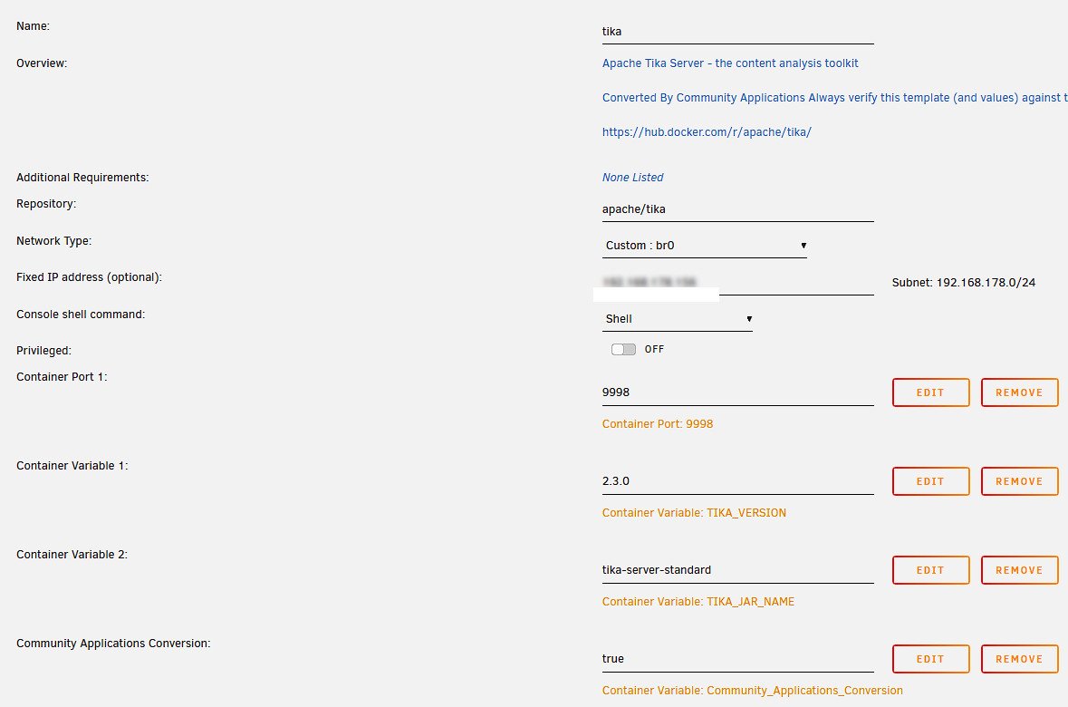

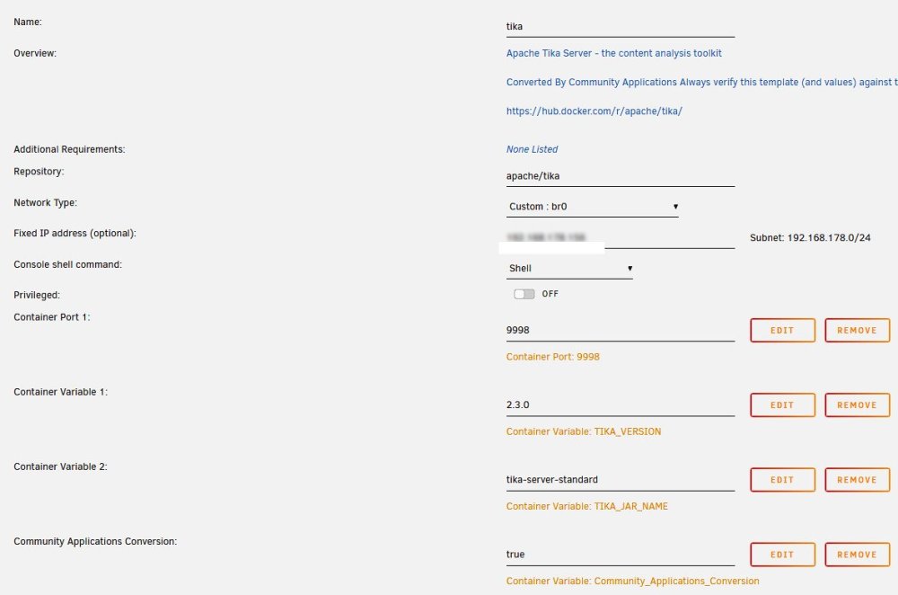

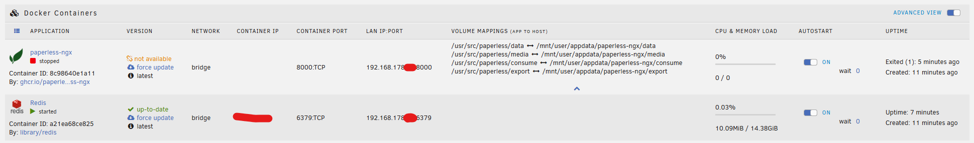

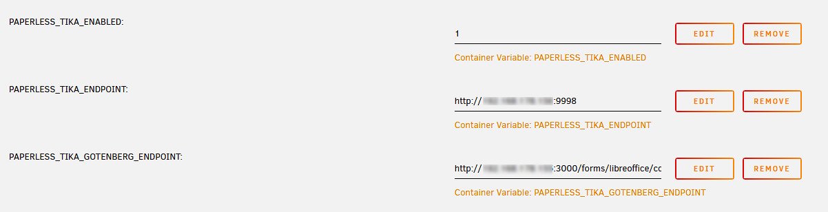

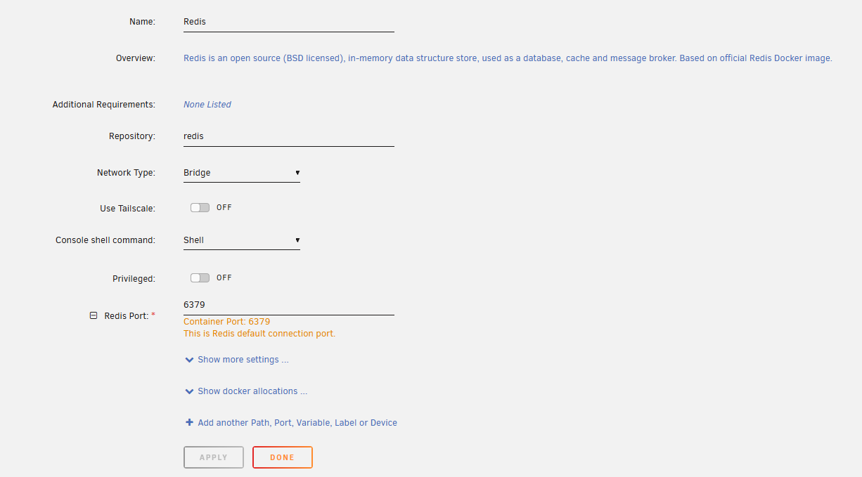

  • I installed these 2 containers: Repository: gotenberg/gotenberg Repository: apache/tika In Paperless i added these 3 varibles: Name / Key:    PAPERLESS_TIKA_ENABLED Value:    1
  • Enter your PAPERLESS_REDIS without brackets
  • Unraid 6.11.5, Docker version status for paperless-ngx has been "not available" for around a day. I update these things routinely so it's odd. db-backup docker also in this state but only those 2 (of

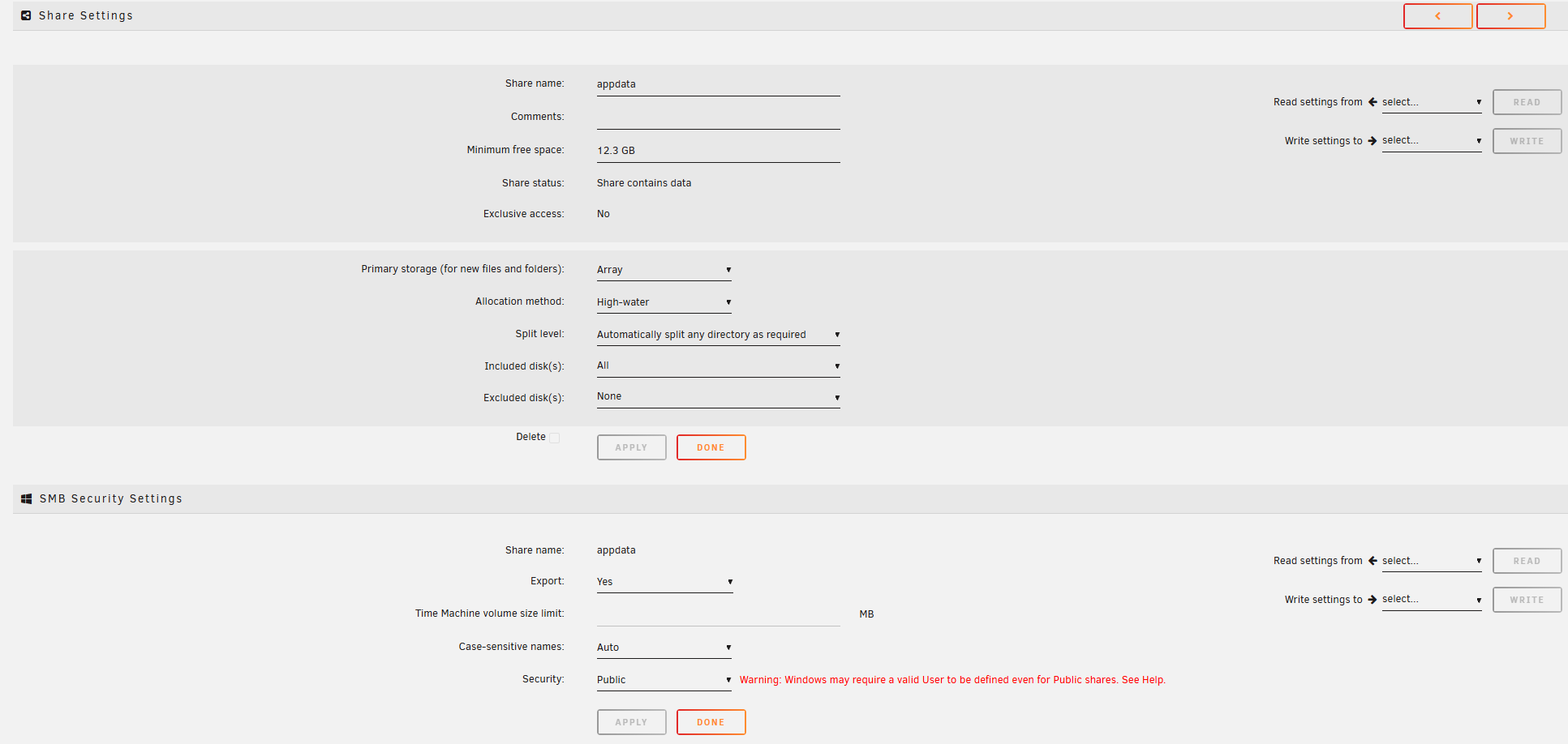

I set up paperless ngx a while ago and uploaded and categorized quite a lot of docs. for some reason, while the OCR-data and my manual input is still there, the thumbnails aren't and the original files are not.
that means.
1. i cannot find them on my share, they are neither in /usr/src/paperless/media (which is my Media-path, but this folder is completely empty in Krusader after clicking on src) ... nor in /mnt/user/appdata/paperless-ngx/data  (which is my Data-path)
2. when i try to re-upload the original pdfs, paperless ngx tells me, that they are duplicates of the ones already in my database
3. when i try to download the files in the paperless-entry, I get this error:
GET /api/documents/45/download/
HTTP 404 Not Found Allow: GET, HEAD, OPTIONS Content-Type: application/json Vary: Accept { "detail": "Not found." }
any suggestions what I might have done wrong or where I could find those darn files or how to re-upload them without having to do all the manual input again? :D

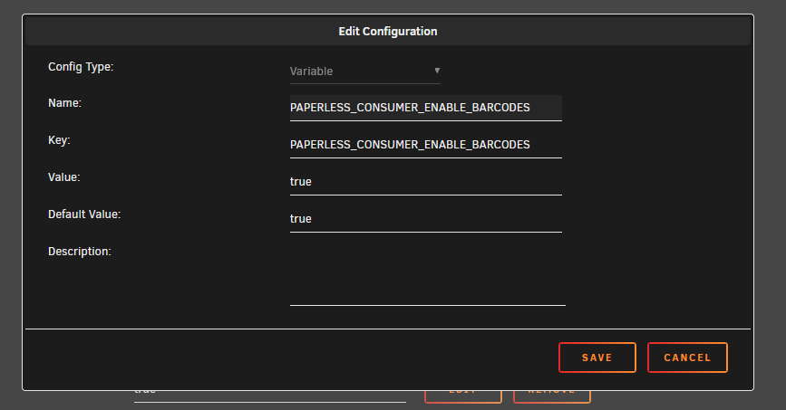

Hi everyone
I have a problem with the Barcode Splitting functionality.
In the Docker settings, I enabled the following variables:
PAPERLESS_CONSUMER_ENABLE_BARCODES:
PAPERLESS_CONSUMER_BARCODE_STRING:
I then tried to scan the documents with a PATCH T barcode, and with a QR code i found on this page: https://github.com/paperless-ngx/paperless-ngx/discussions/2678
With the PATCH T code, i entered "PATCHT" in the barcode string variable, with the QR Code i entered "paperless:separator".
I then tested with 2 documents, but the strange thing is that paperless only consumes the first document, the second document is nowhere. In the Docker Logs i can see the following:

20 hours ago, b_tob said:
Hi everyone
[2024-12-09 17:20:16,859] [INFO] [paperless.management.consumer] Adding /usr/src/paperless/consume/Document_20241209_0001.pdf to the task queue.
[2024-12-09 17:20:16,922] [INFO] [celery.worker.strategy] Task documents.tasks.consume_file[02aec755-4ab6-4221-ada6-b89bd79c0788] received
[2024-12-09 17:20:18,446] [INFO] [celery.worker.strategy] Task documents.tasks.consume_file[c27d131f-bb0b-45f2-8682-e2376af5a181] received
[2024-12-09 17:20:18,446] [INFO] [paperless.barcodes] Created new task c27d131f-bb0b-45f2-8682-e2376af5a181 for Document_20241209_0001_document_0.pdf
[2024-12-09 17:20:18,461] [INFO] [paperless.barcodes] Created new task e9a17693-f4d1-4581-b9df-196897d315c9 for Document_20241209_0001_document_1.pdf
[2024-12-09 17:20:18,464] [INFO] [paperless.tasks] BarcodePlugin requested task exit: Barcode splitting complete!
[2024-12-09 17:20:18,479] [INFO] [celery.app.trace] Task documents.tasks.consume_file[02aec755-4ab6-4221-ada6-b89bd79c0788] succeeded in 1.5541348340921104s: 'Barcode splitting complete!'
[2024-12-09 17:20:19,681] [INFO] [paperless.tasks] BarcodePlugin completed with no message
[2024-12-09 17:20:19,684] [INFO] [paperless.tasks] WorkflowTriggerPlugin completed with:
[2024-12-09 17:20:19,692] [INFO] [paperless.consumer] Consuming Document_20241209_0001_document_0.pdf
[2024-12-09 17:20:19,708] [INFO] [paperless.parsing.tesseract] pdftotext exited 0
[2024-12-09 17:20:20,939] [INFO] [ocrmypdf._pipeline] page is facing ⇧, confidence 8.90 - no change
[2024-12-09 17:20:22,979] [INFO] [ocrmypdf._pipelines.ocr] Postprocessing...
[2024-12-09 17:20:24,901] [INFO] [ocrmypdf._pipeline] Image optimization ratio: 1.00 savings: 0.0%
[2024-12-09 17:20:24,902] [INFO] [ocrmypdf._pipeline] Total file size ratio: 0.27 savings: -270.2%
[2024-12-09 17:20:24,904] [INFO] [ocrmypdf._pipelines._common] Output file is a PDF/A-2B (as expected)
[2024-12-09 17:20:25,624] [INFO] [paperless.parsing] convert exited 0
[2024-12-09 17:20:26,090] [INFO] [paperless.handlers] Assigning correspondent "redacted" to 2022-12-29 Document_20241209_0001_document_0
[2024-12-09 17:20:26,095] [INFO] [paperless.handlers] Assigning document type Rechnung to 2022-12-29 "redacted" Document_20241209_0001_document_0
[2024-12-09 17:20:26,191] [INFO] [paperless.consumer] Document 2022-12-29 "redacted" Document_20241209_0001_document_0 consumption finished
[2024-12-09 17:20:26,193] [INFO] [paperless.tasks] ConsumeTaskPlugin completed with: Success. New document id 109 created
[2024-12-09 17:20:26,206] [INFO] [celery.app.trace] Task documents.tasks.consume_file[c27d131f-bb0b-45f2-8682-e2376af5a181] succeeded in 7.4470139590557665s: 'Success. New document id 109 created'
As far as i understand, the Barcode is being recogniszed, the first document is consumed and created, but with the second document, theres nothing happenig.
Does anyone have an idea why this is happening?
thank you!
I only added these two in my .env file, then it worked.
PAPERLESS_CONSUMER_ENABLE_BARCODES=true
PAPERLESS_CONSUMER_BARCODE_STRING="PATCHT"
Don't know what you meen with "... with the QR Code i entered "paperless:separator". "
Value:    1
Name / Key:    PAPERLESS_TIKA_ENDPOINT
Value:    http://IP-of-tika-container:9998
Name / Key:    PAPERLESS_TIKA_GOTENBERG_ENDPOINT
Value:    http://IP-of-gotenberg-container:3000/forms/libreoffice/convert#
http:// before IP seems to be important. Only IP didnt work for me.
Hope this helpes
Hi there,
I know it is not the most up to date post, but I ran into issues setting up Gotenberg and TIka and so I thought I just post here what helped me.
I used all Containers from the Community Application Add-on.
In the end what made thinks work  it was the shorter version of the URL for Gotenberg.
I followed the offical advice on:
https://docs.paperless-ngx.com/configuration/#PAPERLESS_TIKA_GOTENBERG_ENDPOINT
but formatted according to Unraid, so I needed to insert my IP of the server instead of "local host" and used the variable
PAPERLESS_TIKA_GOTENBERG_ENDPOINT: (as above) instead of PAPERLESS_TIKA_GOTENBERG_ENDPOINT=<url> (as in offical documenttion).
So changing to this instead of the longer  URL (http://IP-of-gotenberg-container:3000/forms/libreoffice/convert#) was all that is needed.

Hello everyone,
I have a problem with my Docker container Paperless-NGX since the last update. The error messages are either “Authentication Required” or “Invalid username, password pair, or user is disabled.” I have already tried the following:
• Restored from my Paperless backup
• Updated Redis, also using a different repository
• Set and reverted passwords for Redis and Paperless
Additionally, I have tried:
Changing
redis://redis:[email protected]:6390
to
redis://192.168.10.254:6390
(This has always been my default setup)
However, the container still won’t start. Does anyone have an idea what could be causing this issue?
Attached are the log file from Paperless and some screenshots of my Docker settings.
I’m really desperate at this point and hope that someone here can help me.
Thank you in advance!
Paperless-ngx docker container starting...
Installing languages...
Package tesseract-ocr-deu already installed!
Package tesseract-ocr-eng already installed!
Mapping UID and GID for paperless:paperless to 99:100
Creating directory scratch directory /tmp/paperless
mkdir: created directory '/tmp/paperless'
Adjusting permissions of paperless files. This may take a while.
Waiting for Redis...
Redis ping #0 failed.
Error: invalid username-password pair or user is disabled..
Waiting 5s
Redis ping #1 failed.
Waiting 5s
Redis ping #2 failed.
Waiting 5s
Redis ping #3 failed.
Waiting 5s
Redis ping #4 failed.
Waiting 5s
Failed to connect to redis using environment variable PAPERLESS_REDIS.
** Press ANY KEY to close this window **
redis 15:45:40.04 INFO  ==>
redis 15:45:40.04 INFO  ==> Welcome to the Bitnami redis container
redis 15:45:40.04 INFO  ==> Subscribe to project updates by watching https://github.com/bitnami/containers
redis 15:45:40.05 INFO  ==> Did you know there are enterprise versions of the Bitnami catalog? For enhanced secure software supply chain features, unlimited pulls from Docker, LTS support, or application customization, see Bitnami Premium or Tanzu Application Catalog. See https://www.arrow.com/globalecs/na/vendors/bitnami/ for more information.
1:C 24 Feb 2025 15:45:40.069 # WARNING Memory overcommit must be enabled! Without it, a background save or replication may fail under low memory condition. Being disabled, it can also cause failures without low memory condition, see https://github.com/jemalloc/jemalloc/issues/1328. To fix this issue add 'vm.overcommit_memory = 1' to /etc/sysctl.conf and then reboot or run the command 'sysctl vm.overcommit_memory=1' for this to take effect.
1:C 24 Feb 2025 15:45:40.069 * oO0OoO0OoO0Oo Redis is starting oO0OoO0OoO0Oo
1:C 24 Feb 2025 15:45:40.069 * Redis version=7.4.2, bits=64, commit=00000000, modified=1, pid=1, just started
1:C 24 Feb 2025 15:45:40.069 * Configuration loaded
1:M 24 Feb 2025 15:45:40.069 * monotonic clock: POSIX clock_gettime
1:M 24 Feb 2025 15:45:40.070 * Running mode=standalone, port=6379.
1:M 24 Feb 2025 15:45:40.070 * Server initialized
1:M 24 Feb 2025 15:45:40.070 * Ready to accept connections tcp

A few days ago, I set up Paperless in Unraid as a Docker container, assigned various automatic storage paths, and imported about 200 documents.
I handle all processing via the browser.
When I need files, I want to copy them via the mounted share using (Mac) Finder to my Desktop.
I do not make any changes on the SMB share by hand!
However, this doesn’t work for all files.
About 10% of them are visible but cannot be opened wit this error "File xyz.pdf file not found."
All files were uploaded via the web interface and can be read and edited from there without any issues, i can download them via the Unraid GUI also.
The Media/Consume/Export folders are located on an internal SSD here: /mnt/user/paperless/.
I access the web interface as an admin, and the SMB share is mounted with read/write permissions.
In the Screenshot attached,
File #1 Can be opened without problems.
File #2+3 Can only be opened in the browser.
tried running docker safe new permissions also.
root@d98e64333c06:/usr/src/paperless# ls -lh
drwxrwxrwx 1 paperless users 6 Feb 2 10:17 consume
drwxrwxrwx 1 paperless users 157 Feb 2 11:05 data
drwxrwxrwx 1 paperless users 6 Jan 28 21:22 export
-rw-r--r-- 1 paperless 1000 1.4K Jan 31 16:58 gunicorn.conf.py
drwxrwxrwx 1 paperless users 41 Feb 2 10:17 media
drwxr-xr-x 1 paperless 1000 219 Jan 31 16:58 src
drwxr-xr-x 1 paperless 1000 261 Jan 31 17:01 static
I assume it’s a permission issue, but I don’t understand why it only affects certain files.
How can I fix this?

Hello everyone,
i tried to install paperless-ngx but im unable to create the superuser, the console is closing instantly with the docker shutting down.
I cant enter "python manage.py createsuperuser". I guess thats the problem.
Did someone know or has ideas how i could fix that?
i already found a post in this topic, but letting paperless create the needed folders itself didnt helped me.
Logs of Paperless.txtLogs of Redis.txt
mapping and setting overview:
settings of paperless:
settings of redis:
Edited by Happy15th
wrong pictures
