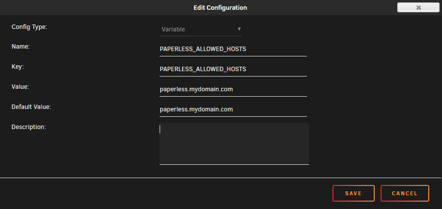

12 hours ago, mgutt said:
Edit the container, scroll down and click on add variable.
A variable for the allowed hosts or a variable to a new config file?

On 7/4/2022 at 9:12 AM, TimTaylor said:
Ah hm that setting doesnt exists at my docker :/
Don't know if you've sorted this but you can add it
Edit the docker and at the bottom click 'Add another Path, Port, Variable, Label or Device'
Here is a preview of mine minus the host path
