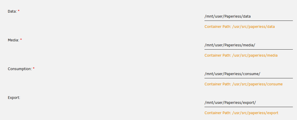

Paperless-ngx always fills my docker.image instead of saving it to the array. Currently it is 96% filled and I don't know why. All files are max 1.2Gb in total. I have already enlarged the docker.image to 40Gb! in the docker settings.
Here you can see the memory usage is ok, but the docker usage is nearly at the max.
This is the template settings i'm using for the storage(do i have them wrong?)
Update:
I think I found part of the problem. I removed and reinstalled everything again and uploaded individual files as a test. Default allocation of the docker.image was about 8.26GB. Then when uploading it fluctuated between 8.26-8.27GB.
I have a PDF file with 481MB which I then uploaded, now it slowly but steadily increased by that amount until it stopped at 20GB. 1 file is responsible for a little over 11GB even though the file is actually only 481MB.
On the Paperless interface, the file remains in the uploader with "Processing Document" without anything else happening....

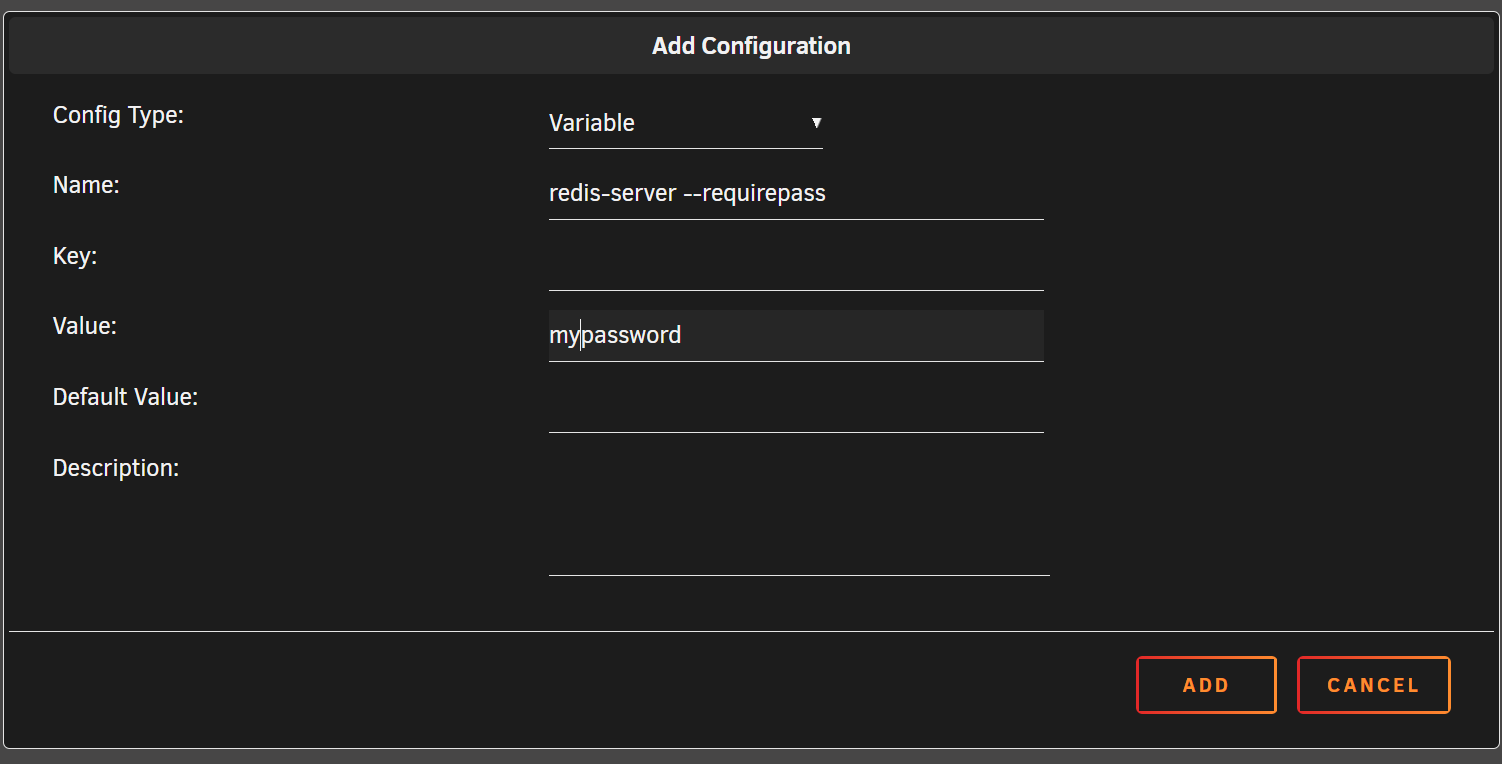

I'm trying to add a password to the Redis container. I've read the instructions on the first page of the thread, but I dont know how to proceed. I've tried going to the edit page and adding a new variable and giving it the redis-server --requirepassword name, but it does not work.  What am I doing wrong?
did you fix your problem?

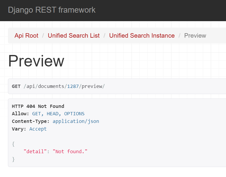

Hi guys,
I updated to paperless-ngx this year and I have issues with my already added thumbnail documents. If I add a new file it works but I don't get the thumbnail for documents that were added going to paperless-ngx. Accessing files is fine.
document_sanity_checker detects all the issues but it does not fix it. How do I fix it? Is there a command to update all thumbnails based on files sorted?
EDIT: Fixed using the command
document_thumbnail
and fixing errors by hand when necessary.
