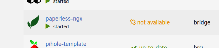

Unraid 6.11.5, Docker version status for paperless-ngx has been "not available" for around a day. I update these things routinely so it's odd. db-backup docker also in this state but only those 2 (of 20). Repo says "ghcr.io/paperless-ngx/paperless-ngx". Best I can tell it's still there.
UPDATE: Installed the CA Docker Patch plugin and all seems well again.

I am running in the same issue:
Since some days docker of paperless-ngx shows as version "not available" on Unraid 6.11.5.
When opening paperless I see that a new version is available (1.12.2; currently it is 1.11.3).
Repository is ghcr.io/paperless-ngx/paperless-ngx aswell.
Any ideas how to get the image updated?
Same issue. Paperless needed to connect to the Redis DB to work properly.
Installing the CA Docker Patch plugin solved the problem and enabled the updates for Paperless and Redis as @Abe677 pointed out.
Thanks!
Same here for me.
Paperless-ngx seems to stuck on version 1.11.3. Although there is the actual version 1.12.2, unraid shows "not available" on the version.
I tried to change the repository to
ghcr.io/paperless-ngx/paperless-ngx:latest
as shown in the post from @jeypiti, but no luck.
There seems actual no indication, that the container will be updated ...
Has somebody a solution?
27 minutes ago, diarun said:
Same here for me.
This did the trick for me.
I had CA Docker Patch already installed, no luck.
But then I saw, that there was a “force update” below “not available”.
So, just done and the force was with me. 😁 Jep, now I have the newest version.
I don't saw this option, because I use the docker folder plugin and was on the basic view.
THX for the hint, it was somehow a direction ...
Edit: Changed back to 1.11.3 and the container started up.

Trying to install paperless-ngx from APPS menu, but getting error. Redis already installed.
docker run
  -d
  --name='paperless-ngx'
  --net='bridge'
  -e TZ="Europe/London"
  -e HOST_OS="Unraid"
  -e HOST_HOSTNAME="NeivesUnraid"
  -e HOST_CONTAINERNAME="paperless-ngx"
  -e 'PAPERLESS_REDIS'='redis://192.168.68.240:6379'
  -e 'PAPERLESS_OCR_LANGUAGE'='pt'
  -e 'PAPERLESS_OCR_LANGUAGES'='pt'
  -e 'PAPERLESS_FILENAME_FORMAT'='{created}-{correspondent}-{title}'
  -e 'PAPERLESS_TIME_ZONE'='Europe/London'
  -e 'PAPERLESS_IGNORE_DATES'=''
  -e 'PAPERLESS_CONSUMER_POLLING'='0'
  -e 'PAPERLESS_SECRET_KEY'='e11fl1oa-*ytql8p)(06fbj4ukrlo+n7k&q5+$1md7i+mge=ee'
  -e 'USERMAP_UID'='99'
  -e 'USERMAP_GID'='100'
  -l net.unraid.docker.webui='http://[IP]:[PORT:8000]'
  -l net.unraid.docker.icon='https://raw.githubusercontent.com/selfhosters/unRAID-CA-templates/master/templates/img/paperless.png'
  -p '8000:8000/tcp'
  -v '/mnt/user/appdata/paperless-ngx/data':'/usr/src/paperless/data':'rw'
  -v '/mnt/user/appdata/paperless-ngx/media':'/usr/src/paperless/media':'rw'
  -v '/mnt/user/appdata/paperless-ngx/consume':'/usr/src/paperless/consume':'rw'
  -v '/mnt/user/appdata/paperless-ngx/export':'/usr/src/paperless/export':'rw' 'ghcr.io/paperless-ngx/paperless-ngx'
Unable to find image 'ghcr.io/paperless-ngx/paperless-ngx:latest' locally
docker: Error response from daemon: Head "https://ghcr.io/v2/paperless-ngx/paperless-ngx/manifests/latest": Get "https://ghcr.io/token?scope=repository%3Apaperless-ngx%2Fpaperless-ngx%3Apull&service=ghcr.io": net/http: request canceled (Client.Timeout exceeded while awaiting headers).
See 'docker run --help'.
The command failed.
