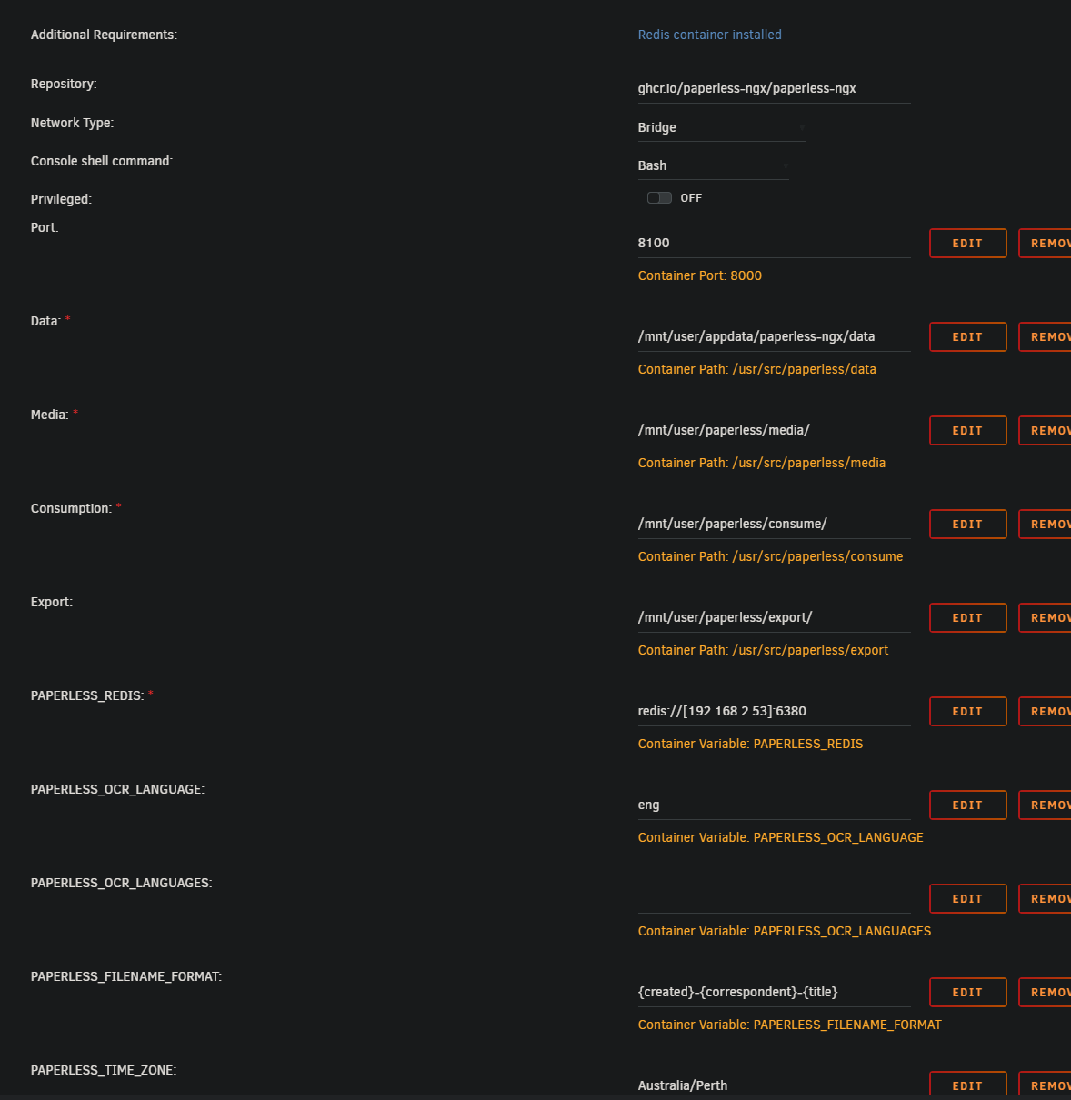

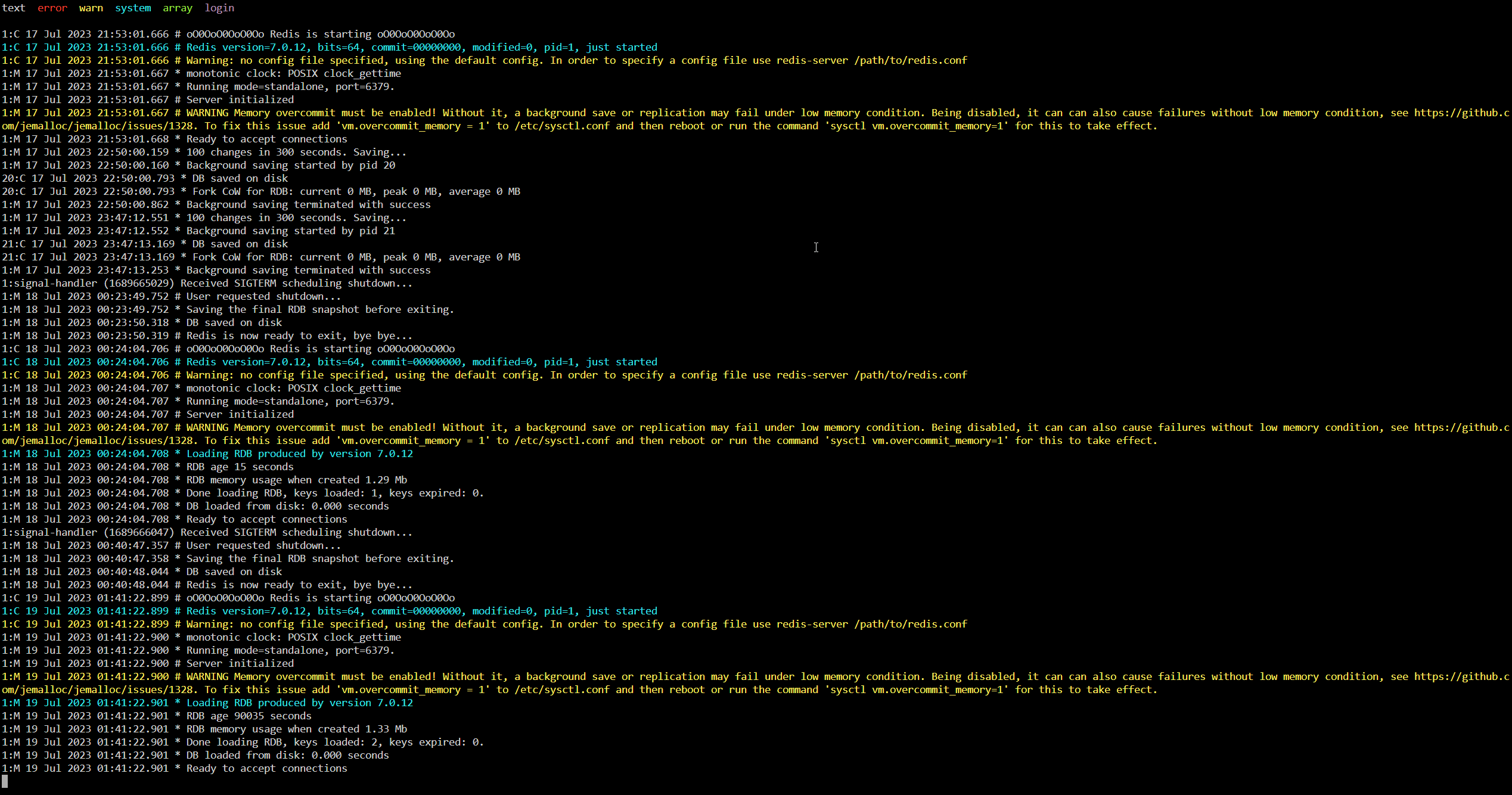

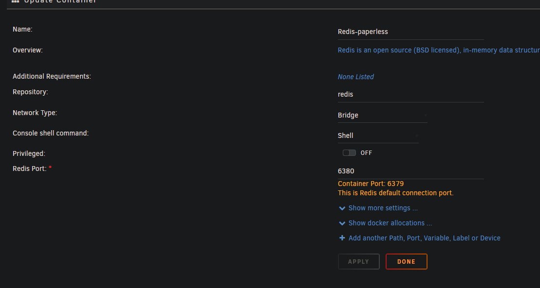

I've been noticing the docker has been stopping randomly. It's not too annoying since the rare chance I need to upload or retrieve documents I just spin it up.
My best guess is it's the Redis or Paperless docker doing a weekly update that causes it, since they rely on each other. Does that sound right? Is there a way to fix this besides a User Script that just routinely checks if Paperless is running, if not, starts it?
Here are the logs from the stopped container:

Waiting for Redis...
Redis ping #0 failed.
Error: Error 111 connecting to 192.168.1.200:6379. Connection refused..
Waiting 5s
Redis ping #1 failed.
Waiting 5s
Redis ping #2 failed.
Waiting 5s
Redis ping #3 failed.
Waiting 5s
Redis ping #4 failed.
Waiting 5s
Failed to connect to redis using environment variable PAPERLESS_REDIS.
** Press ANY KEY to close this window **

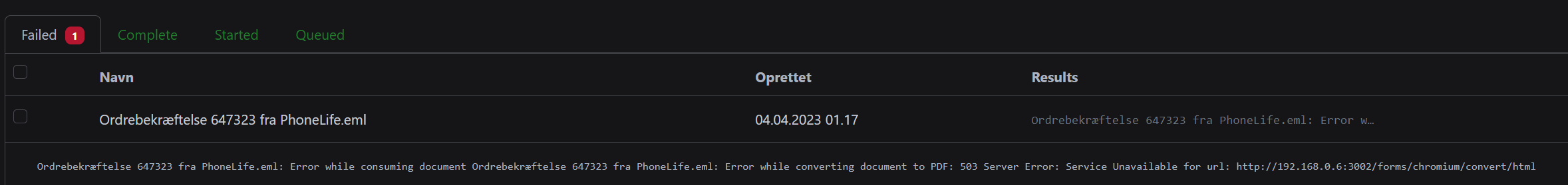

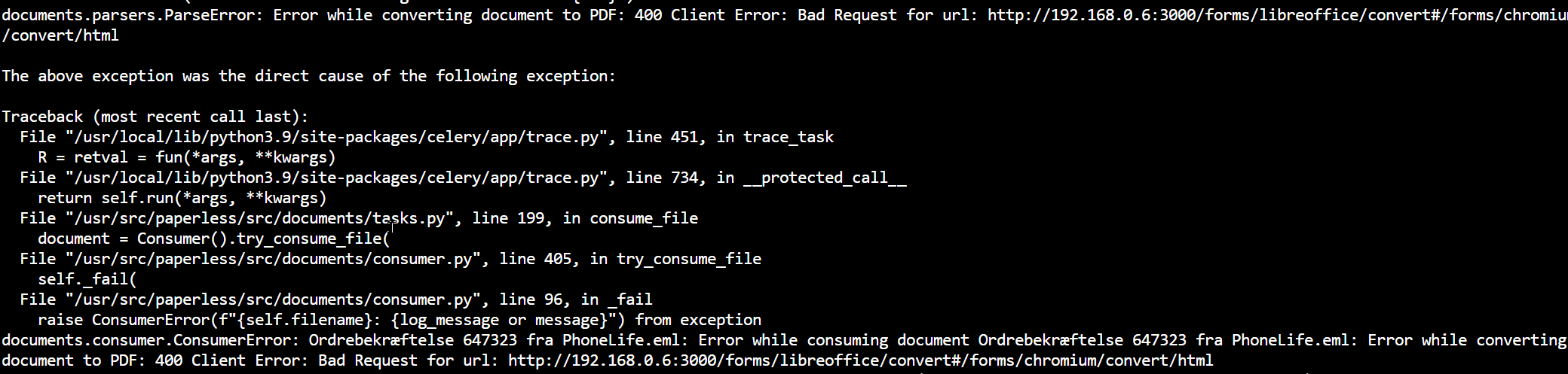

I keep getting the "503 Server Error" when trying to convert to pdf with Paperless-ngx, Tika, and Gotenberg?
I can see that if I add the values on the docker for Paperless the path is wrong:
http://192.168.0.6:3002/forms/libreoffice/convert#
So I removed everything after the "http://192.168.0.6:3002" and then I got this:
And you can see that it adds "/forms/chromium/convert/html"
I read something about that the Tika, and Gotenberg dockers where optimized for paperless ngx?
So maybe that's the problem?
Anyway have anyone gotten this to work?
My configuration.
GOTENBERG_ENDPOINT is using port 3002 instead of port 3000.

Does this still work for you? I can see that the Gotenberg docker now only exists from v7 and upwards?
No matter what I do I cant get the Tika and Gotenberg working it looks like it adds some string to the API
The only thing that I have changed in the meantime is that I switched gotenberg and tika to the Docker from the CA.
I haven't changed the settings and it works.
Update: I found that you need a version above 7 for Gotenberg and you need to use the IP as endpoints and not the "docker name" on the internal "proxynet" also many variables are missing from the docker if you want Inv. proxy working and also the integrations to the Tika & Gotenberg - BUT IT WORKS NOW! 🙂
Also used the link below to compare the docker conf.
paperless-ngx/docker-compose.sqlite-tika.yml at main · paperless-ngx/paperless-ngx (github.com)

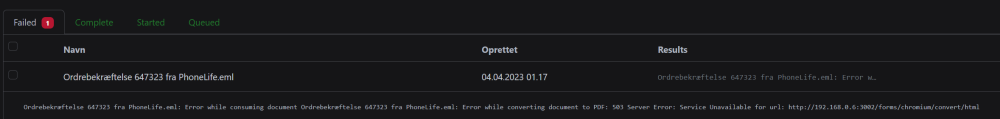

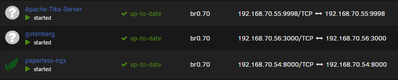

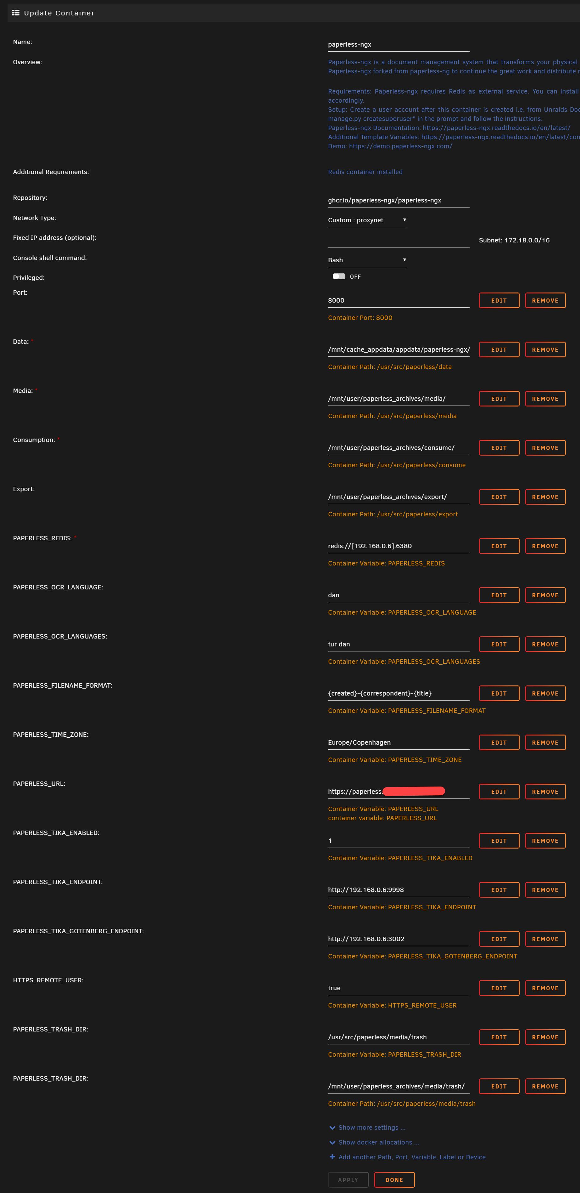

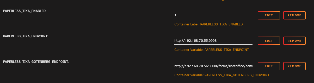

I just got everything installed and have been getting things sorted. My attempt at sending some Word docs (.docx) has failed. I've tried uploading into the GUI and copied into the consume directory and both fail with file extension not recognized.
Here is the error:
I've configured the paperless-ngx docker file to point to Tika and Gotenberg by following this thread. Here are my settings:
Here are the containers, pulled from the unRAID community applications:
I can hit the API on Tika server, not sure how to test Gotenberg, but then again, I don't really know what process actually allows recognition of the docx file.
Lastly, I did try other Word docs and same result. (text files and PDFs are processing correctly).
Appreciate any recommendations, thanks!
On 5/8/2023 at 7:22 PM, Sky-Dragon said:
@birdsofprey02
Your PAPERLESS_TIKA_GOTENBERG_ENDPOINT is wrong, use only http://192.168.70.56:3000 .
You don't need the rest, see documentation https://docs.paperless-ngx.com/configuration/#tika
I've tried both with the extended URL, with just http://192.168.70.56:3000 and with http://192.168.70.56:3000/   still same error. I've restarted the container, stopped and started.   Not really sure what else to try.
Why do the containers have different IP's (54, 55, 56)? They would normally all have the same IP as the UNRAID server, just each on a different port
I have multiple vLANs setup on my unRAID server. Over 30 containers and none of them are running on the same IP as unRAID except maybe the Cloudflare Tunnel container. I don't think there's a requirement anywhere that docker containers have to run on the same IP as the host. The containers can all still talk to each other.
This might be a silly question, but how do I know if paperless-ngx is using redis? I have it installed and on the same custom docker network and I point paperless to "redis://[redis]:6379". Paperless is working but I have no idea if it is actually using redis.
I honestly don't really understand how external databases work. I'm also wondering how I backup the redis database because it doesn't have an appdata mapping.
hi, ive just installed paperless ngx for the first time, in paperless UI im able to get to the log in screen, after entering superuser login details i get 'Forbidden (403) CSRF verification failed. Request aborted.
How to resolve this?
Edited by K1LLA_KING_KING
Can you supply your config, logs etc? What Browser are you using?
Thannks for your response, I'm using Chrome
Log:

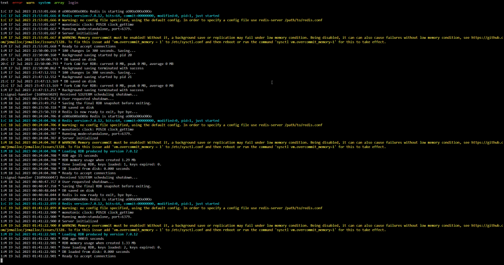

Errors in Redis log:
I wonder is this because I have chose 'bridge' network amd need to define an IP?
You also need a database server eg Postgres.
Is Redis not the database?
I have MariaDB already installed, not sure its working properly tho, as it fails to work with Nextcloud, I could try Postgres, how does one set this up to work with paperless?
