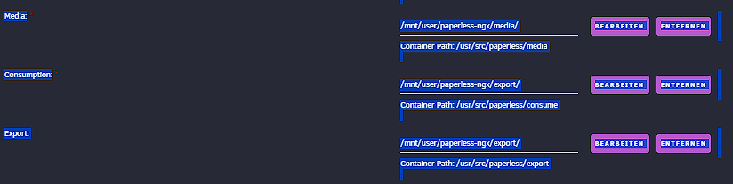

I just installed paperless-ngx as described in https://flemmingss.com/how-to-set-up-paperless-ngx-on-unraid/
The 'media', 'consumption' and 'export' are mounted into the share "Documents". The share is set to "public" access and the folders show up. Unfortunately, the folders are read only. The "Documents" root is correctly read/write. "Access Mode" for all folders in the settings is set to 'read/write'.
Does anyone have an idea what I might have done wrong?
Update: I found the solution. The folders 'media', 'consumption', 'export' should exist in the share before the docker app starts. If the app generates the folders on startup, they seem to have the wrong owner or something similar. Now everything works great!
Edited by vacuu
Solution found

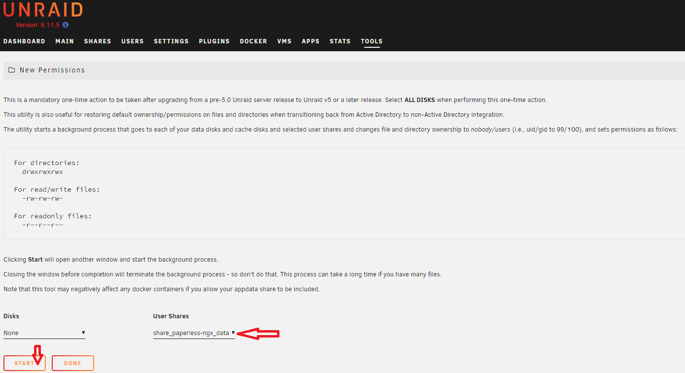

Another solution, when I have problems like this I use the "New Permissions" tool in unraid on that share :) Thanks for using the guide btw.
Processing: /mnt/user/share_paperless-ngx_data
... chmod -R u-x,go-rwx,go+u,ugo+X /mnt/user/share_paperless-ngx_data
... chown -R nobody:users /mnt/user/share_paperless-ngx_data
... sync
Completed, elapsed time: 00:00:01

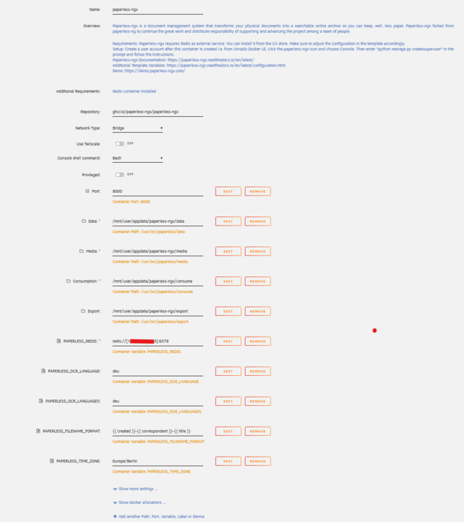

What do I have misconfigured?  My docker config is blowing up my Docker Image file (see Writable below).  Is this a common/known issue I can fix?
Container Size
Name                                              Container                Writable                 Log
paperless-ngx                                     13.5 GB                  12.1 GB                  5.89 MB
attached pic for docker config
Thank you for any input!

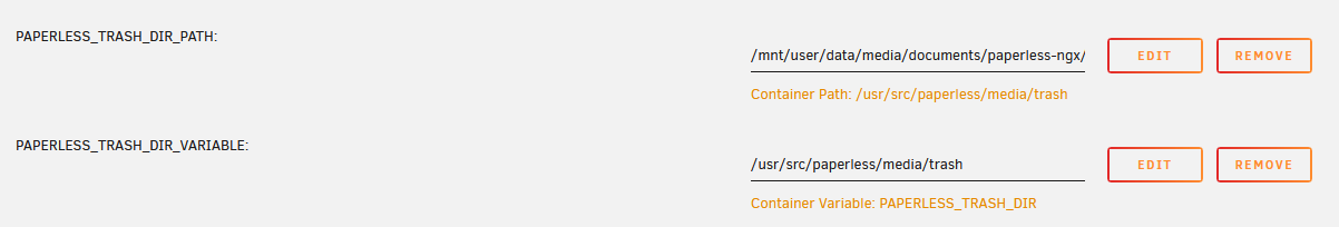

On 2/3/2023 at 4:56 AM, SOULV1CE said:
I just solved a problem I was having with adding the PAPERLESS_TRASH_DIR parameter that I wanted to share.
As mentioned in the Paperless documentation the default value of this parameter is "Defaults to empty (i.e. really delete documents)."
Because it is empty it is never mapped to any container path - I verified this by looking in the /paperless.conf.example and src/paperless/settings.py file.
So because of this you first need to create a container variable for PAPERLESS_TRASH_DIR and map it to a container path such as /usr/src/paperless/media/trash because nothing is ever defined for this.
Now that we have defined the variable to the container path, we can then proceed with mapping the container path /usr/src/paperless/media/trash to a host path such as /mnt/user/data/media/documents/paperless-ngx/media/trash/.
Finally after doing this when deleting a file it should be moved to the host path folder /mnt/user/data/media/documents/paperless-ngx/media/trash/ and not be permanently deleted.
this is working fine for me, but I was wondering why not a single path variable for PAPERLESS_TRASH_DIR would be working?

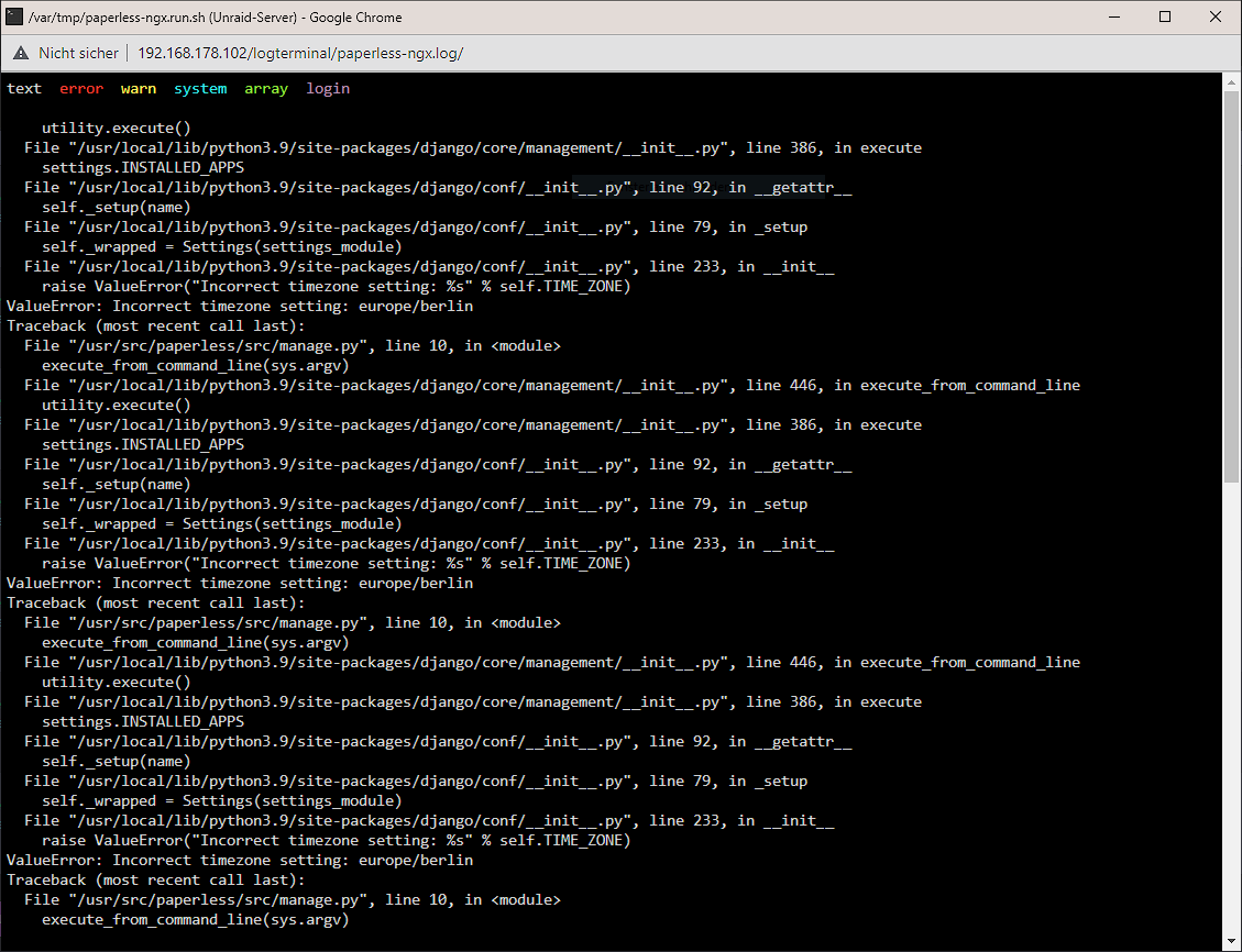

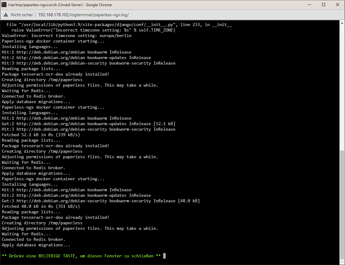

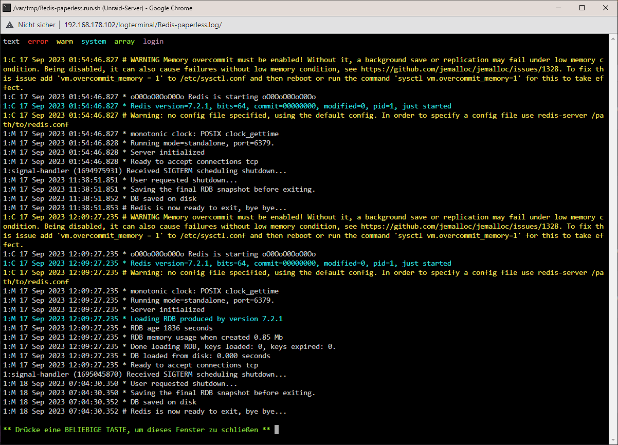

Hello everyone,
I have a problem with my Paperless NGX!
I installed it following the instructions in a YouTube video, but then I can't access the surfaces.
https://www.youtube.com/watch?v=iuxsNJ3Ru7Y&t=157s&pp=ygUacGFwZXJsZXNzIG5neCBpbnN0YWxsaWVyZW4%3D
When I want to start the console to enter the superuser, the window only opens briefly (half a second) and then immediately closes again. Even if I want to open Paperless via the WebUI, I get the message - the website is not accessible and [Port] has refused the connection. -
Redis has of course been installed beforehand.
What am I doing wrong?
Does somebody has any idea?

4 hours ago, Rops said:

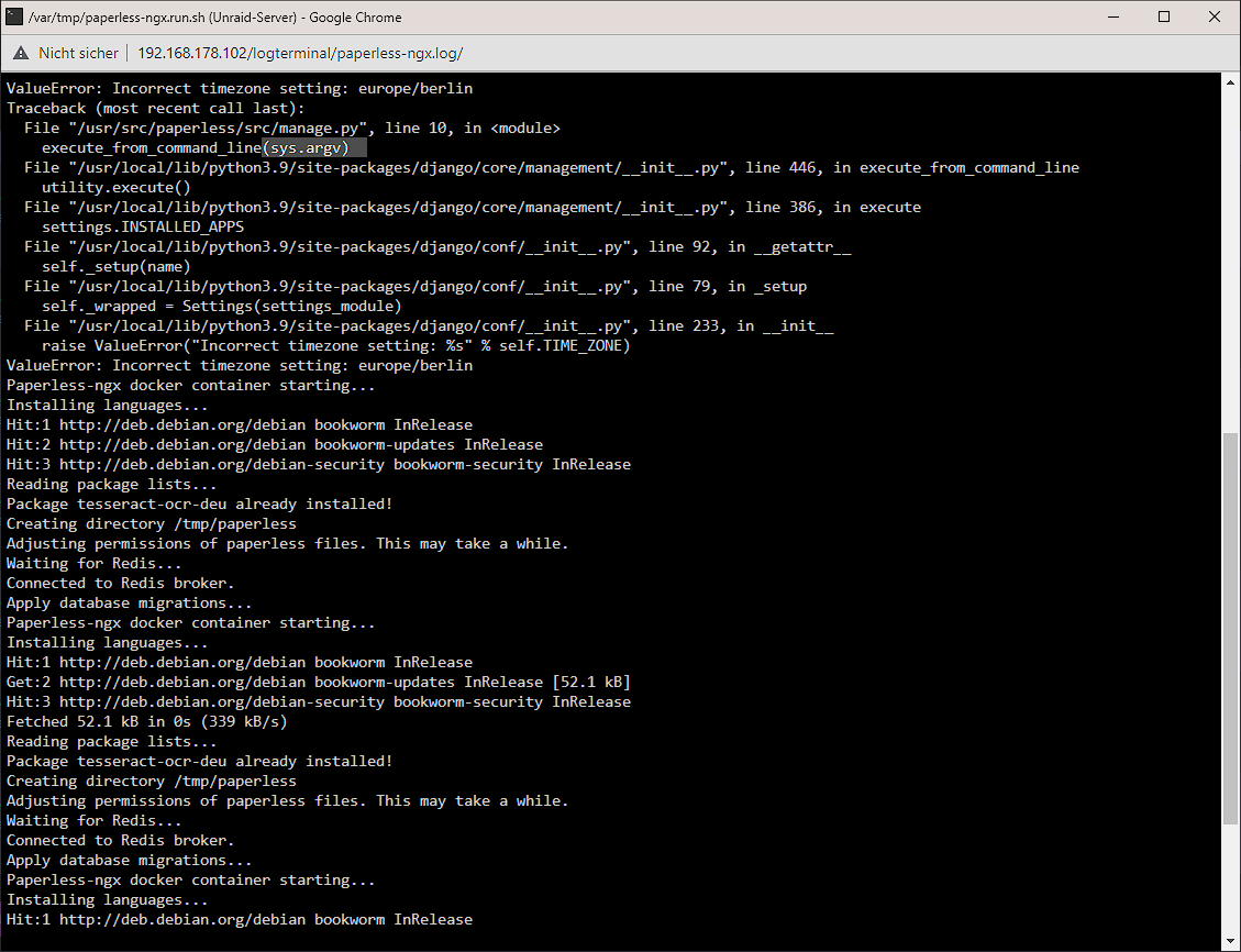

Hello everyone,
Can we have a look at the logs? Both paperless and redis.
Also, did you create the paperless folders over smb like shown in the video? This could have messed up the file permissions. Better to let unraid create those folders on container creation.
Here's the one from Paperless
Now the one from Redis
2 hours ago, Tuetenk0pp said:
Haben Sie außerdem die papierlosen Ordner über SMB erstellt, wie im Video gezeigt? Dies könnte die Dateiberechtigungen durcheinander gebracht haben. Lassen Sie diese Ordner besser von Unraid bei der Containererstellung erstellen.
Yes, I created the folders via sharing (SMB) like in the video. I then created the three folders in this folder by hand.
Should I then just create the folder in Shares and let Paperless create the three subfolders?

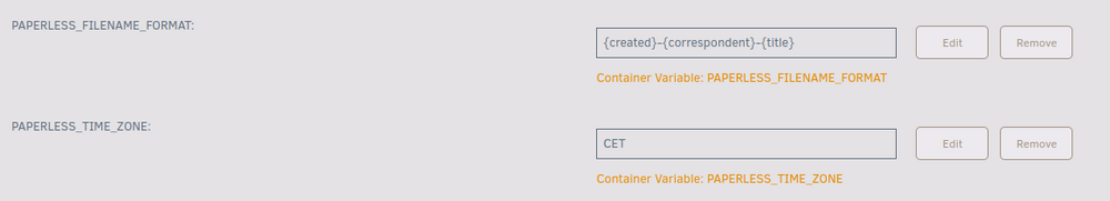

Timezone should be 'Europe/Berlin'
You could try that
It works now! Many thanks for the help.
Was the solution now in the three folders?
Is it the only thing you changed? Yes! Did you also change the TZ setting? Possible.
I deleted the three folders in shares and then had Paperless create them. There I saw an error that I made when creating it. I accidentally wrote "Export" in Consume. See image. And also i changed the time zone. Was mine wrong?
I'm currently still having the problem that if I want to move a PDF directly into my Consume folder (in Explorer) it won't allow me to do so. Here I get the error message that I don't have the required authorization for this process.
So I can't copy or move a PDF document directly into the consume folder.
