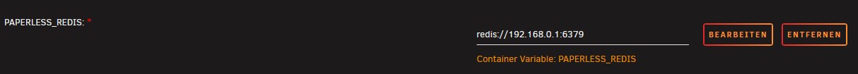

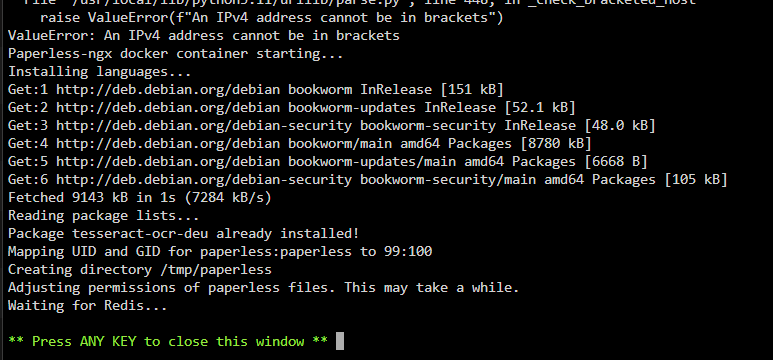

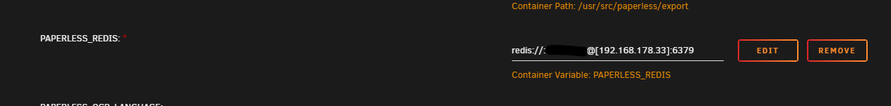

  • I installed these 2 containers: Repository: gotenberg/gotenberg Repository: apache/tika In Paperless i added these 3 varibles: Name / Key:    PAPERLESS_TIKA_ENABLED Value:    1
  • Enter your PAPERLESS_REDIS without brackets

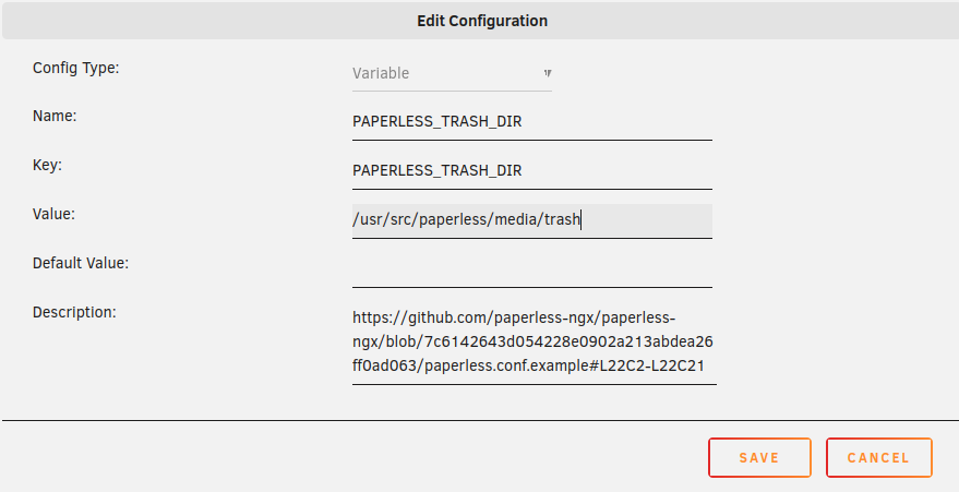

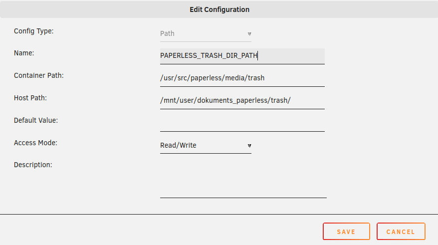

On 2/3/2023 at 4:56 AM, SOULV1CE said:
I just solved a problem I was having with adding the PAPERLESS_TRASH_DIR parameter that I wanted to share.
As mentioned in the Paperless documentation the default value of this parameter is "Defaults to empty (i.e. really delete documents)."
Because it is empty it is never mapped to any container path - I verified this by looking in the /paperless.conf.example and src/paperless/settings.py file.
So because of this you first need to create a container variable for PAPERLESS_TRASH_DIR and map it to a container path such as /usr/src/paperless/media/trash because nothing is ever defined for this.
Now that we have defined the variable to the container path, we can then proceed with mapping the container path /usr/src/paperless/media/trash to a host path such as /mnt/user/data/media/documents/paperless-ngx/media/trash/.
Finally after doing this when deleting a file it should be moved to the host path folder /mnt/user/data/media/documents/paperless-ngx/media/trash/ and not be permanently deleted.
Thank you very much for that hint!
Additionally I want to mention, that the trash folder
did not exist on my paperless instance. Therefore I created the folder by opening the console:
and added the folder with:
root@ab2ac556cb92:/usr/src/paperless/src# cd ../media/
root@ab2ac556cb92:/usr/src/paperless/media# mkdir trash
root@ab2ac556cb92:/usr/src/paperless/media# chown paperless trash/
root@ab2ac556cb92:/usr/src/paperless/media# chgrp paperless trash/
Then I followed your hint and created the Variable for PAPERLESS_TRASH_DIR to point to that newly created trash folder
and map that internal trash folder to path on my smb share
so I have write access and can delete the files in the trash folder by myself or periodically via user script.
Thank you again for sharing.

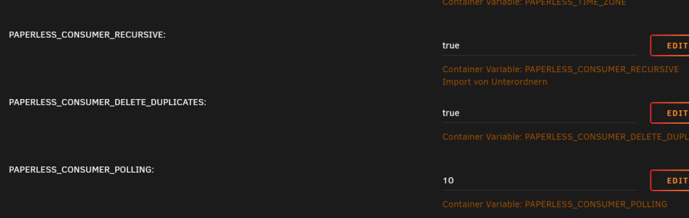

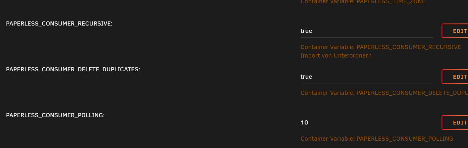

Hi there,
I hope anyone can help me :) I have a Paperless Docker runs under Unraid. I have created 2 variables for the Subdir as Tags function
PAPERLESS_CONSUMER_RECURSIVE: true
PAPERLESS_CONSUMER_SUBDIRS_AS_TAGS: true
I can see the Docker runs up with these 2 variables but when I drop a Folder A  in paperless it creates no tags for the file.
I have Folder A -> Subfolder B -> File and Paperless only let me see the file without tag.
The Logfile had no errors

On startup paperless ist doing some checks such as checking the various paths for existence, readability and writeability (data dir, trash dir, media dir, consumption dir).
The path checks tries to write a test file to the mounted directories of your container. See here.
In your case the write check fails for your consumption and data dir. I suggest checking the docker mounts and directories on your server first. My guess would be that your container is not allowed writing the mounts.
Thanks for the tip, it was the export directory that I added later. After I took it out again it also works.

Hi all,
I have the issue, that the consumer only works on container start.
I already activated polling, but it does not change.
to me it looks like the polling is not activated, because in the logs it still shows "Using inotify to watch directory for changes: /usr/src/paperless/consume"
my consume directory is in a remote share.
Any other suggestion?
[2023-11-26 20:15:27,485] [INFO] [paperless.management.consumer] Received SIGINT, stopping inotify
[2023-11-26 20:15:27,488] [DEBUG] [paperless.management.consumer] Consumer exiting.
[2023-11-26 20:15:44,058] [INFO] [paperless.management.consumer] Adding /usr/src/paperless/consume/Eingangsbestätigung.pdf to the task queue.
[2023-11-26 20:15:44,252] [INFO] [paperless.management.consumer] Using inotify to watch directory for changes: /usr/src/paperless/consume
EDIT: I did not see, that the variable PAPERLESS_CONSUMER_POLLING: was already existing in the unraid template and created it a second time.
After deleting my variable again, everything works.
Edited by vincemue
solved
Hello,
i update my docker container, but now i cant start the docker.
i restart redis and paperless, but it dont work.
THX
is that the resean ?
ValueError: An IPv4 address cannot be in brackets
That was the problem, now it is solved
Edited by Lucascoco
Whats your entry on "PAPERLESS_REDIS" ?
The Format is

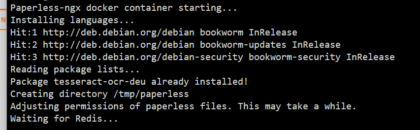

Hello,
I have the same problem.
I updated the Docker and now paperless no longer starts.
Does anyone know a solution?
Thank you in advance
EDIT:
I went back to version 1.17.4 and now it works again.
Edited by i-B4se
I can no longer start Paperless-ngx!
Log:
  File "/sbin/wait-for-redis.py", line 23, in <module>
    with Redis.from_url(url=REDIS_URL) as client:
  File "/usr/local/lib/python3.11/site-packages/redis/client.py", line 139, in from_url
    connection_pool = ConnectionPool.from_url(url, **kwargs)
  File "/usr/local/lib/python3.11/site-packages/redis/connection.py", line 971, in from_url
    url_options = parse_url(url)
  File "/usr/local/lib/python3.11/site-packages/redis/connection.py", line 870, in parse_url
    url = urlparse(url)
  File "/usr/local/lib/python3.11/urllib/parse.py", line 395, in urlparse
    splitresult = urlsplit(url, scheme, allow_fragments)
  File "/usr/local/lib/python3.11/urllib/parse.py", line 500, in urlsplit
    _check_bracketed_host(bracketed_host)
  File "/usr/local/lib/python3.11/urllib/parse.py", line 448, in _check_bracketed_host
    raise ValueError(f"An IPv4 address cannot be in brackets")
That was it 🤦‍♂️
Thank you very much
On 12/2/2023 at 1:01 PM, powerforum75 said:
That was it 🤦‍♂️
Thank you very much
THANKS! - I couldn't understand why it just stopped working!
(This should be on the top page, in the support forum, its a "breaking" change)
