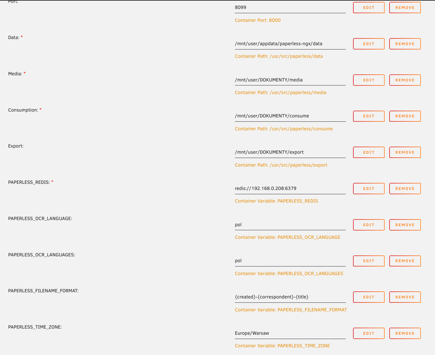

Hi, I find there only that consume folder is folder that I have documents where paperless will take from. There's also to create folders: media, data and consume. It's not my first docker but I think it will be nice to see some descriptions what are that folders for.
Regards.
Regards.
Please read the manual, it's all there.
Eg:
Paths and folders
PAPERLESS_CONSUMPTION_DIR=<path>
This where your documents should go to be consumed. Make sure that it exists and that the user running the paperless service can read/write its contents before you start Paperless.
Don't change this when using docker, as it only changes the path within the container. Change the local consumption directory in the docker-compose.yml file instead.
Defaults to "../consume/", relative to the "src" directory.

 Thank You very much. I cannot find that in docs. There also Export dir in unraid but I will leave it like media folder.
Regards.

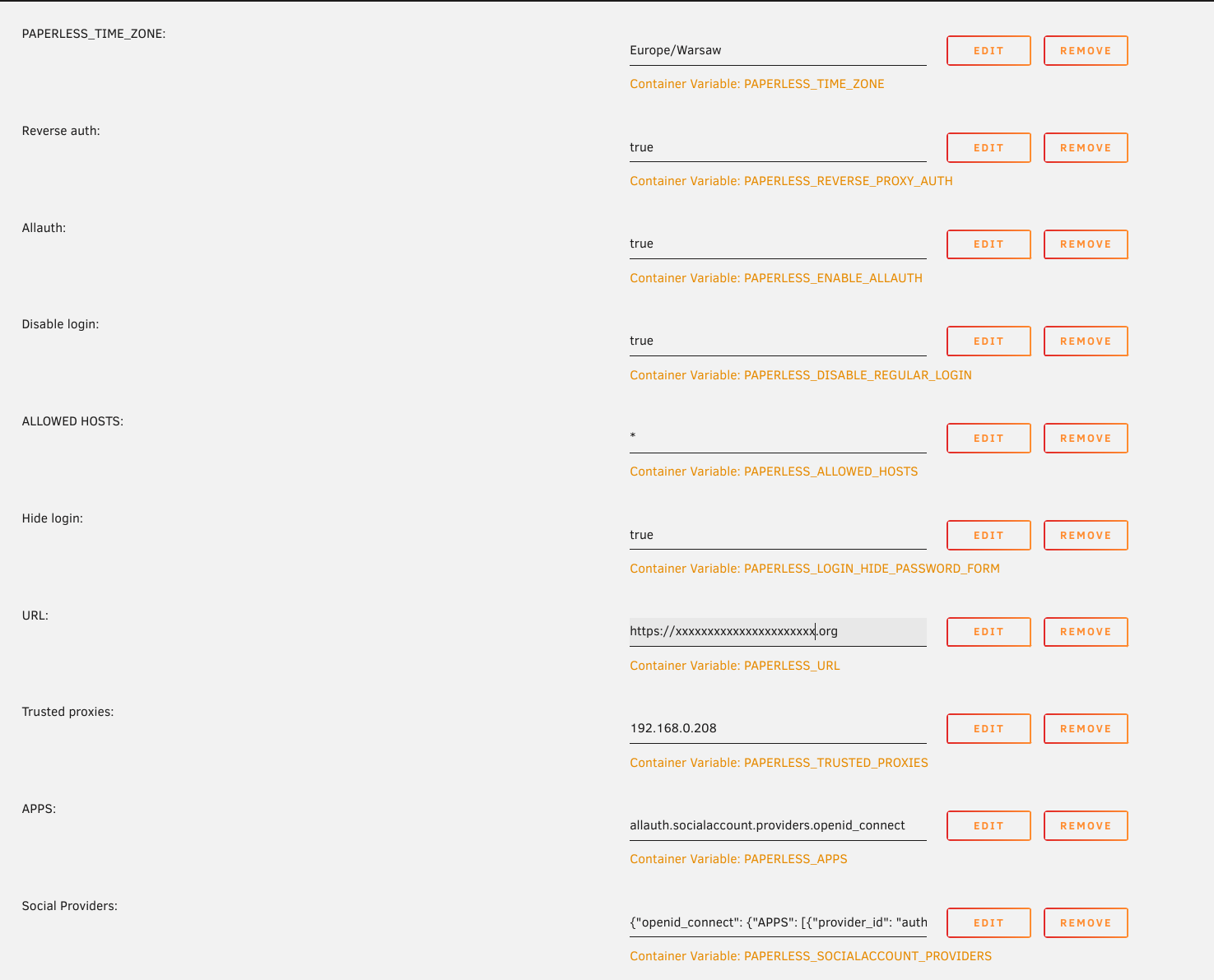

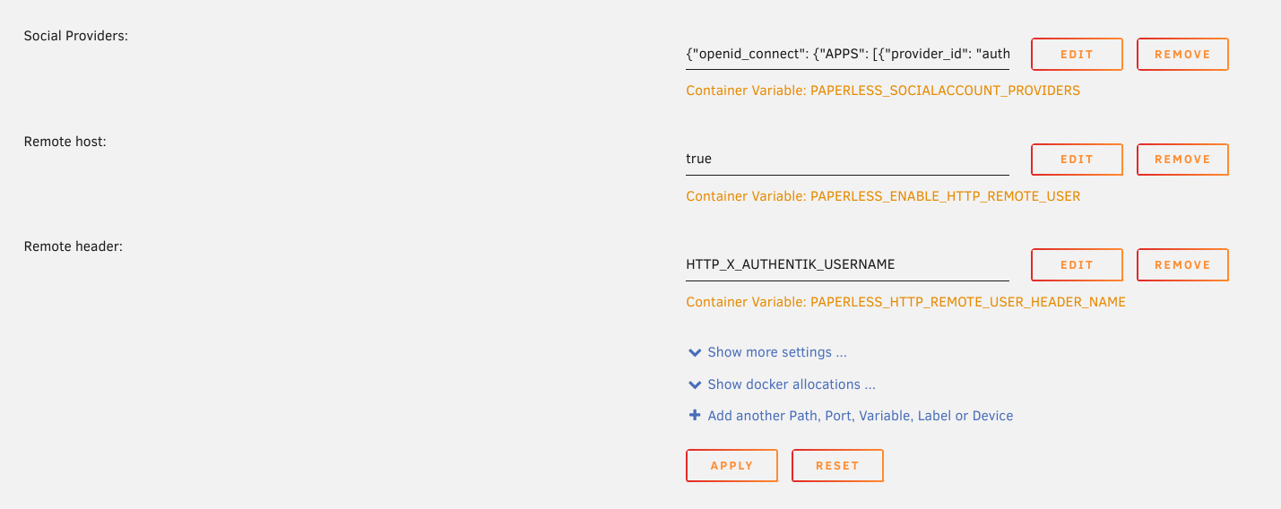

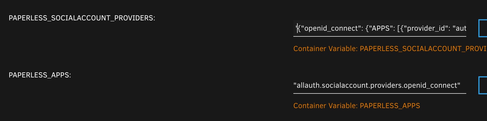

Hi Guys, I have set-up Paperless on Unraid. I used header auth with Authentik. Currently it is possible to use proper SSO with paperless and authentik. I watched https://youtu.be/xO-EVYNinXA?si=nJbh3qQ338oMFTuP  and I noticed I needed 2 environment variables:
PAPERLESS_APPS: "allauth.socialaccount.providers.openid_connect"
and
PAPERLESS_SOCIALACCOUNT_PROVIDERS: '{"openid_connect": {"APPS": [{"provider_id": "authentik","name": "Authentik SSO","client_id": "XX Client ID from Authentika XX","secret": "XX Client Secret from Authentika XX","settings": { "server_url": "https://auth.xyz.com/application/o/paperless-ngx/.well-known/openid-configuration"}}]}}'
so I added the following to the template and removed the previous variables related to headers.
As soon as I start the paperless container is stops again. do I remove the variables, it runs again. If i remove the single quotes, from paperless_socialaccount_providers, the container starts but SSO does not work. What Am I missing here? Someone with a similair set-up to help me out?
1998102724_Screenshot2024-02-23om10_12_54.thumb.jpg.29fe0c82064db56356ae762a1fd9b9d9.jpg
Edit: It would help if someone with the same set-up can share his Unraid template screenshots. I have doubts about if I have the right environment variables. But looking at all responses I must have been te only one running Paperless on Unraid in combination with Authentik.

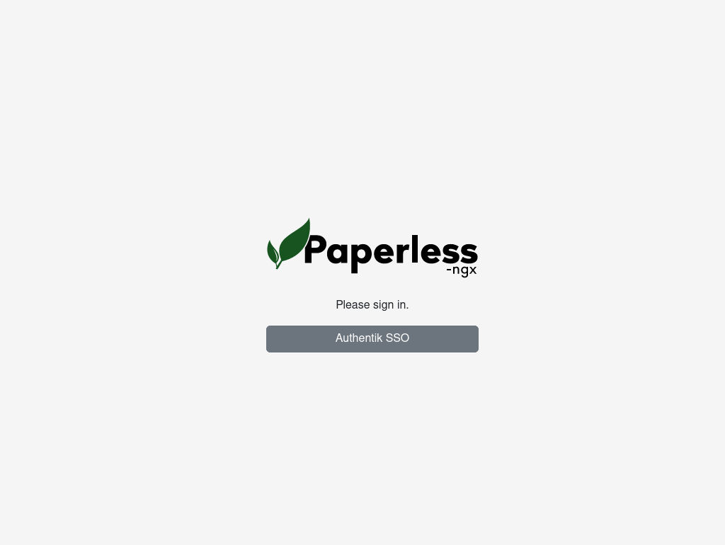

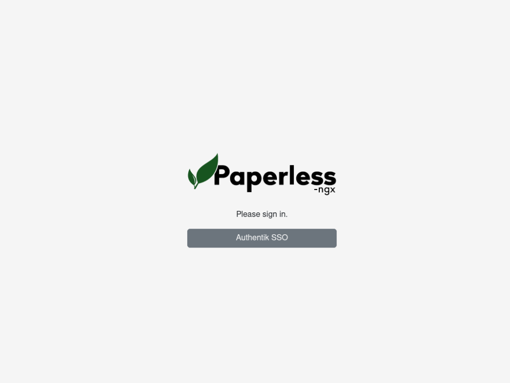

and
Hey, did you find a solution for Paperless in combination with Authentik?
@Mika@MobileDude I have a working setup:
PAPERLESS_APPS=allauth.socialaccount.providers.openid_connect
PAPERLESS_SOCIALACCOUNT_PROVIDERS='{"openid_connect": {"APPS": [{"provider_id": "authentik", "name": "Authentik", "client_id": "YOUR_CLIENT_ID", "secret": "YOUR_CLIENT_SECRET", "settings":{ "server_url": "https://auth.domain.tld/application/o/paperless/.well-known/openid-configuration"}}], "OAUTH_PKCE_ENABLED": "True"}}'
Be sure to name the Authentik Outpost "paperless". In addition, you can set the following variables, once the basics work:
# hide the default login form
PAPERLESS_DISABLE_REGULAR_LOGIN=true
# sign up new users from authentik automatically
PAPERLESS_SOCIAL_AUTO_SIGNUP=true
# redirect to authentik after logout
PAPERLESS_LOGOUT_REDIRECT_URL=https://auth.domain.tld/application/o/paperless/end-session/logout
# trust authentik to provide valid email addresses
PAPERLESS_ACCOUNT_EMAIL_VERIFICATION=none
I hope this helps :)
Hello, I make it work like that:
My unraid template:
