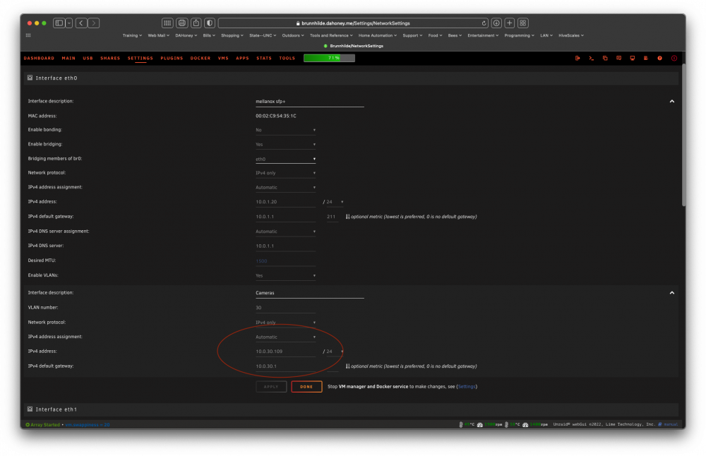

I recently setup a custom docker bridge (VLAN 30) on my unraid server. The bridge works properly but the unraid server gets an IP assignment on the VLAN as well as the LAN.
651205993_ScreenShot2022-03-13at10_18_06AM.thumb.png.e5eef7ab54d7caf54f2d9292f87e8124.png
This is causing the pfsense firewall to assign improper DNS entries which results in warnings from FCP.
How can I stop the server management from getting an IP on the VLAN? I think that will resolve this issue. 🤞
