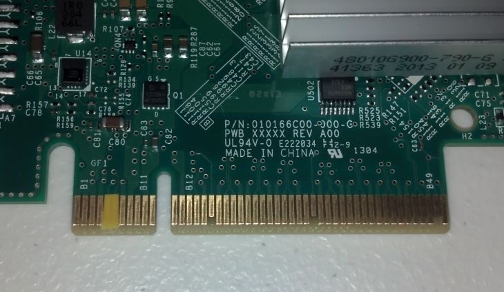

I had many issues trying to get an LSI card to work in an eVGA Classified 3  x58 motherboard 3 years ago because their BIOS and the LSI BIOS uses the same option ROM address space. My plan is to find another system I have that is not a tweaked out overclocker board and use that to flash with. I have some simpler Z68, Z77, B75, 680i LT etc. boards I could use flash.
Any advice on this card would be helpful.

I searched around and came up with smallish 40 or 50mm PWM fan and attached it to the Perc h310 heatsink with a couple course thread machine screws.

I also have a Dell PERC H310, and was having some issues with it. It would boot just fine in my test system (an old Asus P5N-D) but would not boot in either of my newer systems (Asus P7P55D-E Pro or a MSI 970A-G46). I ended up finding this post by MHzTweaker: http://lime-technology.com/forum/index.php?topic=28727.msg256252#msg256252
I ended up having to put a strip of electrical tape over pins B5 and B6 which apparently do this:
The pins you need to mask are:
B5 (SMCLK, SMBus clock) an B6 (SMDAT, SMBus data)
When these two are masked you are blocking the SMBus signals, now they cannot interrupt the boot process anymore. In the past there where only some vague guidelines for this, not real standard, which lead to a variety of different implementations, which in the current time lead to issues with new motherboards who do follow the now current standards.
As soon as I got that electrical tape on, they are booting just fine. Fireball3 posted here: http://lime-technology.com/forum/index.php?topic=12767.msg259006#msg259006 that he was able to flash to P16 firmware. I was not able to do so using his toolset. At the end of this post is a link to my dropbox that has the zip file I used to flash my card to Dell HBA IT firmware. I have also attached a picture of exactly the pins that need covered with the electrical tape.
https://www.dropbox.com/s/4jednhrzbnt2tj6/Flash%20Dell%20PERC%20H310%20for%20unRAID%20-%20Custom%20instructions.zip
