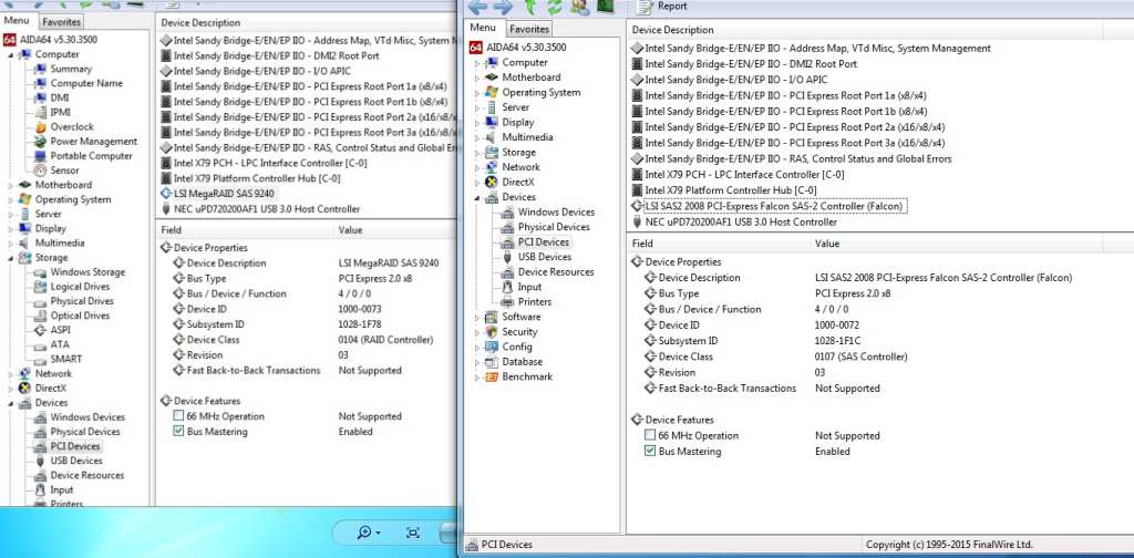

I have the card working with Lsi fw 19 and bios for some days - I used Fireball3 usb files and the only change I did was to flash the 6GBPSAS.FW together with the mptsas2.rom in the same folder. After that I could upgrade to whatever lsi fw and rom I wanted - no more nvdata version mismatch.
Everything seems to work as it should exept for one litte feature that I do not know is supposed to work on the 9211-8i.
I have a test setup with the 9211-8i and the progress with background initialization is as expected taking several hours - now i want to use fast initialization as my final setup will use 4TB drives.
As you can see fast initialization is greyd out and not possible to activate, even though I have a virtual drive the drive is not shown or an option.Fast initialization is not an option in virtual drive properties either - also, if I setup raid in bios there is no option there either.
Downgraded to P9 did not make any change, used several different megaraid storage managers in windows but option is not working.
Wondering it it has anything to with the device id class the card has now, it's listed as sas controller not raid controller as the H310 was.
If anyone has an original 9211-8i I will be grateful if they could check this on their card.
