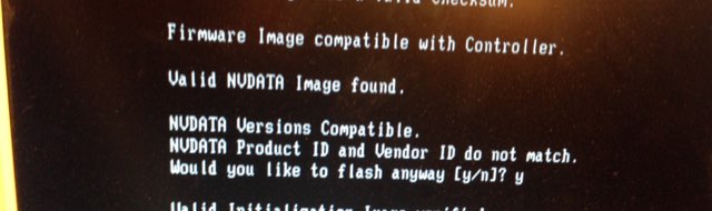

    Thank you all who have contributed to this mamooth information dump. I have tried to follow the instructions in the Wiki to convert my recently acquired IBM M1015 card to LSI SAS9211-8i but the establ
Your fine...my guess it is because your burning LSI firmware on Dell card.  Future flashes with LSI firmware won't show that.

I got an question/massage, see image. I hope it should be OK so my flash went OK [emoji53] don't remember now what step , but is was one of the first step after reboot
I received the same message and most of the sas2flsh utilities won't let you bypass or continue. One of the old versions of sas2flsh will and prompt you with a Y/N, like yours does.
