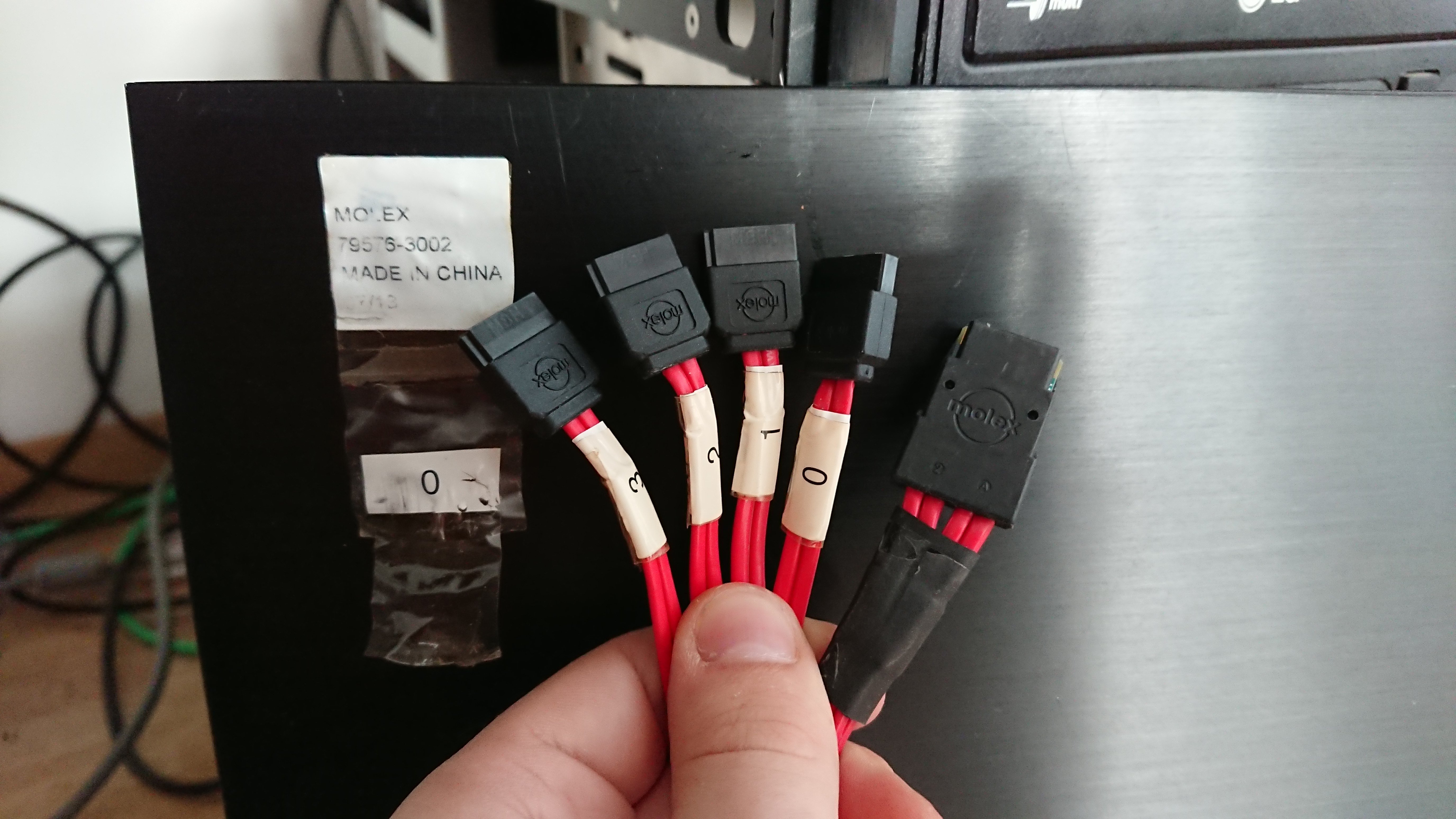

Maybe you can help me with that. The tape on the left side was wraped arround the cable.
The Text says:
MOLEX
79576-3002
MADE IN CHINA
According to google it's reverse breakout, the wrong cable:
Note: This is a crossover cable, not the usual straight-through cable. The 4 x 7-pin connectors are to be connected to controller (host). The miniSAS connector is to be connected to backplane (target).
Thank you, I ordered a new cable and will report back in a few days.

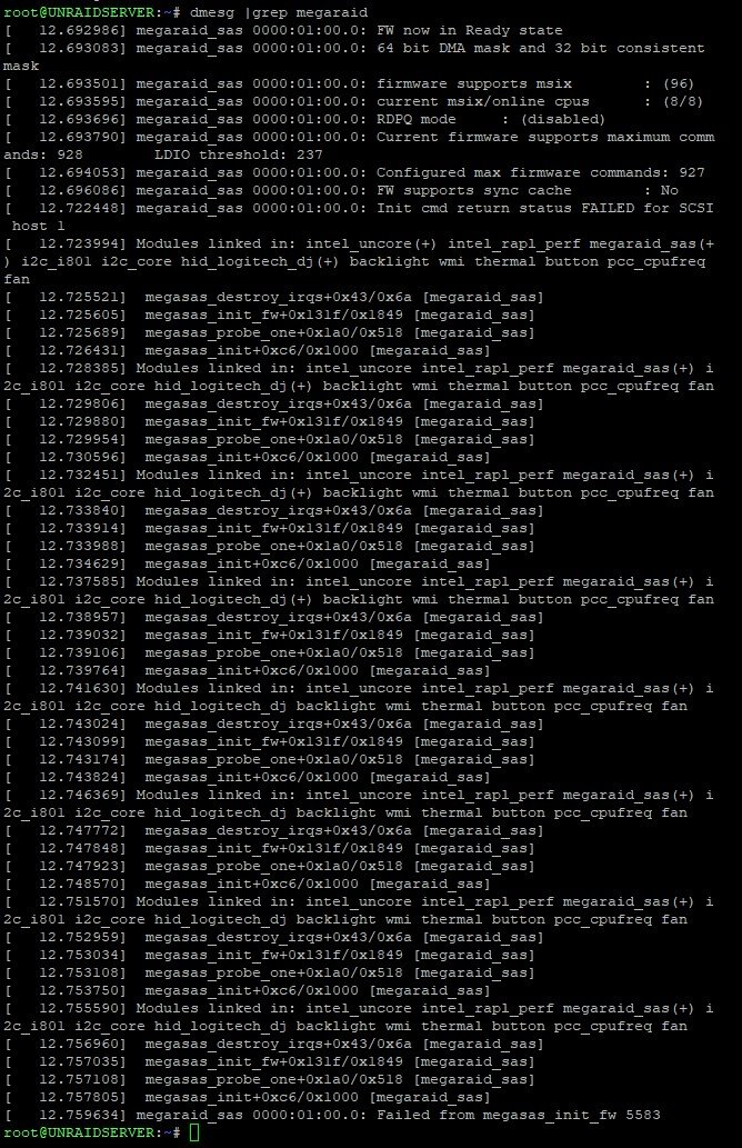

I have a Dell PERC H330 on the latest bios from DELL (May 2018) which I put into HBA Mode via CTRL-R in the card's bios
The Card detects 8 drives (1 SAS & 7 SATA) perfectly.
unRAID detects the card as expected but not any of the drives attached to it
here are some screens from investigations so far, can anyone help? Does this need to be flashed into IT mode?
Many Thanks in advance!
