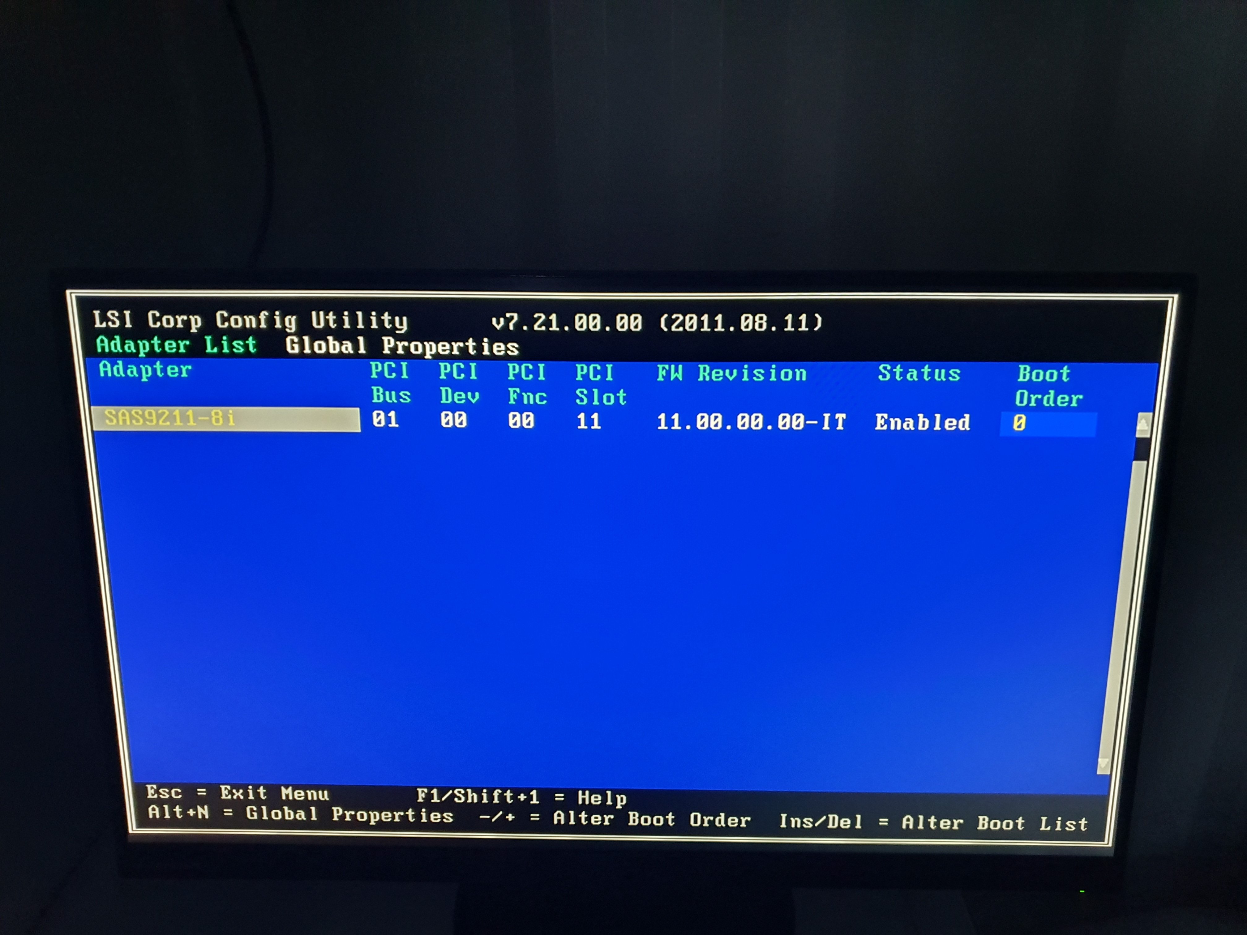

Hi I just purchased a IBM 1015 card and got the PAL issue. So tried the uefi method with same commands but didn't work, so I took and flashed the rom file first and bin file and now the card is recognized. But how do I check it is now converted correct and is in IT mode?
If you're using Unraid post the syslog, it will show there.
Thanks for the answer. I made a picture of it and I think it's It mode, correct?
My question is also should I upgrade the firmware to a newer if there's something better before I start with Unraid or is it okay? If so which one should I use?
Thanks for the help.
Yes.
Yep, that's a pretty old one, latest is 20.00.07.00
Thanks. Should I upgrade it? I need to do it in uefi mode so should I remove the controller before or is it only crossflashing? I would like to update it easy.
I already say yes, you should, UEFI or not depends on the board used.
