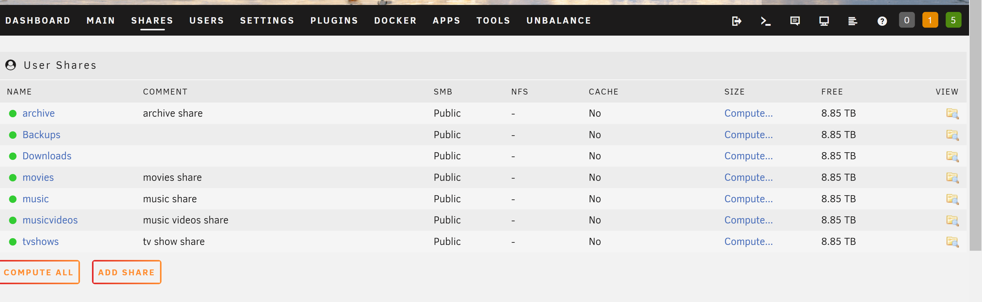

I can not find my appdata folder
I searched everywhere on the forum, and it looks like I should be able to see appdata as a share. I searched all my disks and shares... but I don't see it anywhere.
Have you enabled the docker service?    That share is only auto-created when you do.
why are you looking for that share anyway?
Since I see the docker tab on your screenshot, it seems that it's not what itimpi suggests.

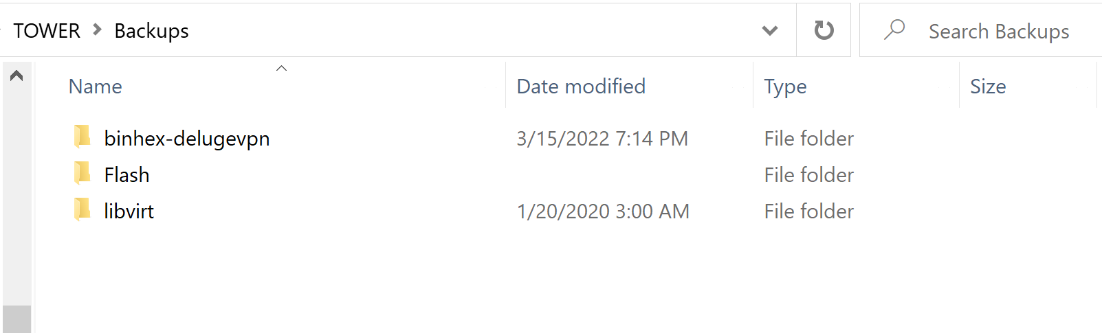

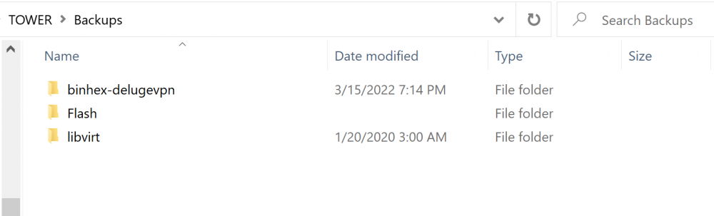

When I enabled Deluge it made a binhex-delugevpn folder in my Backups share, but there still not an appdata folder... is that OK?
tower-diagnostics-20220315-1916.zip
That is because you have configured the docker service to use that location for containers (you must have changed it from the default of using an appdata share).
