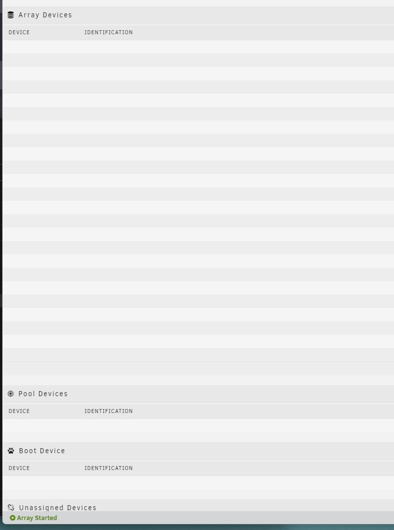

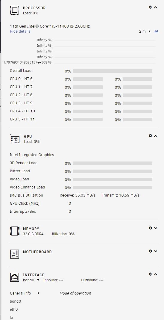

I've noticed pretty much all of my displays/metrics for the Array and CPU/GPU/Interface/Motherboard/etc crash and stop displaying on both the dashboard, and the Array on the Main page. I'm on 6.10.0-rc2, just downgraded from rc3 due to this bug happening and it continues to happen. Just started today.
Everything works fine when this happens, and the array is still up. Fix Common Problems has found nothing wrong at all.
Attached are some pictures of what's going on. If you need any logs, just let me know what you need.

I've pinpointed the issue. It's whenever Mover runs. Fresh reboot, nothing going on, dashboard is running fine.
After running Mover, everything like you see above happens.
Telnet into the server and ran tail:
Mar 17 10:39:27 Conjure emhttpd: shcmd (89): /usr/local/sbin/mover |& logger &
Mar 17 10:39:27 Conjure root: mover: started
Mar 17 10:39:27 Conjure root: mover: finished
Nothing after it, no errors. Just everything you see above in the pictures happens until I reboot.
Any ideas?
