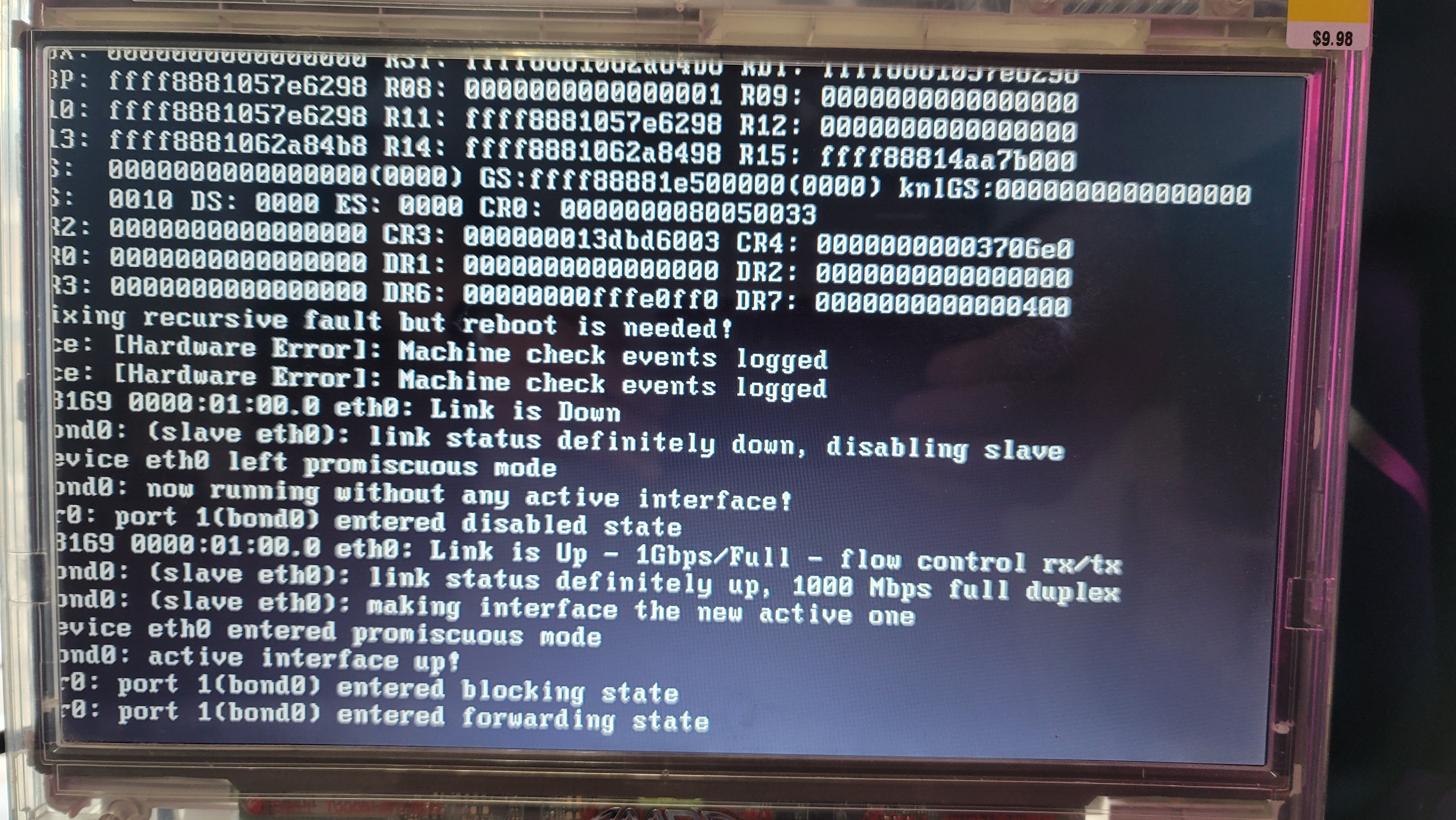

Hello, i just bought unraid and I'm trying to setup my array and i keep getting this error at random "504 gateway time-out) , sometimes i can refresh the page and it will re-connect but eventually  it just stops and i have to power cycle the computer to get access, I was able to save a diagnostic file before it happen  the other day (attached) and i sent one to Lime tech directly through a menu option but I'm not familiar with this software and so I'm looking for away to fix it. i have tried to putty or winscp into the computer to grab a diagnostics but it doesn't connect but i can ping the ip address successfully.  I've tried running this in GUI mode and headless on boot but no difference, i have a screen shot of the monitor after it lost connection today but this was after i was able to preclear 1 - 16tb drive and sync the 16tb Parity and one array drive after running for 2 days and maybe 5-8 GUI quick login checks to see status . I am using preclear to scan my last 16tb drive right now and the light on the drive is flashing like preclear is running but i have no way to check, Does anyone know what the problem could be for me since i see others have had this issue, i have already tried reinstalling unraid on my usb again but made no difference, It does seems to lock up faster the more i use it the gui

I rebooted the computer after preclear was done today and download a new syslog and the diagnostic log, i installed some plugins and i also noticed when i booted unraid in gui mode , it just shows the gui main interface for a few seconds then disappears and just shows the unraid background image. if i keep 2 windows open on my desktop, 1 on the syslog and use the other to select menu items if the connection is lost or the browser window freezes where i can not click on any buttons on the gui i can use the other window on syslog to navigate to another tab, this works for awhile but eventually it will go down. I setup a 2nd test unraid server using my dell vostro 3070 tower connected to the same network and ran the Fix common problems app and the big difference is the test unraid doesn't show the error below:
Machine Check Events detected on your serverYour server has detected hardware errors. You should install mcelog via the NerdPack plugin, post your diagnostics and ask for assistance on the Unraid forums. The output of mcelog (if installed) has been logged  More Information

Hi there,
Something is definitely amiss with your hardware.  The type of issues you're experiencing are definitely not software bugs, as they would be affecting a much wider group of users if that was the case.  Machine check errors are indicative of physical hardware problems.  Since this is a Dell, I'm assuming it came pre-assembled.  Did you then add a bunch of additional hardware to that base system?  I'm curious if that machine doesn't have sufficient power or cooling to support all that gear.  I wish I had more insights for you, but unfortunately when it's hardware, its very difficult for us to assist, but the first thing I would try is to detach that eSATA solution you're using.  Try without that and see if you can maintain connectivity and stability.  If so, there's your problem.  If not, keep reducing the gear until you get to stability.  If you can't keep the system stable and accessible with any devices attached, that is a strong indication of problems with the underlying electronics.
