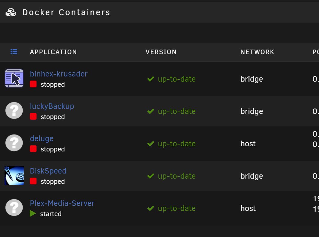

does plex slow down docker tab and create ? icons
i know i asked before for my 1 server... but i noticing it again on another server  my sister has
5 docker apps  only one running is plex...    docker takes 1 min or so or so to load.. and it gets ?
is plex the cause of this  as i have same issues on my own server
i personaly think  something wrong maybe plex does something?  i also asked but no one ever answered...  should Plex Appdata go on its own SSD  away from the appdata for other apps
and i having troubles  "stopping the plex container too"  just spins but doenst actually shut down..

The reason for the question marks (and the slow loading) is that the docker and dashboard pages when loading and gathering the information for the various apps attempt to download the icons for them.  Once it succeeds, they are stored within the docker image and never downloaded again.  Your system is failing to download them
I'd suggest trying to set a static DNS address of 208.67.222.222 and 208.67.220.220 within Settings - Network settings as your server / router is having issues resolving the URLs
what information..... so then  when i cut the internet then   docker  will always be slow then.. cuz it cant gather internet info..
as i found  if i bog the internet down..  docker takes more then a minute every time...   but as soon as i unbog the internet  it goes fast...
but when i re bog the internet.. and click docker  its back to slowness
and you said ?  goes away once its downloaded and stored never downloaded again.. that cant be true
those above apps were installed 9 months ago or longer..  so if its stored  it should never  ?  show up
what i found is
internet bog down..  click  docker   takes more then a minute  and ?  shows up
unbig the internet  click docker   takes a few seconds and the ? are gone
rebog the internet  click docker  takes  more then a minute  and the ?  are back...
they didnt save ..
and now the 1 app says 9 months ago and other onese say it was created 19 hours ago.. so i totally confused
