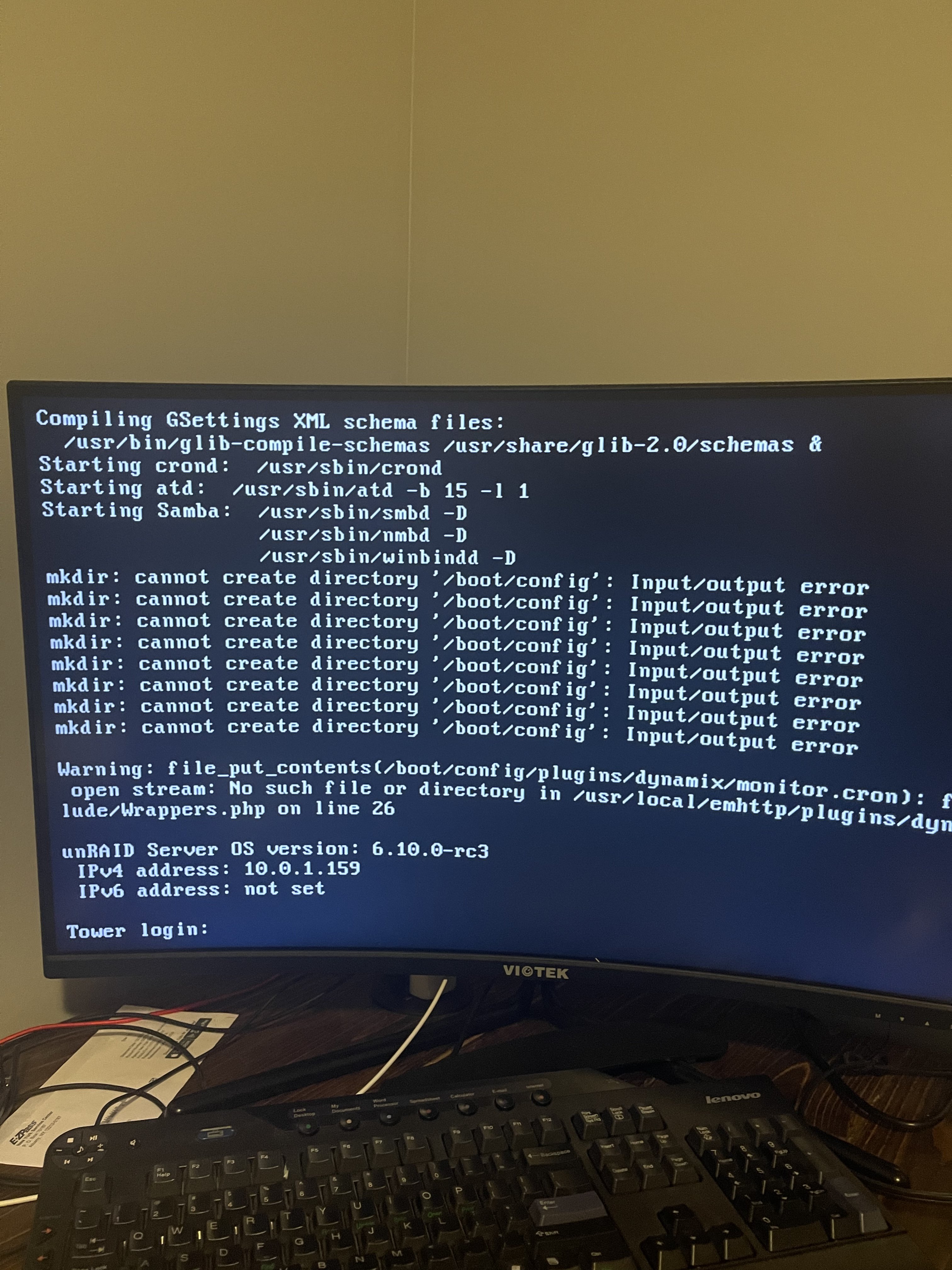

Please help me with this. I upgraded and regret doing so. at first I upgraded then I lost my VM‘s resolutions only display 600X800. Now I have a bigger problem. My server doesn’t seem to reboot correctly it has a bunch of errors , the log in Ip changed and I can’t access anymore. please see the attachment picture. I don’t know what to do
That looks like a flash drive problem, try redoing it.

You can access array drives outside the array, that's kind of the point of the whole unRAID setup. Connect directly to each drive from any linux box until you find the drive that has the most recent backup.
