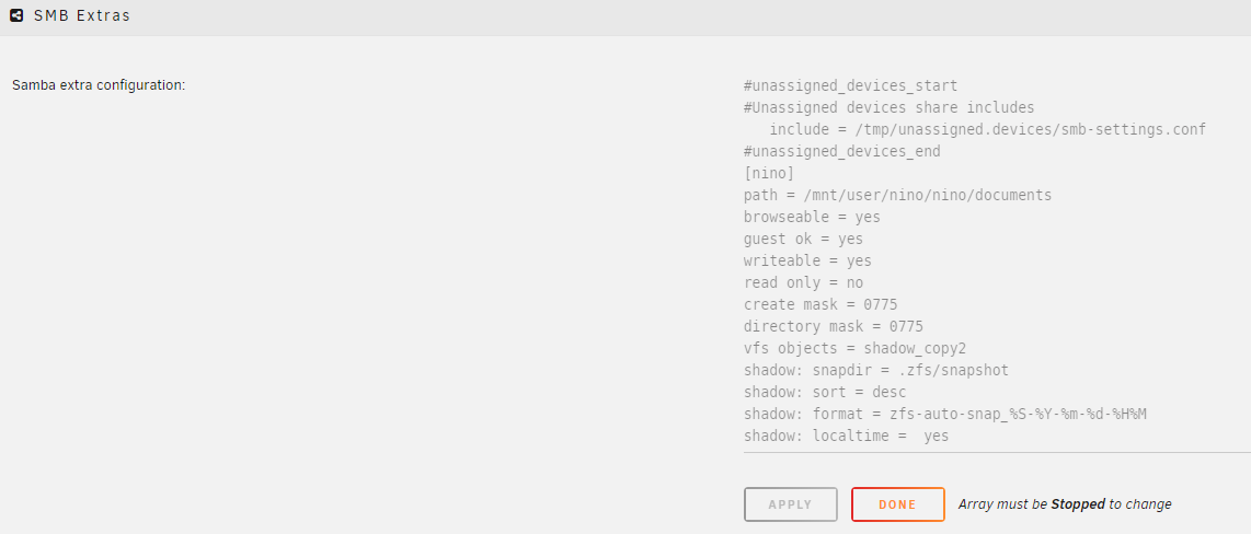

March 18, 20224 yr Hello all, I've setup a new Unraid server with a shared forlder in ZFS, but I cannot seem to get the Shadow Copy working. I followed this guide (https://forum.level1techs.com/t/zfs-on-unraid-lets-do-it-bonus-shadowcopy-setup-guide-project/148764) for my setup, with my own alterations ofcourse! I will attach some images of the file structure and config. The shadow img shows the previous version tab in W11, for a file in my 'nino/documents/' folder. The smbconfig shows the config in the extra options of SMB settings. The snaps shown in the last image, show the files in 'nino/documents/.zfs/snapshots/'. <a href="https://imgbb.com/"><img src="https://i.ibb.co/hBg6q7C/shadow.jpg" alt="shadow" border="0"></a> <a href="https://ibb.co/X7GYfNP"><img src="https://i.ibb.co/D9jrPsF/smbconfig.png" alt="smbconfig" border="0"></a> <a href="https://imgbb.com/"><img src="https://i.ibb.co/9nVnfsh/snaps.png" alt="snaps" border="0"></a>

April 23, 20224 yr On 3/18/2022 at 5:19 PM, NytoxRex said: The images: Does "cat /etc/samba/smb-shares.conf" for nino have the correct settings? as this is the file samba will be using.
June 23, 20224 yr Author Okay I've checked the "/etc/samba/smb-shares.conf" and the settings in there were incorrect. I have changed these settings, as can be seen in the image. I've removed the %S as seconds, as the 01 in the names is the 'label' attribute set to 01 in my script. I've also added the write list and valid users, all of this without any luck. I have also added the structure of the folders as an image, might be helpful.

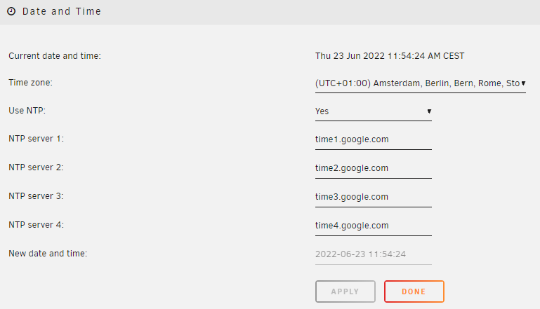

June 23, 20224 yr Author Quick remark, time is an issue. I just did a run of the sript again at 11:52 and the latest snapshot gives the following. The time in the unraid GUI is correct, so this is a incorrect setting of the time in the creation of the snapshots. Though, i dont exactly know where the time difference is coming from, and weather it affects the workings of previous versions in windows.
June 23, 20224 yr Author I think the -u flag in this line in the zfs-auto-snapshot.sh script changes the time to utc, so either this script has to be changed or local time disabled in the "/etc/samba/smb-shares.conf" settings if I'm correct. (The latter has been done now the config is: Quote [nino] path = /mnt/user/nino comment = browseable = yes # Private writeable = yes read list = ndreverman write list = ndreverman valid users = ndreverman read only = no create mask = 0770 directory mask = 0770 vfs objects = shadow_copy2 catia fruit streams_xattr case sensitive = auto preserve case = yes short preserve case = yes shadow: snapdir = .zfs/snapshot shadow: sort = desc shadow: format = zfs-auto-snap_01-%Y-%m-%d-%H%M shadow: localtime = no Edited June 23, 20224 yr by NytoxRex

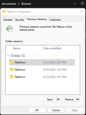

June 23, 20224 yr Author Changed the path to "path = /mnt/user/nino/nino" to include the symlink, and it works now! sort of... The first image shows the directories working, which is great, but when diving into the four directories none of the files have previous versions... I wish I could have all individual files included as well, such that a single file can be restored. How is this done, seems like a simple -r (recursive) flag or something.

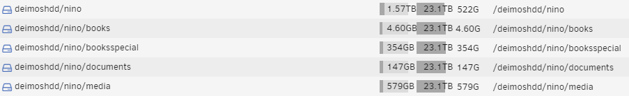

June 23, 20224 yr Author So here is the problem (likely), the snapshots generated by the deimoshdd/nino/documents is stored in deimoshdd/nino/documents/.zfs/snapshots, while the config of the share nino (mnt/user/nino/nino = deimoshdd/nino) makes it search in the given mnt/user/nino/nino/.zfs/snapshots which is equal to deimoshdd/nino/.zfs/snapshots. Of course there is nothing to find, as only the sub folders (or datasets) are flagged to use the snapshot feature. Now I *could* make a different share for each of the folders, but I would not like to do that, I just want one folder (share) that is used for a single person. Thus there are two options left: 1) The samba config is configured that it looks in all subfolders for the .zfs/snapshots folders. 2) The snapshots are stored in a the parent folder in its *parent*/.zfs/snapshots and not in the *parent*/documents/.zfs/snapshots Is there a way to do either one of these? I think this is the problem. Thanks!

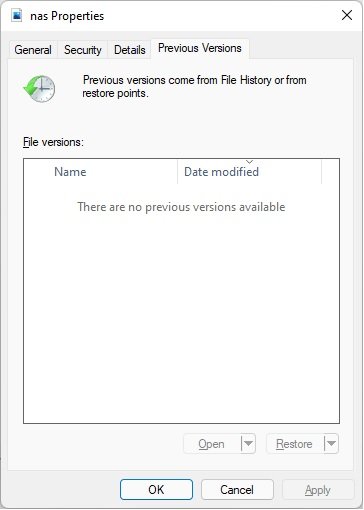

June 23, 20224 yr Author Great! I found the solution and it's working almost perfectly now! I just had to add the line Quote shadow:snapdirseverywhere = yes to the "/etc/samba/smb-shares.conf" file. Easy, i would say. The only problem left is that only folders show the previous versions tab, not files. Visible in the two pictures are a folder (with prev. vers.) and a file in that folder (missing prev. vers.). If anyone knows how to fix this and make the system perfect, let me know!
June 26, 20224 yr Indeed, your ZFS snapshots can't be directly used on a file instead of passing through the Folder GUI. I'm not stating that it's impossible, I'm looking what can be done.
June 26, 20224 yr @NytoxRex Did a test, and the "Previous Versions" is less dumb and display a result only if a modification is detected, else, there would be no result. Please, share your actual config, for the others to help you proceed to diagnostic. My own config is quite simple, but might probably help: [Documents] path = /mnt/fastraid/Documents/ browseable = yes guest ok = no writeable = yes read only = no create mask = 0775 directory mask = 0775 write list = margaux valid users = margaux strict sync = yes vfs objects = shadow_copy2 shadow: basedir = /mnt/fastraid/Documents/ shadow: snapdir = .zfs/snapshot shadow: sort = desc shadow: format = %Y-%m-%d-%H%M%S shadow: localtime = yes Edited June 26, 20224 yr by gyto6
July 21, 20224 yr Author Oh I see now, indeed the file needs to be changed, otherwise it will not show up. Thanks all for the help!
