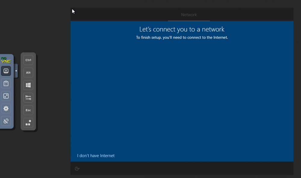

I've created a new windows 10 VM in unraid 6.9.2 and am in the middle of installing windows 10. I have the virtio ISO attached and have loaded the drivers for the hard drive. After the W10 VM boots and the installation begins, this installation requires access to the internet to finish off and connect / join / login with a Microsoft account. But, for some reason the network drivers aren't picked up from the ISO, and I get the error below.image.thumb.png.ac623bfbc901972d40b955bab6648d08.png

I like to create VMs to mess around and test things, then delete them when I'm done - I don't really want to be doing either process above every time I need a fresh W10 VM! Is there any way to bring up some kind of a driver load screen during the installation to load the network drivers and avoid either one of the 2 methods above? Cheers.
