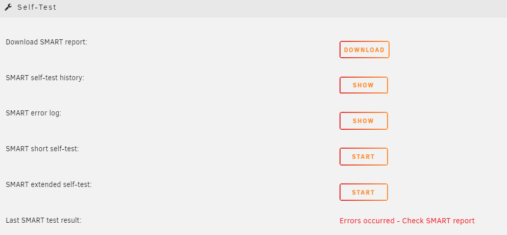

I have started an extended self-test on drive 23 as suggested, I will post the results when it finishes along with a new diagnostic.

On 3/19/2022 at 3:05 PM, kysdaddy said:
It says errors occurred posted diagnostic.
SMART test failed, disk should be replaced.
