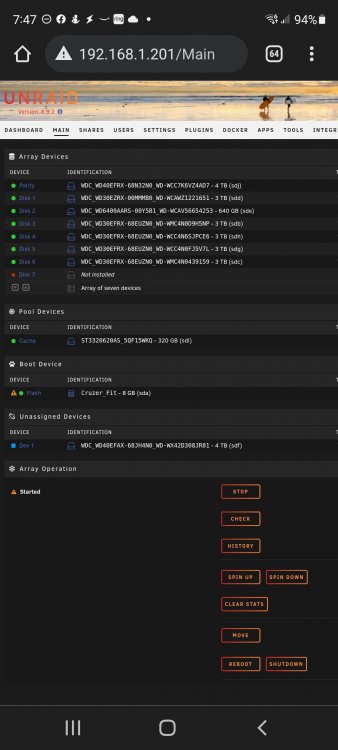

So, Disk 7 is listed as disabled...  I *think* the Parity drive is now virtually supplying data.  I don't seem to be able to get a good smart report off the drive...  What should I do next?
Diagnostics attached...

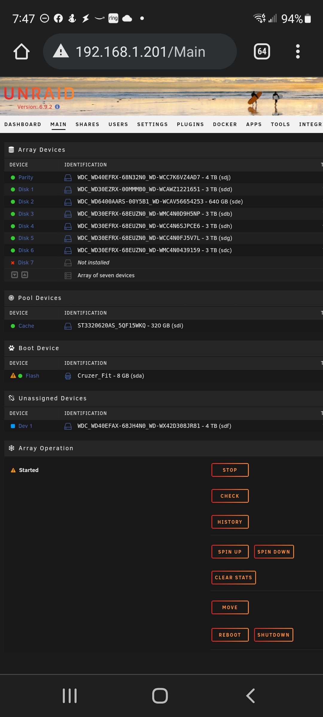

Great!  Put drive onto a different sata controller, and now it shows up, but isn't on the array...  Can you help me make sure that I get it added back to the array correctly?

Current SMART report for the drive in question attached...  Waiting for further guidance on how to get this drive back into the array (or whether we even should at this point...)
