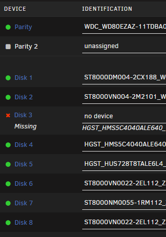

When the server booted, the array didn't start and it shows:
So, if you would, please have a chat with my server and let it know what it's supposed to be doing. TBH, that does make sense that it should have started the array with a missing disk. However, it didn't and here we are...

huh... After poking through a variety of settings, the Main screen is now showing the drive is there.
I would like to know if I did something (I looked at settings but didn't change anything) or if it's just a matter of time before it'll notice that the drive is now available.
