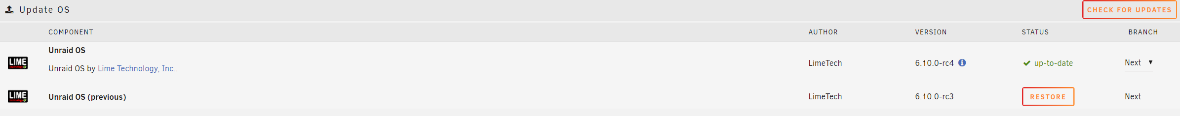

Suspect out of tree driver has an issue on your system. If you revert to rc3 does it work?
rc4 added oot: added Intel ixgbe: version 5.14.6

Yes copy the bz files from RC3 zip. If you upgraded from RC3 you should have an option to revert to prev, but it will show 6.9.2 if you upgraded from that or nothing if a new install.
Thanks!
But I cannot access WebGUI so I need to do this manually. Where can I download prerelease versions?
EDIT: Or can I only download the version 6.9.2 and update to rc3 afterwards?
Edited by CaptainSpalding
Now it has network!

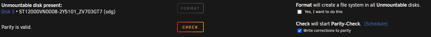

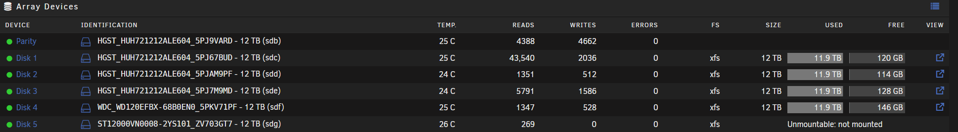

But what does this disk 5 is doing? It shows green but is not mounted?
I did format it and added it to array previously. And even moved files to it just couple of days ago.
Now unRAID offers me to format it again...
Diagnostics say:
root: mount: /mnt/disk5: wrong fs type, bad option, bad superblock on /dev/md5, missing codepage or helper program, or other error.
EDIT: After all that I updated to rc3 and now it says:

Looks good, right?
Check Filesystem Status
xfs_repair status:

Run it again without -n or nothing will be done.
I took the "-n" off and looks same?
Should the check be this fast (max 2 secs)?

Should be fixed now, just start the array normally.
Now it wants to rebuild parity. Is that what I should do?
Tht does not sound right, but maybe posting a screenshot and new diagnostics might allow us to see why.
Disk5 as unassigned, array was started, then assigned again, so now Unraid wants to rebuild it, why did you do that?
