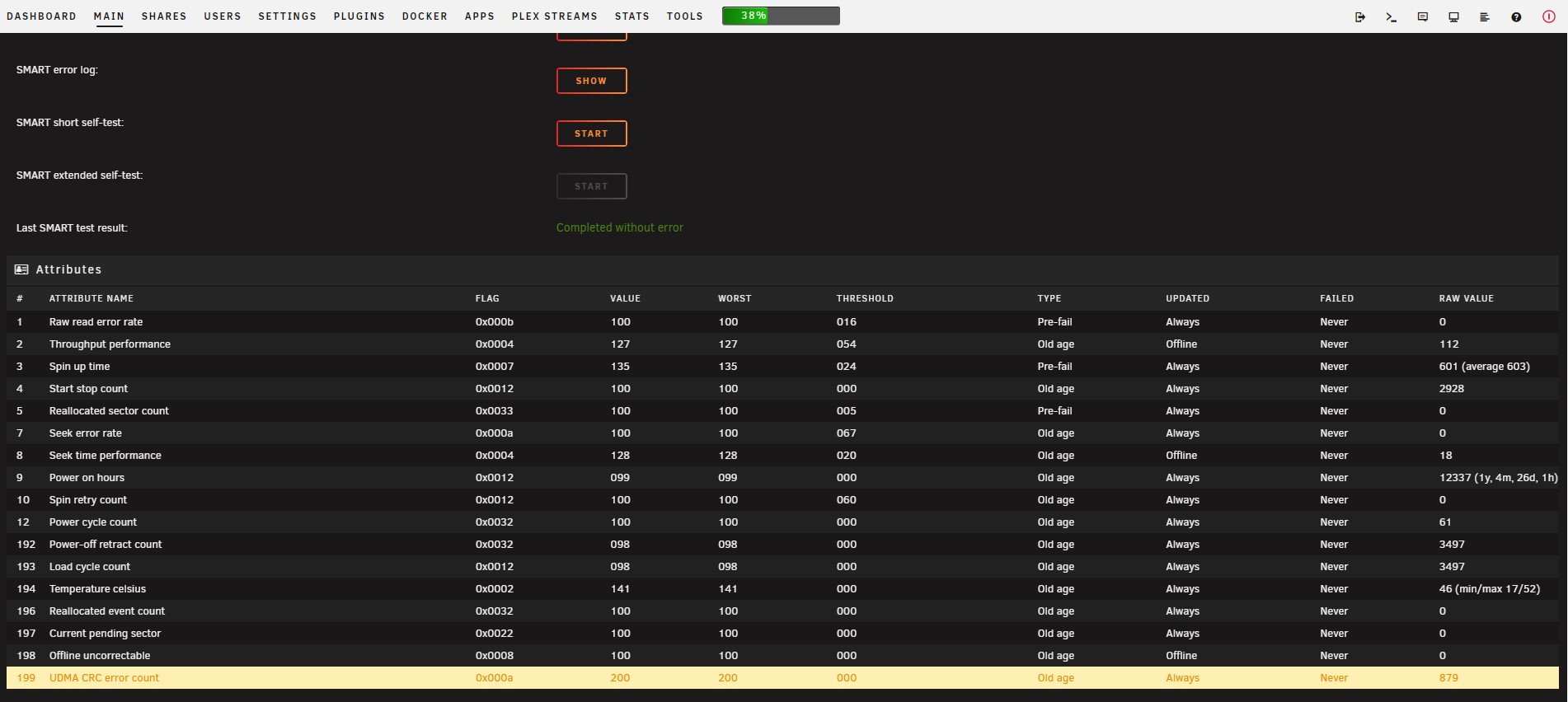

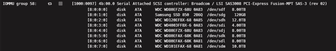

Just curious if anyone could shed some light on why I'm getting UDMA CRC errors from only one disk, a WD Red Plus 10TB, attached to an LSI Broadcom 9300-8i SAS HBA card in IT mode. I'm using two CableCreation Internal HD Mini SAS (SFF-8643 Host) cables to attach them to seven disks. I don't remember what firmware is on the card, but I flashed the card about 2 years ago when I built the system.
I forgot to screenshot the logs of the errors, but they are coming in only after the disks are awakened for a SMART check.
I rebooted the system and more errors came. The errors were at 777 and now they're at 879. No other disk is showing these errors.

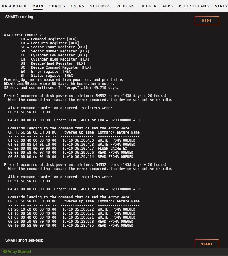

I finally got new .5 meter cables, installed them, and after a while I got a UDMA CRC error on a completely different disk; Disk #6. I didn't change what cable connects to which disk. I also blew out all dust I could find in my system then re-inserted every cable firmly. I even pulled my HBA card and did the same thing.
The error count only went up to 2.
The other disk has yet to get another UDMA CRC error, so at least that one is good now.

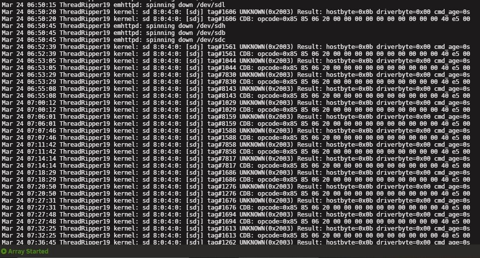

I'm also getting these errors:
Mar 25 17:41:35 ThreadRipper19 kernel: sd 8:0:4:0: [sdj] tag#1716 CDB: opcode=0x85 85 06 20 00 00 00 00 00 00 00 00 00 00 40 e5 00
Mar 25 17:46:34 ThreadRipper19 kernel: sd 8:0:4:0: [sdj] tag#1666 UNKNOWN(0x2003) Result: hostbyte=0x0b driverbyte=0x00 cmd_age=0s
No idea what those are. I've never seen that error before.

@JorgeB, any thoughts as to what is going on the disk (sdj) in the above post?
