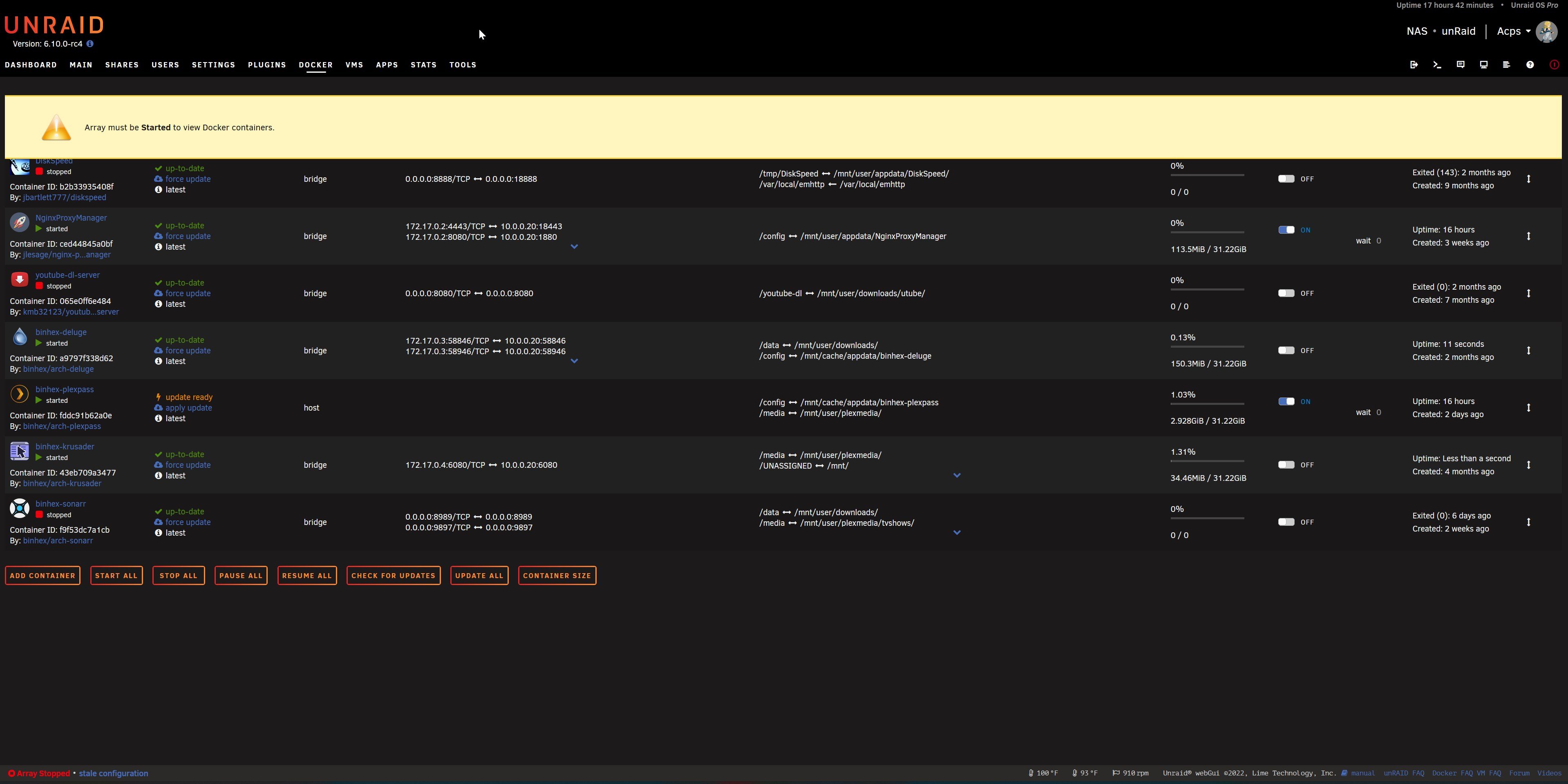

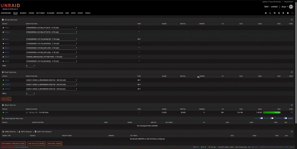

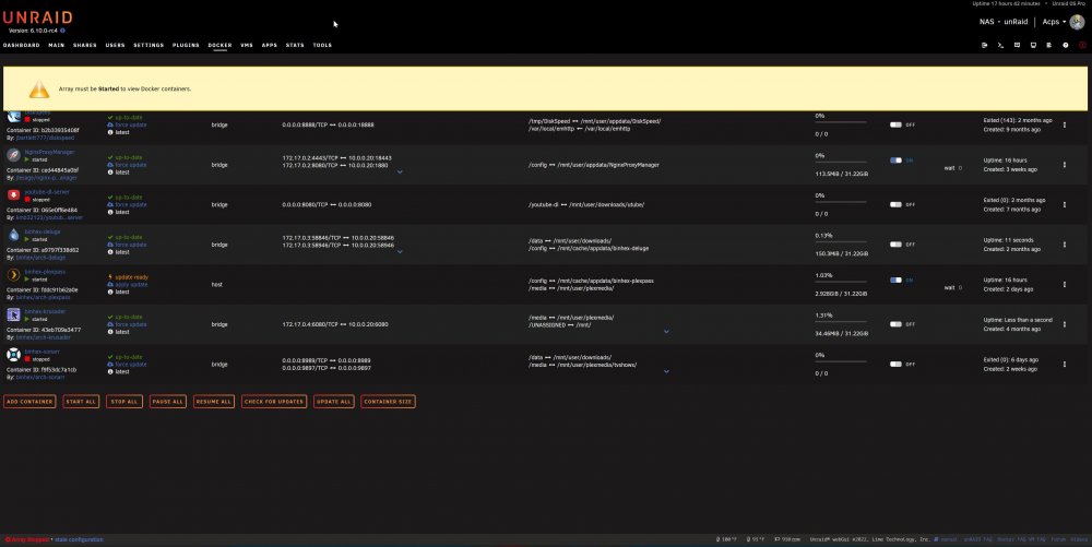

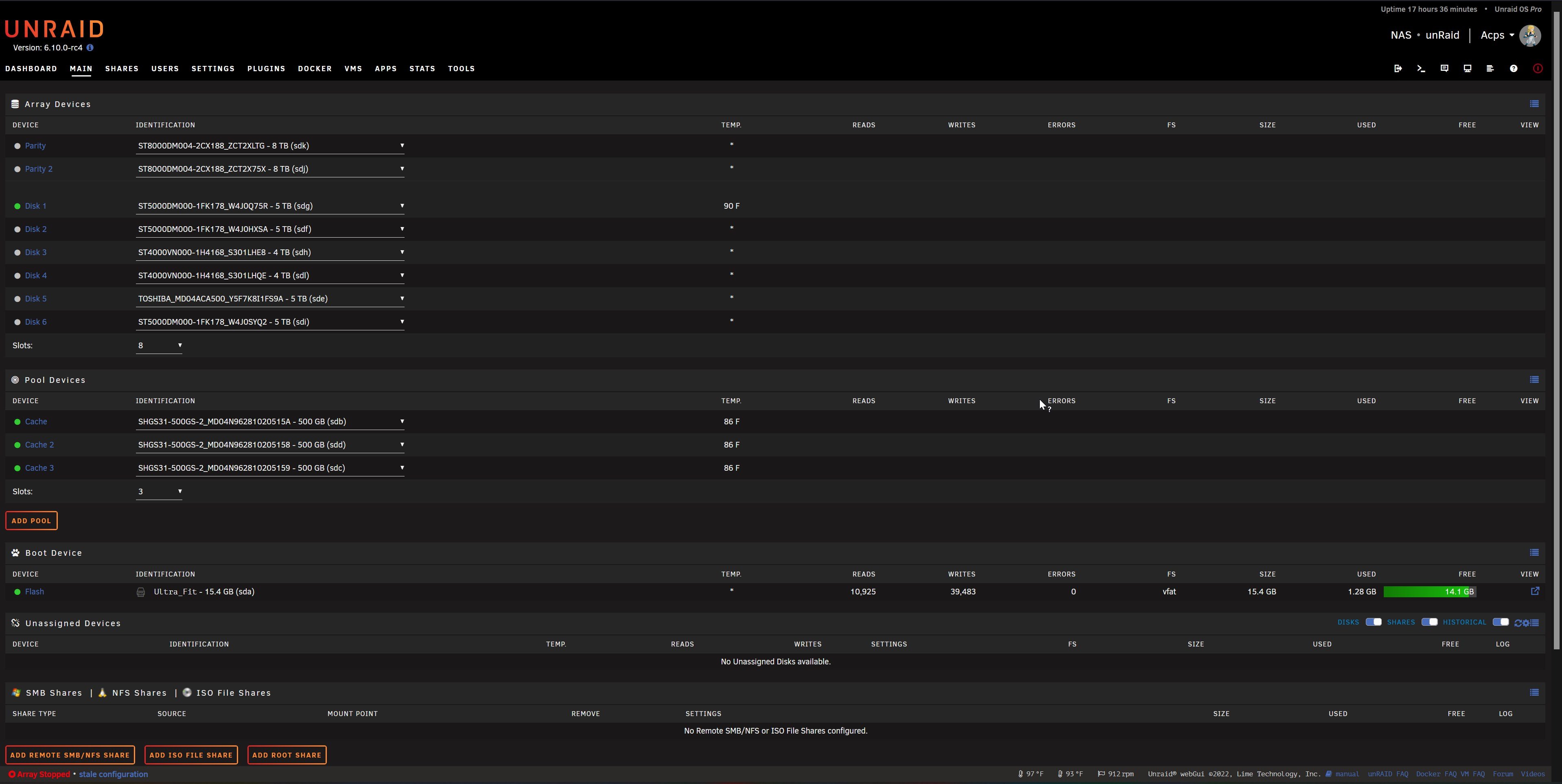

March 22, 20224 yr Author Couple other things that are happening now: Server no longer accessible by https://unraid/ It instead returns a white page with an error 404 Not Found - nginx Using http://unraid/ does work and looks to be using ssl too. Using static ip instead of hostname doesnt help. After starting successfully starting array, Array while change on the Main tab to say Array Stopped - Stale Configuration Dockers are still running and usable, and shares are available however... another diag unraid-diagnostics-20220322-1420.zip ~Acps

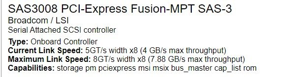

July 15, 20224 yr Author So for several months I dodged this issues by moving my lsi card to another pci slot that wasnt x16, i wanted to tackle it again and worked on it a bit this week, i found that I was able to stop my bios from hanging and not posting by deleting the LSI bios rom on my card, leaving just the IT firmware on it. So i no longer need to worry about it hanging if i reboot it remotly. However I still struggling with my lsi card and booting with my disks are still 50/50. I believe it has to do with my bios setting pcie gen set to auto. My card is in the top pcie slot which is def x16. But it never shows after boot that my link speed is ever at pcie3, its always at pcie1. If i go and mess with the bios and try to manual set the pcie speed to gen 3, my disks never boot. If i leave it to auto it will usually boot without disks the first time, im guessing cause it tried to do pcie3, and if i reboot without touching the bios, it boots with the disks in pcie1. Right now i figured that i can manually set the pcie2 in the bios and it seems to come up with my drives. I have both parity and every array disk on the controller, and my ssd/caches using the onboard sata ahci controller. Btw the cache drives boot 100% every time. I have run out of ides though, do i have a hardware issues or is this a bios setting i seem to be overlooking? I have reset to default and it hasnt helped. I will attach some diag, one will be when the drives failed to boot and the other when the drives do boot. If anyone could take a look I would appreciate it! ~Acps unraid-diagnostics-20220715-1359-nodisks.zipunraid-diagnostics-20220715-1439-yesdisks.zip

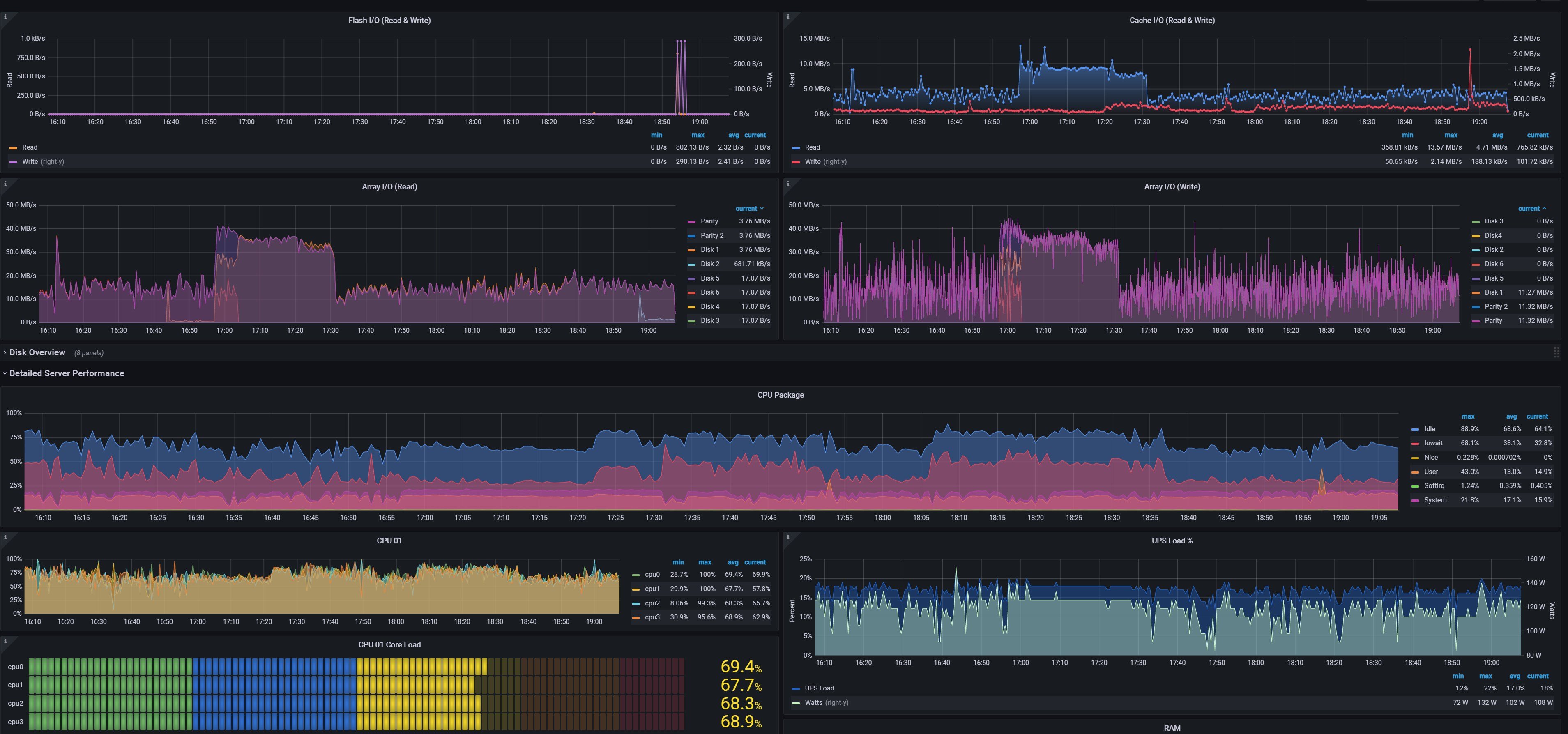

July 15, 20224 yr Author As a result my mover is struggling to get things off my cache and onto the array, it has been running for 4 hours and is only half way:
July 16, 20224 yr Community Expert That looks like a board/BIOS issue, probably not much you can do other than replacing the board.
