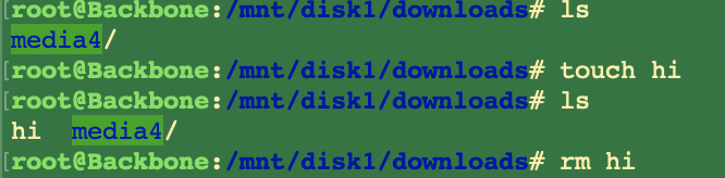

going direct to /mnt/disk#/ did allow for a write (ie touch).

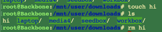

the failed touch against /mnt/user/
the successful touch against /mnt/disk1/

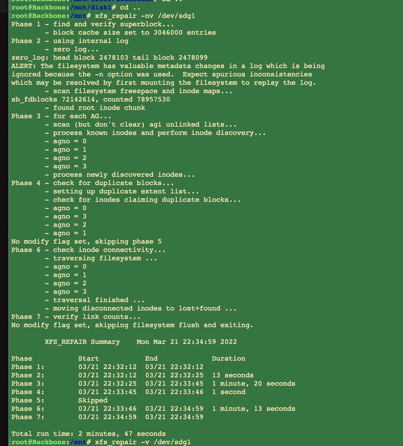

xfs_repair no-changes dry run

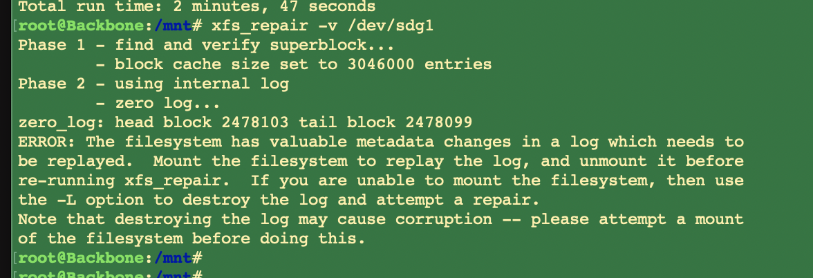

xfs_repair for-real showing the same error seen in the attached threads

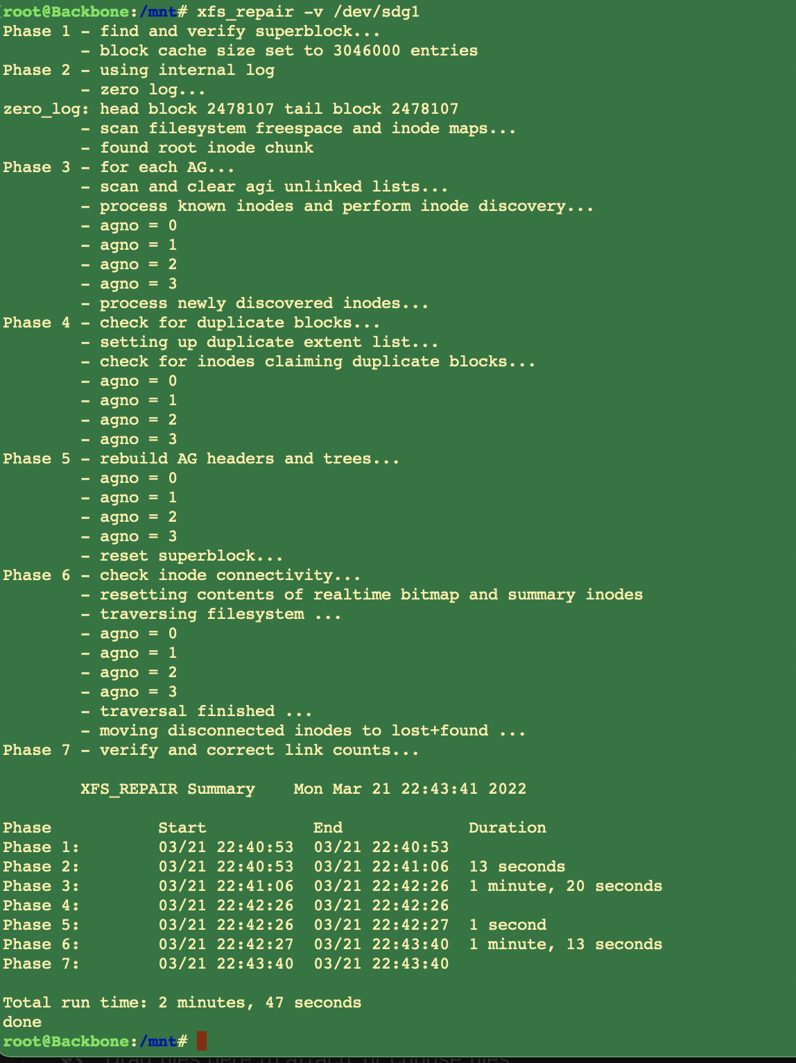

xfs_repair for-real running w/o error **
** I started the array in maintenance mode in order to get the xfs_repair to run w/o error.

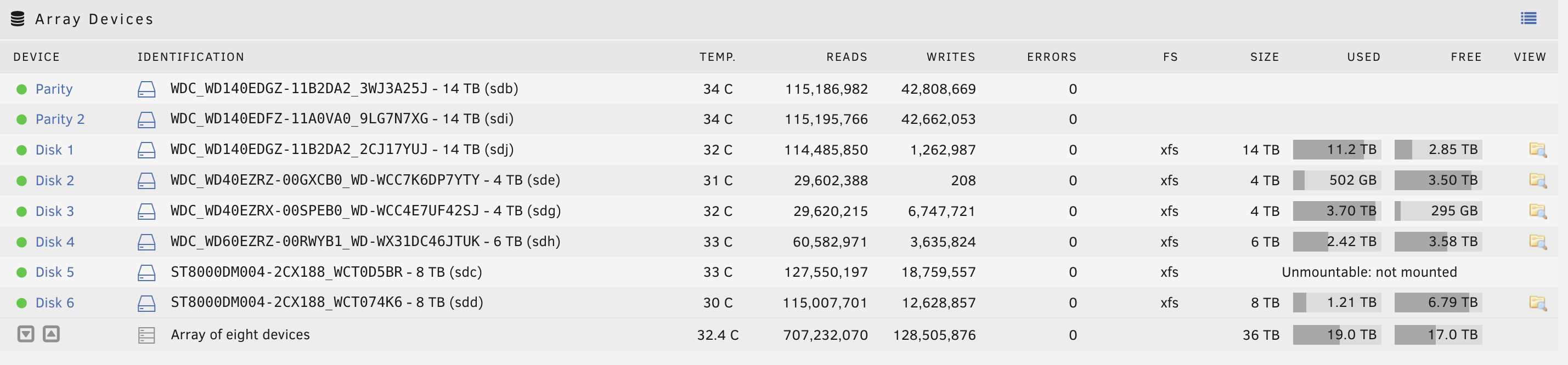

I noticed that one of my disks (not the failing disk) was showing as "Unmountable: not mounted"
backbone-diagnostics-20220321-2214.zip

Bit of the opposite issue with the disk5/sdc1 disk.
I could run repair in dryrun mode, but got the same 'valuable metadata changes' error when trying to run live. couldn't mount the disk as described. opt'd for the 'last resort option and used -L
That's common and usually fine.
