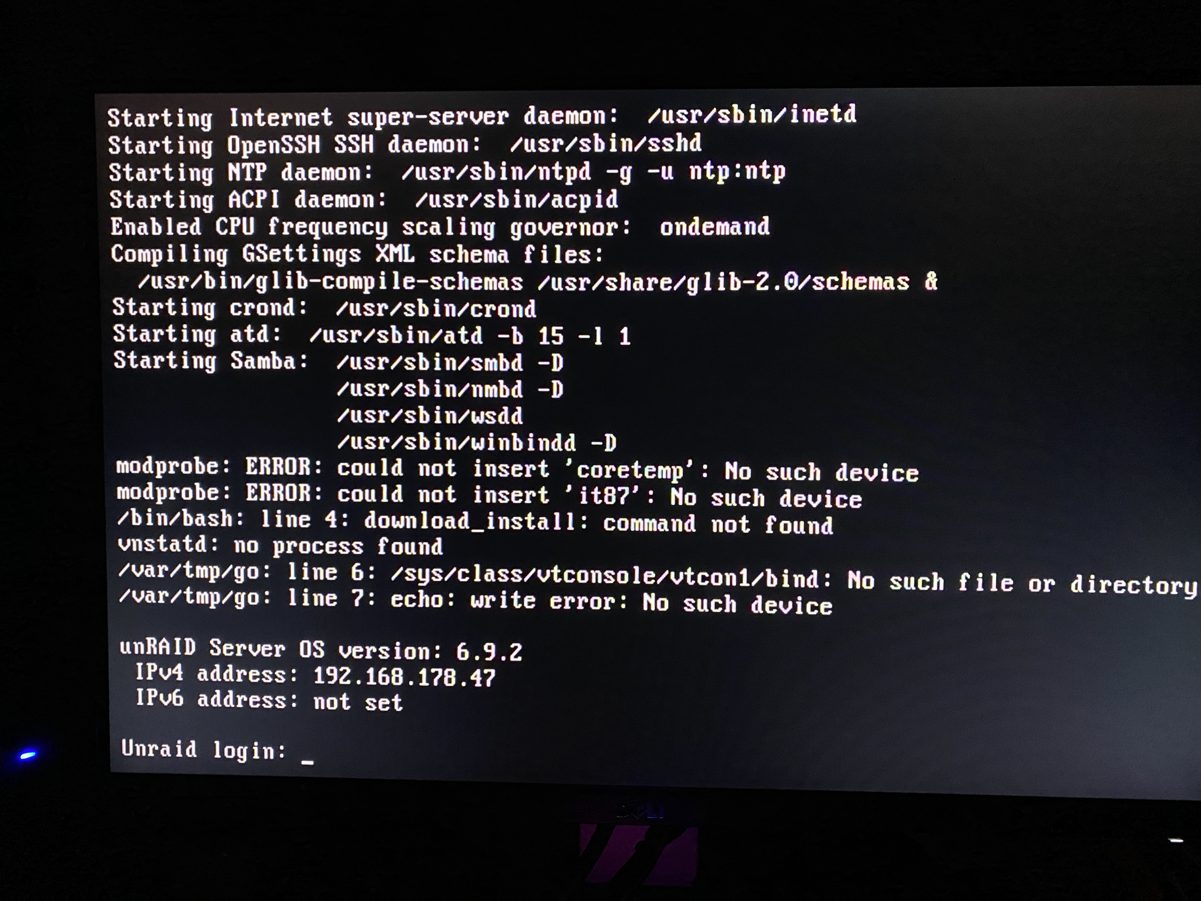

unraid suddenly stops working
I need help, please.

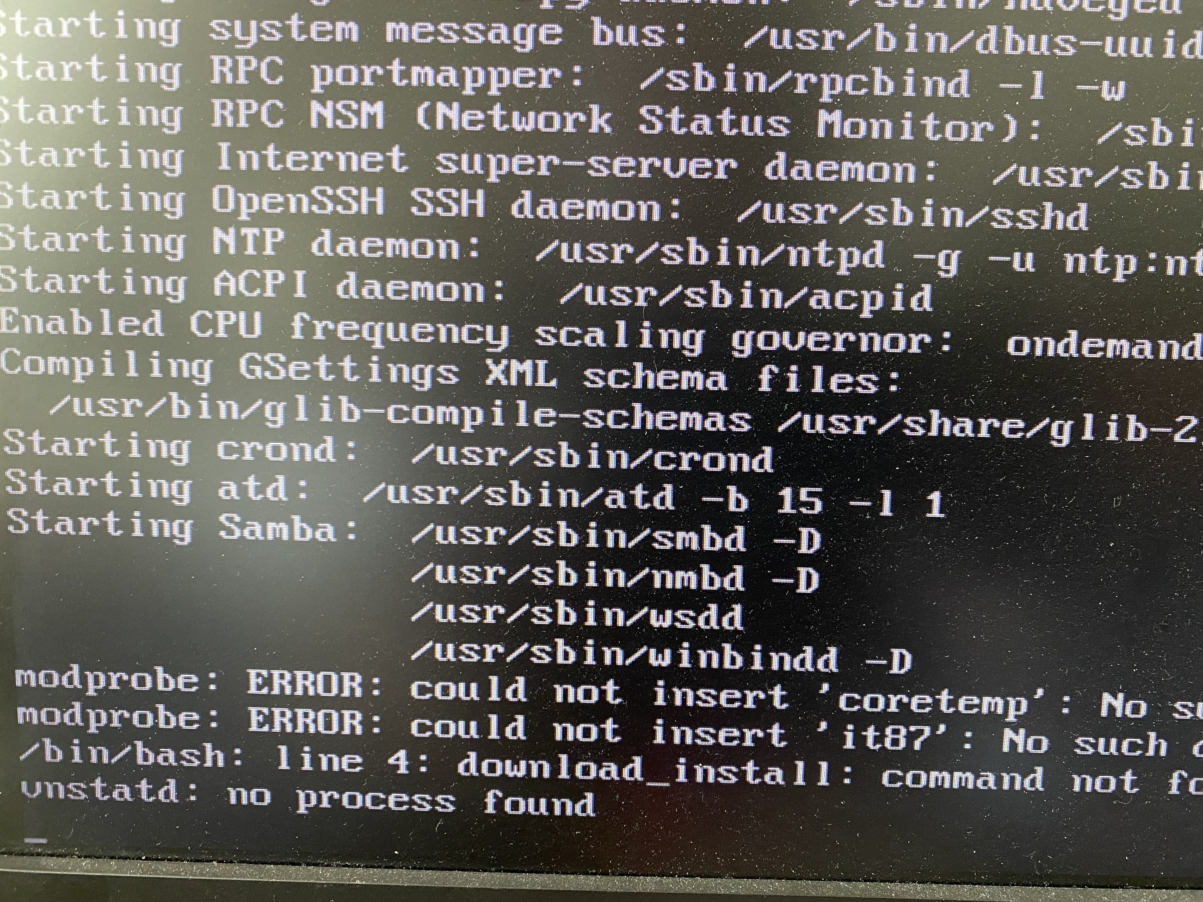

The startup process hangs at this point.
I have removed everything that is not necessary. Hard disks, expansion cards, USB cables.
How can I identify what is defective?
thanks for your help.

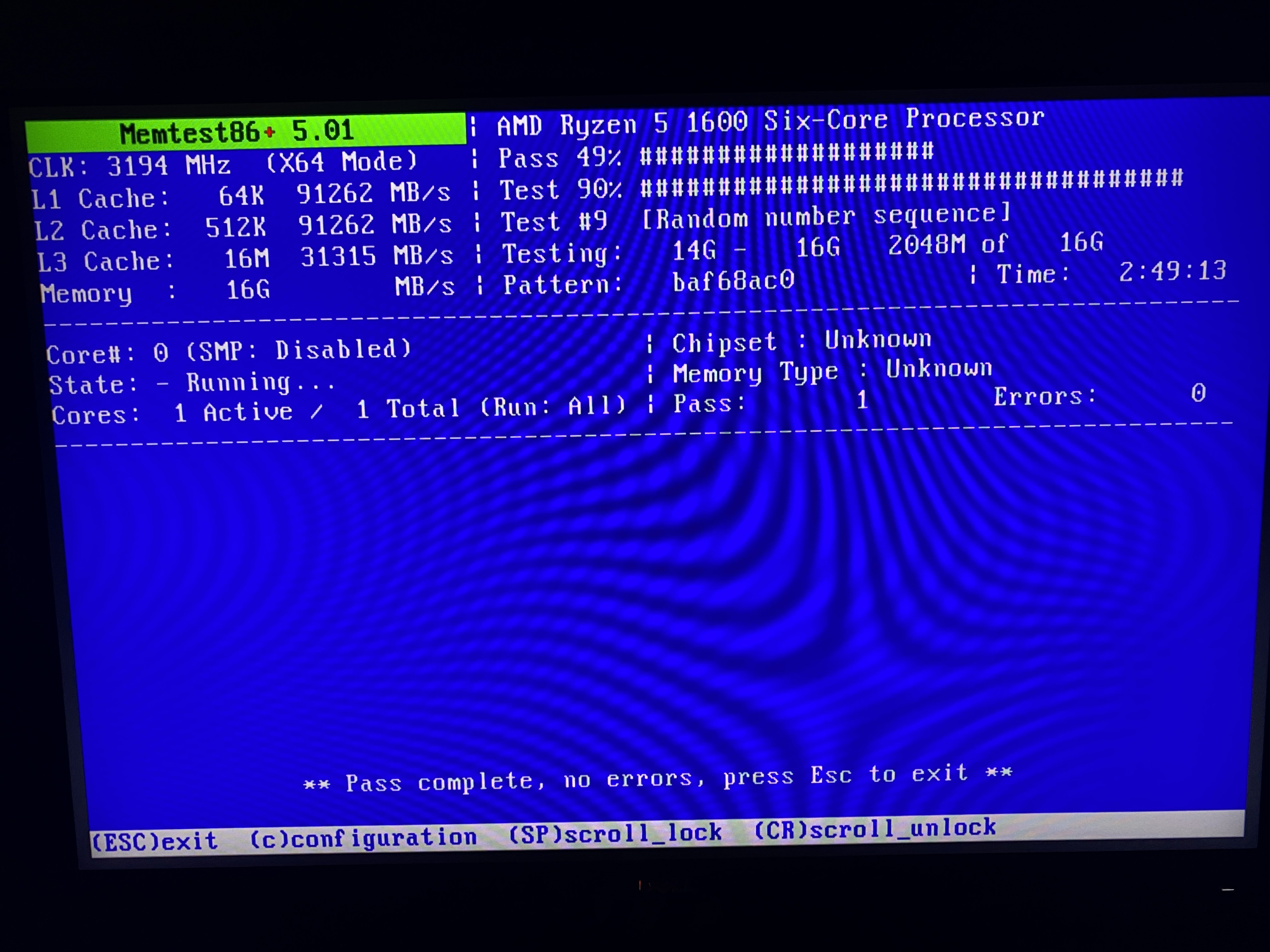

I have tried to run a memtest.
When I select the item in the boot menu, the server restarts.
Is this a hint?
Stick? RAM?
I have only one RAM bar in the system. But the last few days the PC was running normally. More RAM bars are on the way.

The memtest provided with Unraid will only work if booting in legacy mode.
if you want a version that will work when booting in UEFI mode then you can download one from memtest86.com
thank you very much for the hint.
So I was able to perform the memtest.
Without error.
Afterwards I restarted the computer for testing. Did not hang. I don't know.
Put everything back together.
Still runs. Should I test something to make sure it doesn't hang again soon?
