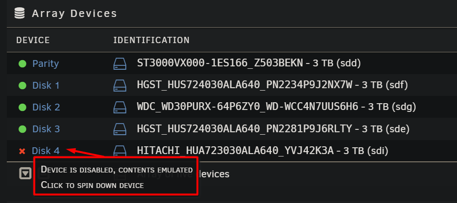

4. had trouble adding second HDD to array, something kept failing during rebuilds. Preclear also failed once or twice.
5. recently (48h ago or so) - the HDD from PCI SATA card that was already part of the array also has problems:
Attached are all the logs I could scrape, please teach me how to get more, if needed

Disk dropped offline, could be a connection/power problem, could also be a bad controller, replace/swap cables on that disks and if problems persist it's likely the controller.
thanks! already went through the cables (but they were also new).
you've confirmed my hunch, can't run 5$ Sata controller on Unraid and expect wonders.

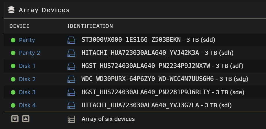

To bring proper closure - it was the controller.
Array is all purring happy now and with 2 parity drives it's in a much safer place now :D
