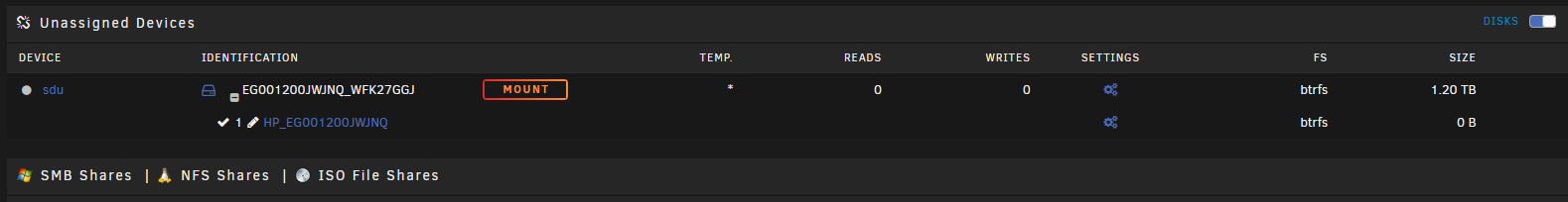

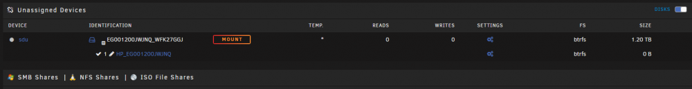

Is it mounted in Unassigned devices?
Hi @JonathanM
No, its not;
Which is why I find it odd that its not listed as available to put in a spare slot.
