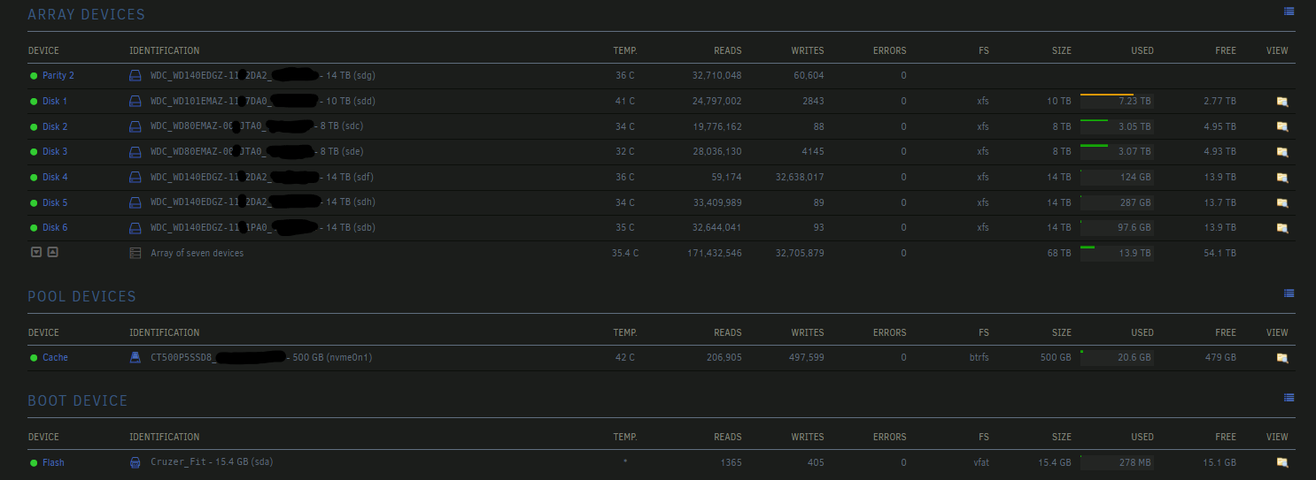

also i have a parity 2 and not 1, because i had an 8tb parity drive, that i 'replaced' with a 14tb parity, and since its just a single parity replacement it was just added as parity 2 and i dont think i can change it. should i?
here is a screenshot of the array for more clarity
