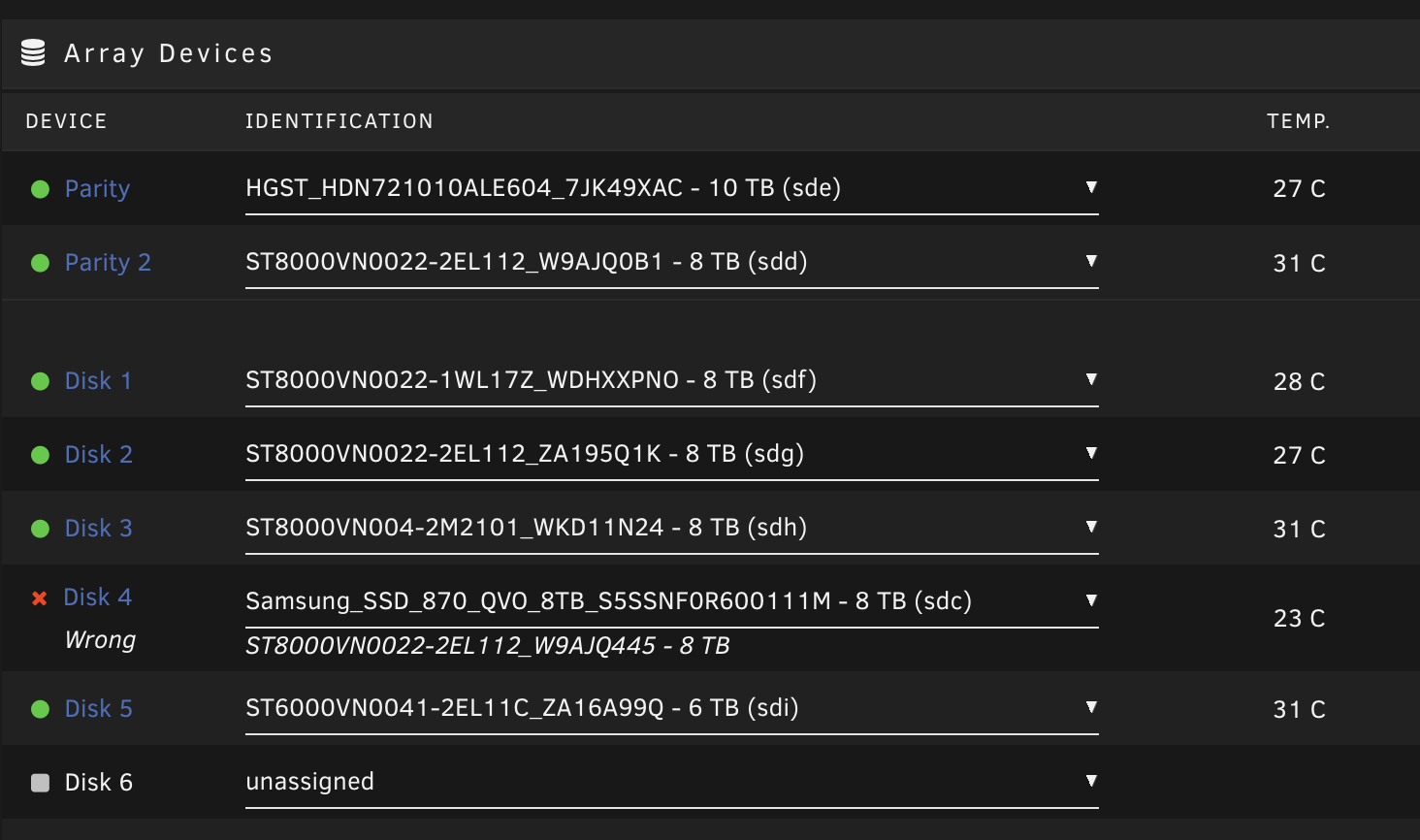

Hello !
I have Unraid server with 10 HDD 8 TB
I bought few SSD 8TB to replace theme but ....
When I follow the replacing process, when I have to select my SSD to replace sur HDD Unraid told me that it s impossible because the size must be bigger than the previous HDD ...
Is there any solution ? The HDD are not full at all
Thanks !!
Partition for SSDs start on sector 2048 vs sector 64 for disks, so if you use an SSD to replace a disk of the same capacity the partition will be a little smaller and there won't be enough space.
You can still do it but would have to do it manually, i.e., do a new config with the SSDs then copy the data from the disk(s) using for example UD to mount.

If I understood well:
- I stop the Array, I add the to array the new SSD
Now I have all the hard drive + new SSD
( In MAIN, I can't replace the HDD by the SSD because is smaller and Unraid don t allow me to do it ) It say ''WRONG" ( like on my picture above )
So I ll copy the file with unBALANCE then remove the HDD  :)
