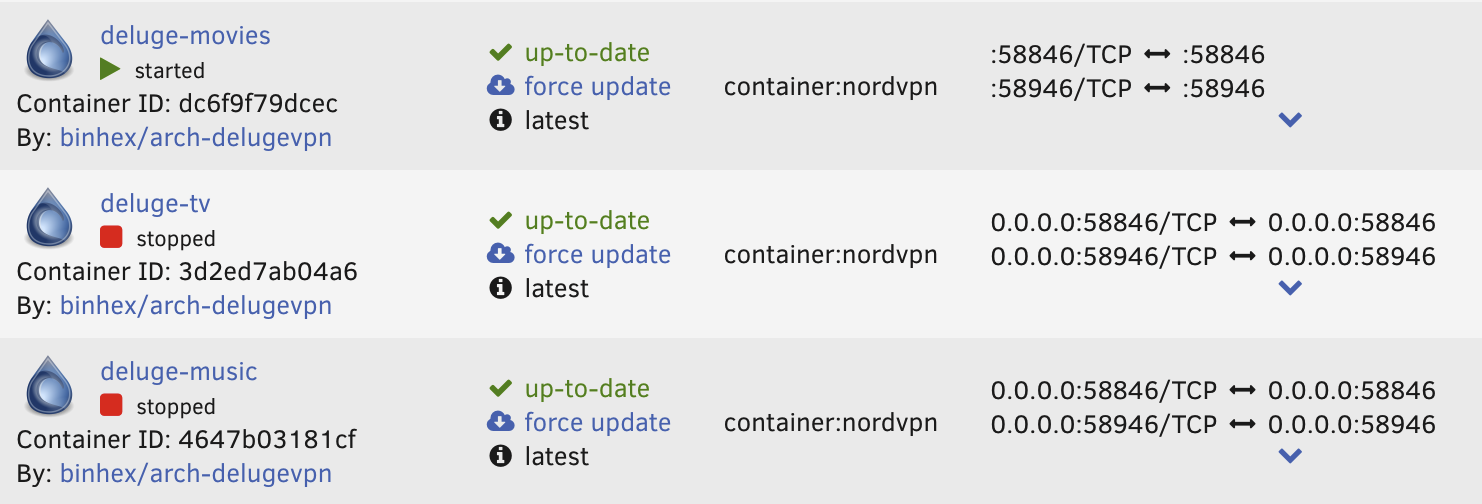

I have 3x separate containers of Deluge running and I'm trying to map them all through a NordVPN container.
467855136_CleanShot2022-03-23at16_51.53@2x.thumb.png.d2c94beadb55af49f0b386c6cb9c0d19.png
I can get the Deluge containers to work one at a time, but not all 3x at once because they're all trying to use the same ports.... I guess.
So if I try to access them locally (192.168.1.4:[port]) it doesn't work.
In the docker templates, I have them all as different ports 58846, 58847, 58849
But no matter how I try to define custom ports, these default ports are always defined.... somewhere.

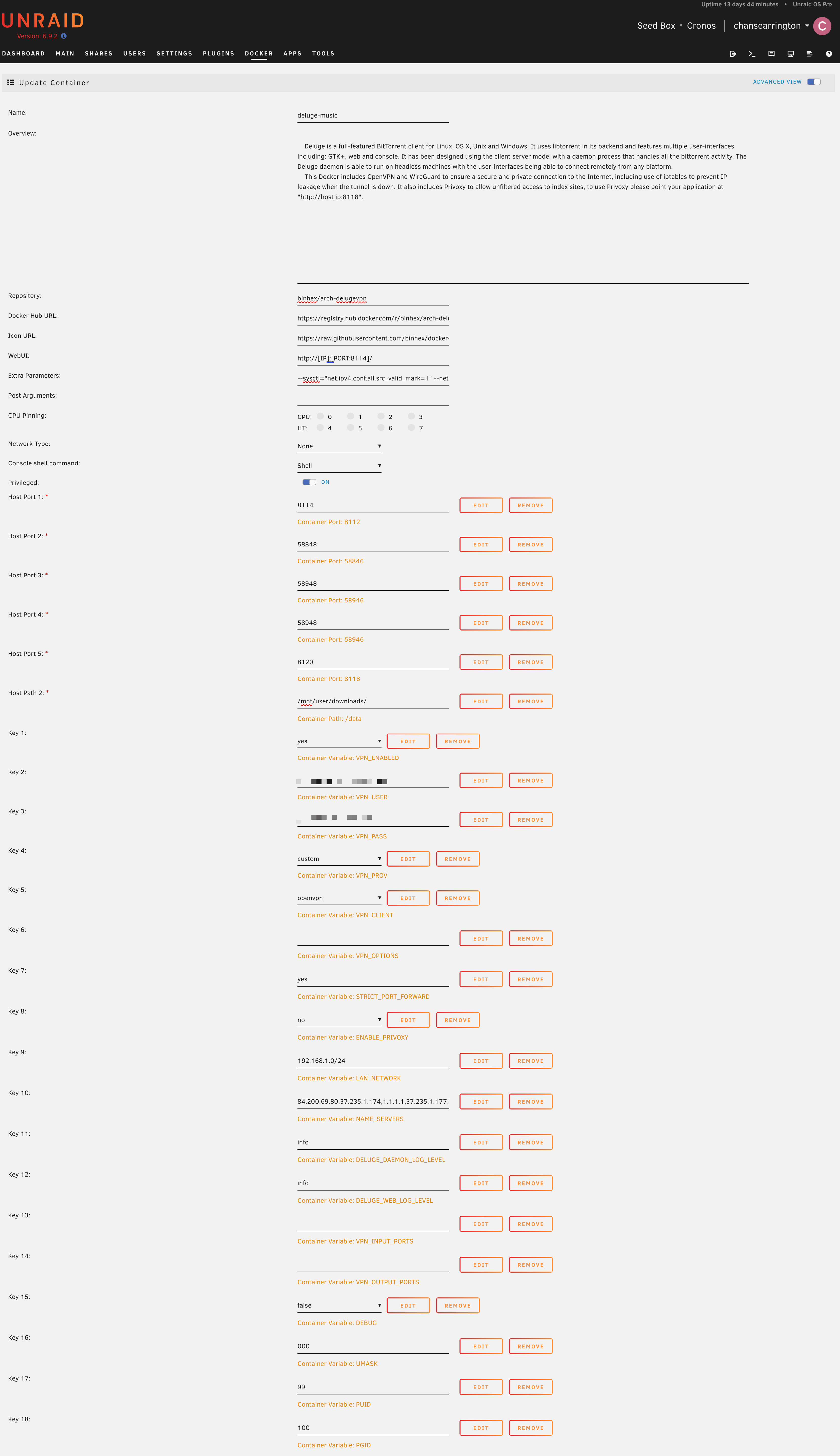

I've tried:
- Changing the ports in the deluge config template, they are ignored and set to the defaults
- Changing the ports in the deluge client settings, they are ignored, the defaults are still set in the container and it doesn't work
- Changing the ports in the deluge client config files, the defaults are still set in the container and it doesn't work
No matter what, these defaults are the only thing that works no matter how I try to configure it.

I don't set up any containers running through another for a VPN etc so I'm not going to be much help, but will say that if you're running the containers via another type of network other than bridge, all port mappings are ignored by definition.  So it won't work trying to map them to another port.

The ports are defined within the container itself.  Whether you can change them via a config file etc is entirely dependent upon the container.

Varies massively depending upon the app.  Within a config file, within the settings in the app's GUI, via an environment variable.  No one answer fits all here.
