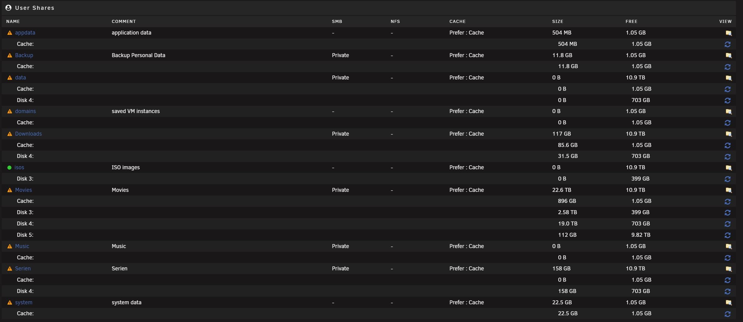

i have the problem that my mover is not working correctly, and i cant find out why this happens.
i have already tried a lot of solutions from others that had the same issues, but somehow nothing seems to work for my situation.
My cache is filled up with data and it seems that he is not moving them to the other disks as it should.
i tried to switch all shared to "Prefer: Cache" but not even this seems to do anything.
i attached my diagnosis file and also a screenshot of the shares.
i hope i can get some help from you guys because i'm pretty new to unriad.
Cheers
Prefer will pull data from the Array and put in on Cache. If you want your data on the Array, you should use Yes for those shares.
ohh noooo.... what a rookie mistake, i got it all wrong. sorry for that.
are there any shares that i shoul leave on prefer or anything else than "yes"?
Usually :
  • appdata
  • domains
  • system
You might want to check if your cache pool has a minimum free space set. Generally we suggest to set it to something larger than the larger file you expect to go through your cache.
The Array needs to be stopped to change the value.
