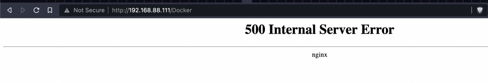

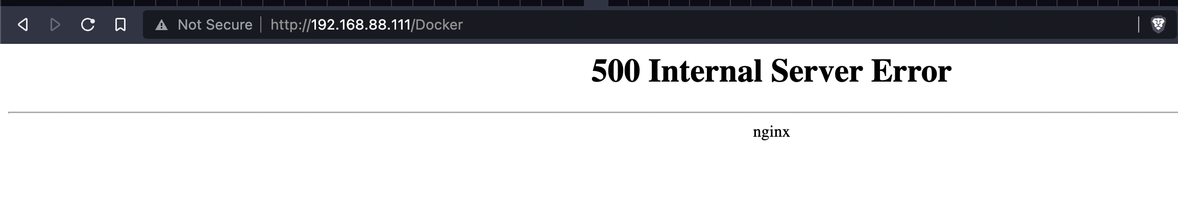

Good afternoon, this is the second time my server has stopped showing me the web panel, responding with "500 Internal Server Error". The ssh and samba access continues to work. Last time this happened three days ago. I am attaching the diagnostic files collected then and just now.
I can see it in the syslog, but I don't understand what kind of error it indicates.

Reboot what? The client device? Doesn't help, the error is the same on all devices.
Server? It helps. But I can't reboot it every three days, given that rebooting is taking it out of service for an hour or more (stopping all dockers and virtual machines when rebooting is very long for some reason).
