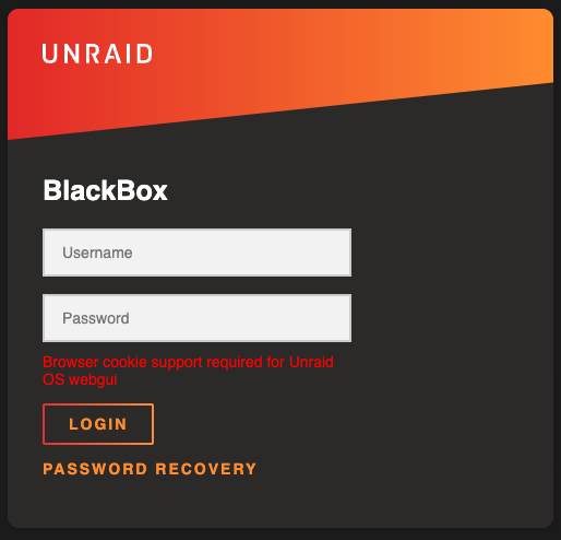

No that one doesn't work either. How are you creating this? The diagnostics is downloaded as a single zip file with no need to change it in any way.
Same here, can't open the file. Says that it is not an archive file.
I’m using wireguard on my iPhone to download the zip. I am not modifying it in anyway. I’ll be home soonish and I’ll upload it again.
Here’s a new one for now.
Edited by SavageAUS
it's an html, and it's content is the unraid login page ???
