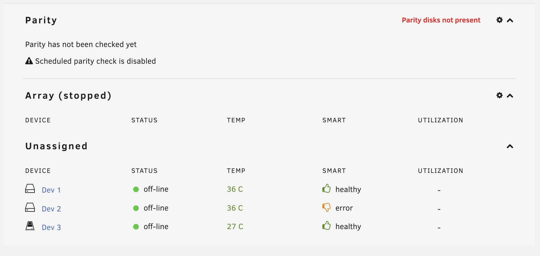

I'm currently running a pre-clear on my new hard drives and one of them has displayed this message a few times. Is it anything to worry about?
I'm using the Unassigned Device Preclear plugin as I watched a YouTube video that said to do this before putting anything on the drives to see if they're good.
Anyway, here's the error..
Unraid device dev2 SMART health [198]: 28-03-2022 19:57
Warning [MATTPLEX] - offline uncorrectable is 104
ST8000NE001-2M7101_WSD5F010 (dev2)
Under the Assigned Devices section on the dashboard it states there's an error.
Thanks
Matt

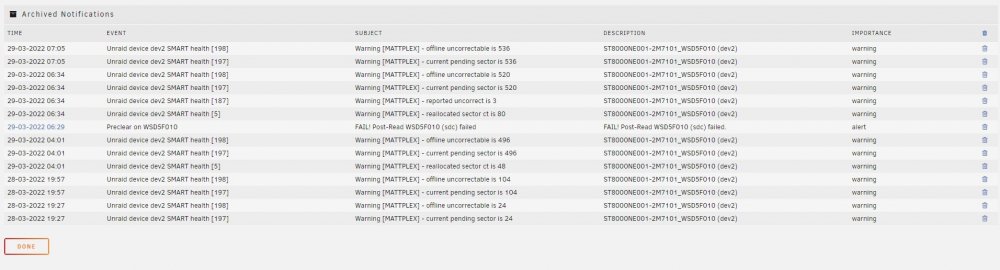

Both attributes are now 500+, if it were me, I would RMA the drive.
OK, I'll get onto the company I purchased it from.
Thanks for your help ChatNoir, I appreciate it :)
