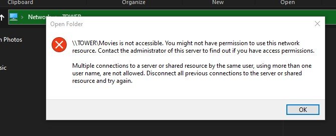

Cleared cred's as suggested. Created a new user. Set one share to private (w/ read write permission) another to public. No prob accessing public but any (user)credentials are not accepted.
This is the error msg I get when attempting to log in. I get it regardless of logging out of the GUI.

Thanks for all the input. I figured out what was happening. When mapping the share I misunderstood the que to select "use other credentials", these are the cred's set up as user in unraid.
Thanks again you helped me focus.
